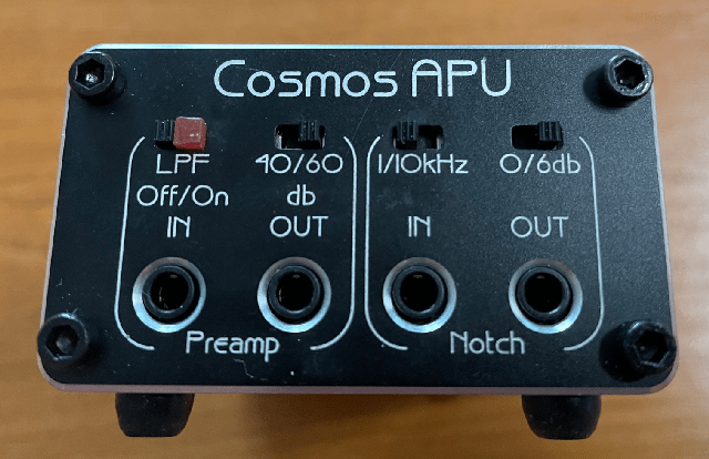

Hi IVX,
I have something else to ask you about my APU unit what I bought few weeks ago (via Linsoul). Just now I realised that my faceplate is different than on the web - switch for phantom power is labelled "LPF" and gain is "40/60 dB" (should be 34/60 dB).
What we can do with that...
Martin
Martin

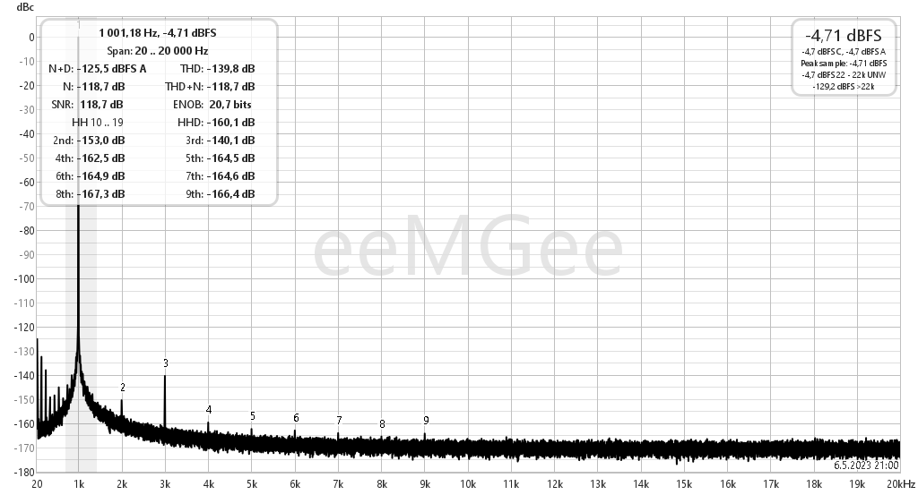

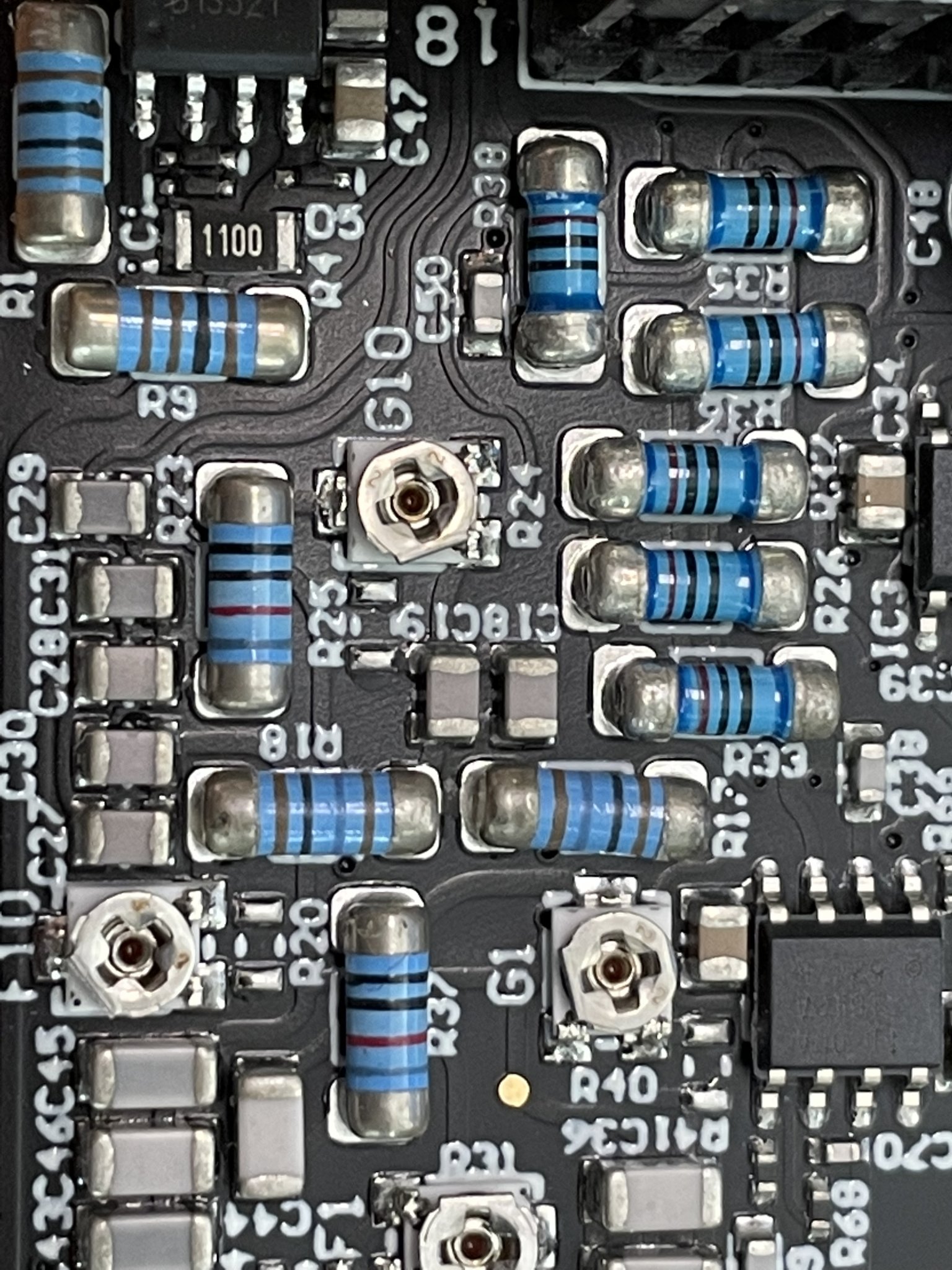

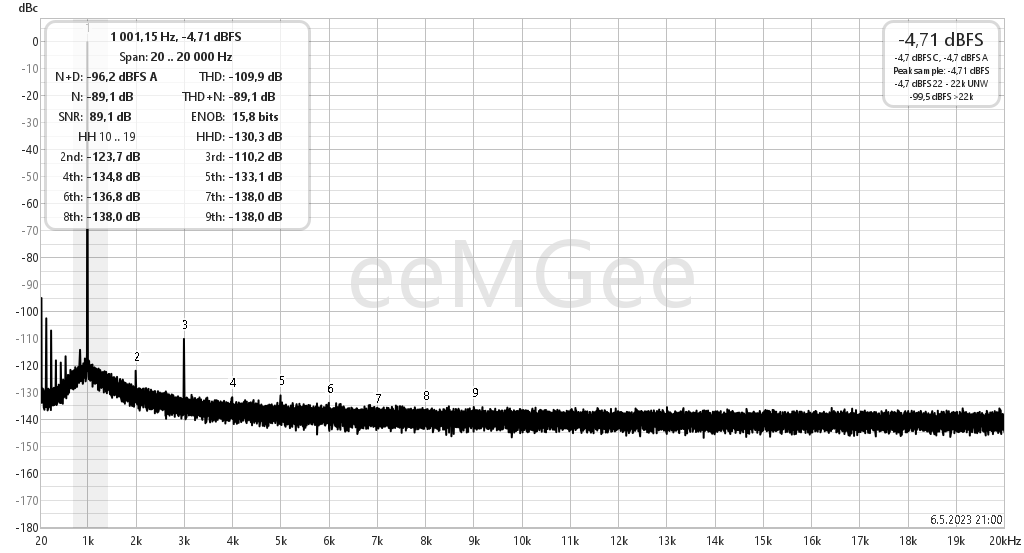

Hi IVX,
after my new APU panel installation I had some time to test my APU unit with Victor oscillator but I have got results what are not expected - the H3 is too high.
My setup is: Vic osc balanced 5,5 Vrms > Cosmos APU (1kHz notch 0dB) > Cosmos ADC
H3 has to be around -120 dB without SW compensation and -150 dB with. With my APU unit H3 is 10 dB higher!
It seems that my APU unit is made with fake MELF 0207 resistors what you have been wrighting about here:
https://www.diyaudio.com/community/...perform-apx555b-for-30000.386001/post-7020664
Thank you for your answer,
Martin
