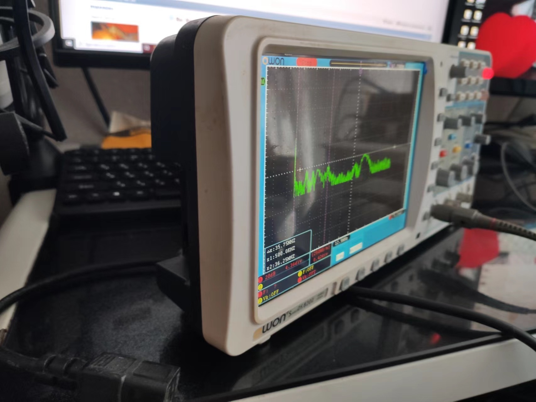

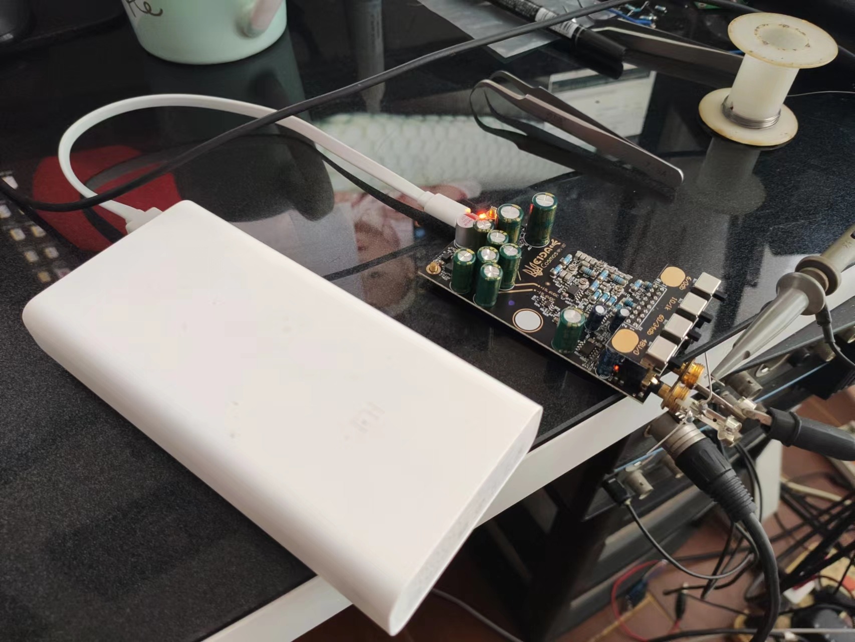

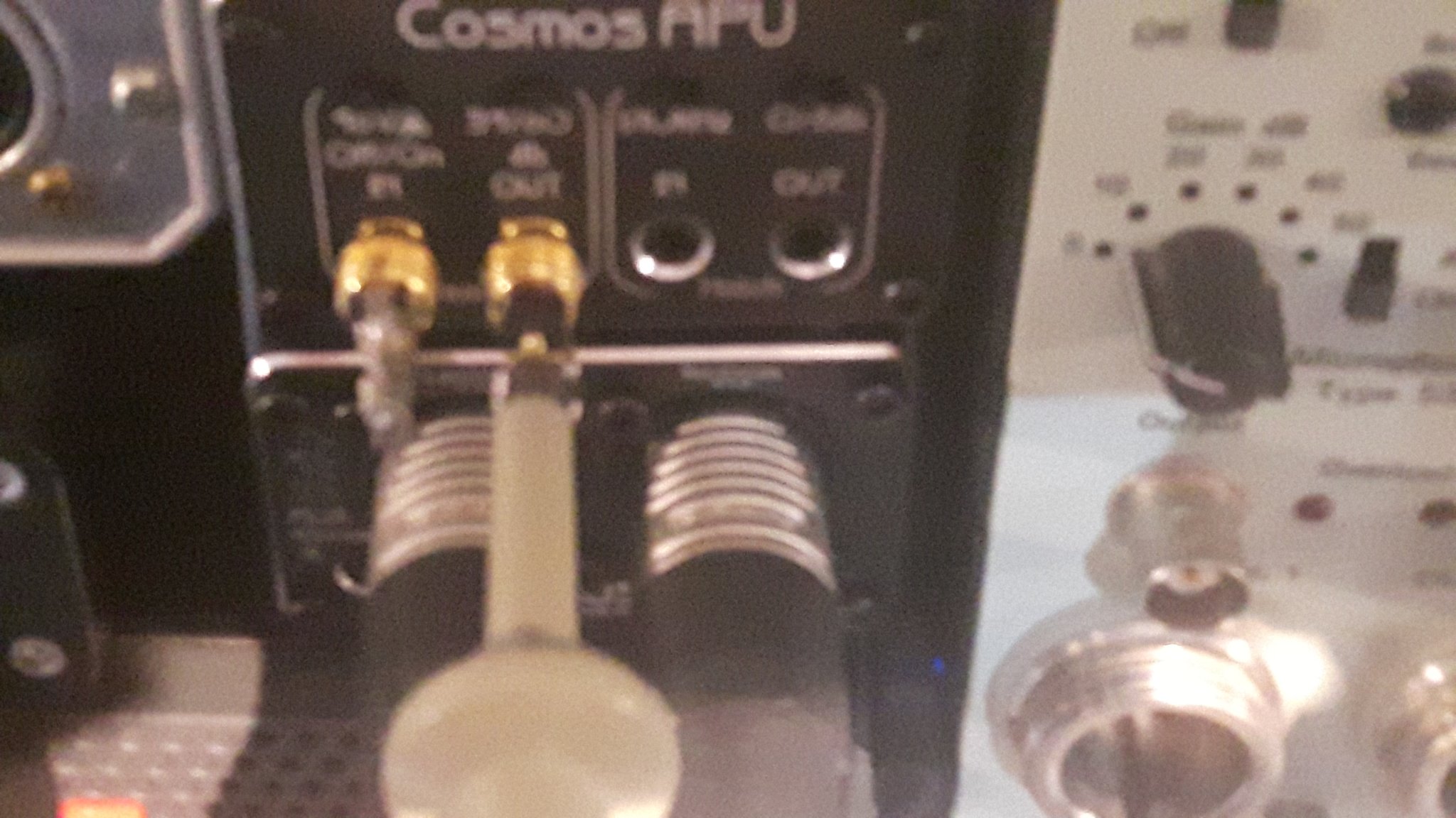

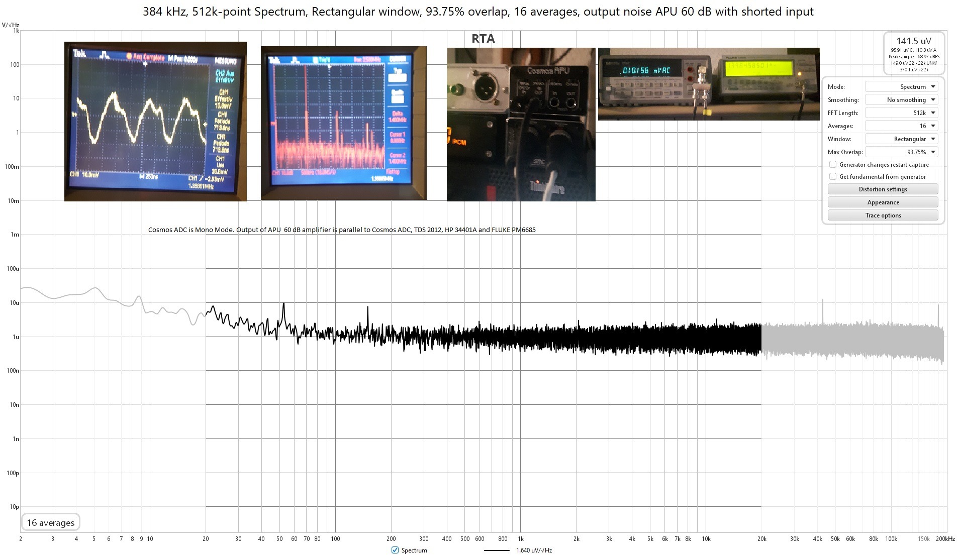

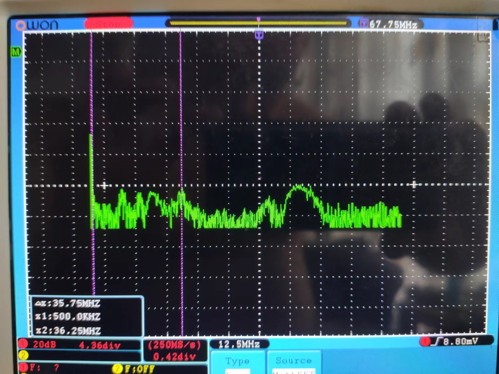

However, l have another problem with the APU 60 dB amplifier section. When l short the imput, l can measre 34 mV RMS output with a frequency of approx 1.39 MHz. Do other users measure the same?
Fortunately, it is very easy to test on my side, I used powerbank powered APU PCBA, and battery-powered scope to minimize common-mode disturbances.
I see the highest peak at 84MHz(-82dbfs, where is 0dbfs = 100mV), next at 36MHz -84dbfs or so, and the lowest one at 12MHz. 1.3MHz area is clean.
I tried to read the noise just from the GND pin of 3.5mm plug and the result was pretty much the same, hence, I see the common-mode noise.
IVX, APU is powerd by Battery pack. TEK P6106A passive probe directly connected to TRS connector to avoid any ground loop or antenna. So l am sure its coming from APU. Nothing else than the scope is is connected to the APU. Sorry for bad quality of the images, l cant focus better.
I can't see clearly but looks like 60mV-peak? How much it changes if set 34db of gain? Did you check the actual gain is close to 34 and 60db(to make sure if THAT 1510 inputs, or protection resistors/zener arent burned)?
Also, try to short the 3.5mm plug input+ to the input- but don't short them to the GND pin, is the 1.3MHz noise the same?
Ok. Did you check the actual gain is close to 34 and 60db(to make sure if THAT 1510 inputs, or protection resistors/zener arent burned)?
The gain is 33.6 dB and 59.3 dB, Shorting input + and input - no change of the noise. l will open the APU later. Thanks for your support
