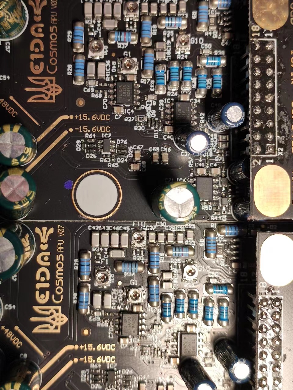

This is not a fake Viking but another supplier of precision resistors NYS RJM75P0207 https://www.diyaudio.com/community/...perform-apx555b-for-30000.386001/post-7027277
I did buy that from the factory, and all APU use the RJM75P0207 in these positions(diff amp, if your notch gain is 0db there are just 4pcs of the same resistors in action i.e. that circuit isn't sensitive to the resistor nonlinearity due to mutual compensation. +6db position may affect the H3 performance and recommended for THD+N tests). I did individual testing of H2 and H3 performance for the first 70+ units, after I found the performance is consistent(-150-160db, mostly -150-155db), I stopped testing that parameters.
Your result(H3 -121db) was nearly 10x times worse than matulo_g -140db, and the source was your DAC, not Victor's OSC, hence, this is not the same case at least. H3 -120db in the diff amp with 4x680ohm is okay with 0402 thick-film Yageo.Last month I reported the same issue (high H3) about my Cosmos APU to IVX in PM. Mine also has MELF207 resistors that are not according IVX's post. Although I doubt the issue is with the resistors.

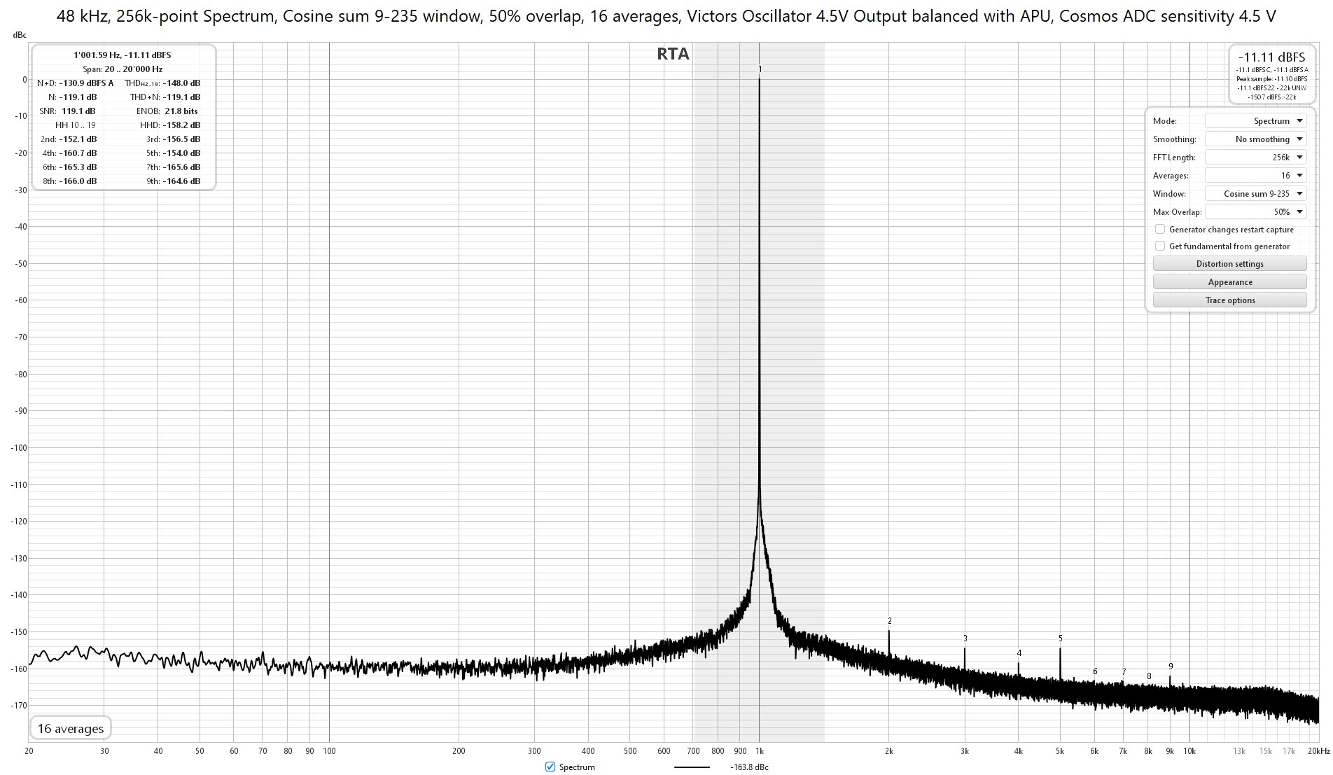

PS: I tried the publicly published circuit of Victor's OSC(unbalanced one), and found that 2.5-2.8Vrms has a noticeably higher H3 vs < = 2Vrms.
Probably the current version isn't similar to what I tried but perhaps there is an invertor to get a negative output to be balanced, in other words, I recommend trying 2+2=4Vrms balanced output to see if H3 will be -150db or lower.

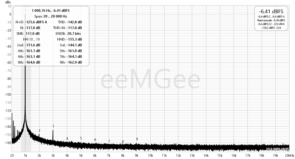

Without APU my DAC measured H3 -138dB. So is nearly 10x times worse (17dB) to be expected with APU?Your result(H3 -121db) was nearly 10x times worse than matulo_g -140db, and the source was your DAC, not Victor's OSC, hence, this is not the same case at least. H3 -120db in the diff amp with 4x680ohm is okay with 0402 thick-film Yageo.

If so could you please show me REW FFT for 5.5V, 5V and 4.5V after APU? I did test 70+ APUs with 5Vrms input sine @ notch gain 0db.

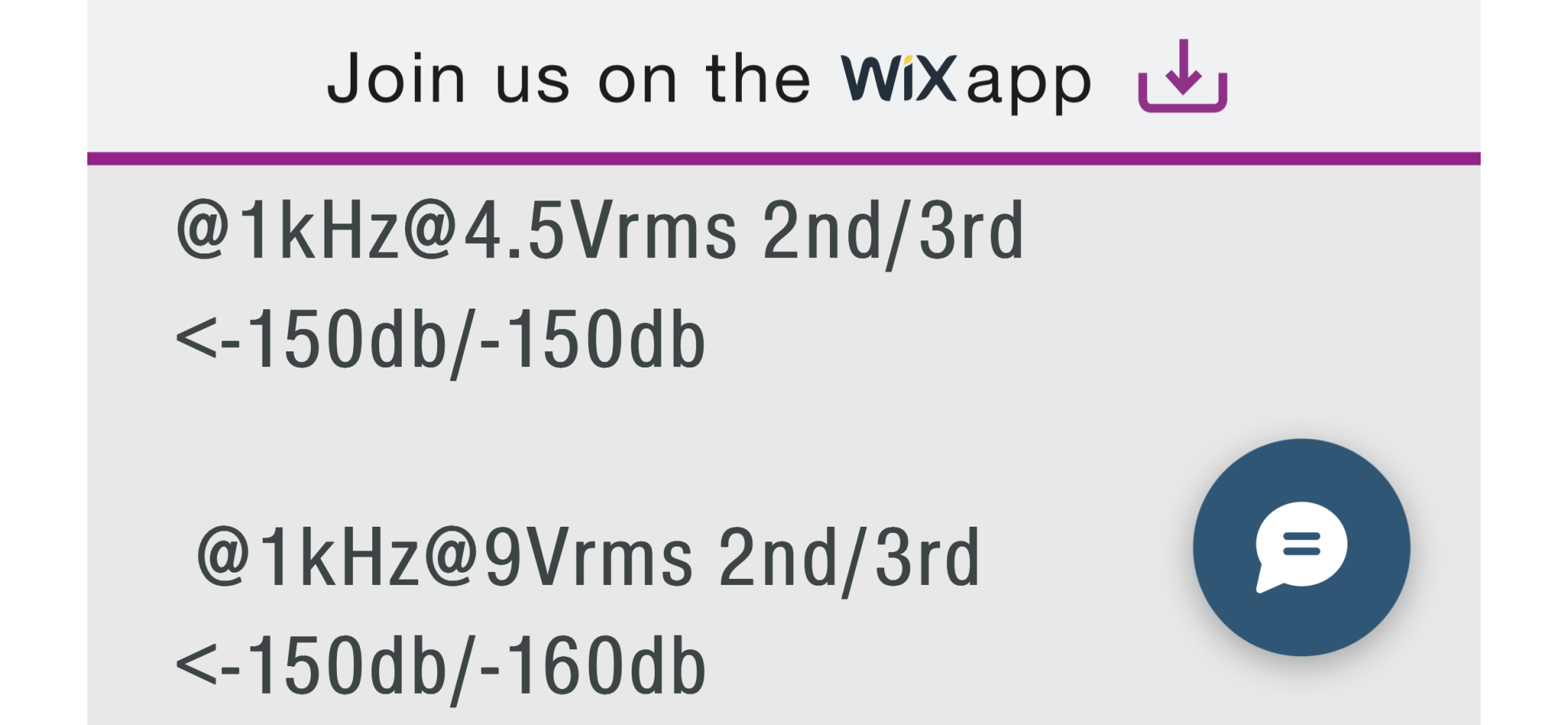

Did you get increased H3 on the first day you got the APU or that happened later? If later, I tend to suspect some input opamp IC3 OPA1612 needs to be replaced. As I see, the H2 isn't too high so I believe the input diodes-clamps(OVP) are fine. Just in case pls measure the input 0603 10ohm resistors nearly to IC3. I do not suspect passive parts at all because they are 100-250V(MLCC) and very long resistors with practically zero VCR. If you got the H3 increased right the first day, I could suspect the output opamp IC1 RT6863S only because it is Chinese and in theory, it may be not so reliable as Ti's opamps. I use that opamp due to its input stage symmetry, which let APU see the H2 at -150-160db. You can replace that for OPA1612 and get H2 -140-150db, but H3 for sure will be -150-160db. I tried to find from 5 pcs OPA1612 the best symmetrical one and got H2 -155db. Literally, each OPA2156 gives H3 -160db or so but very bad input symmetry makes H2 -135-140db. All db referred to 1kHz test. Pls let me know what you'll find finally, I should know that to improve the production quality. Any opamps etc I'll send you if needed(but probably take that from the mouser-digikey is 10x faster way).

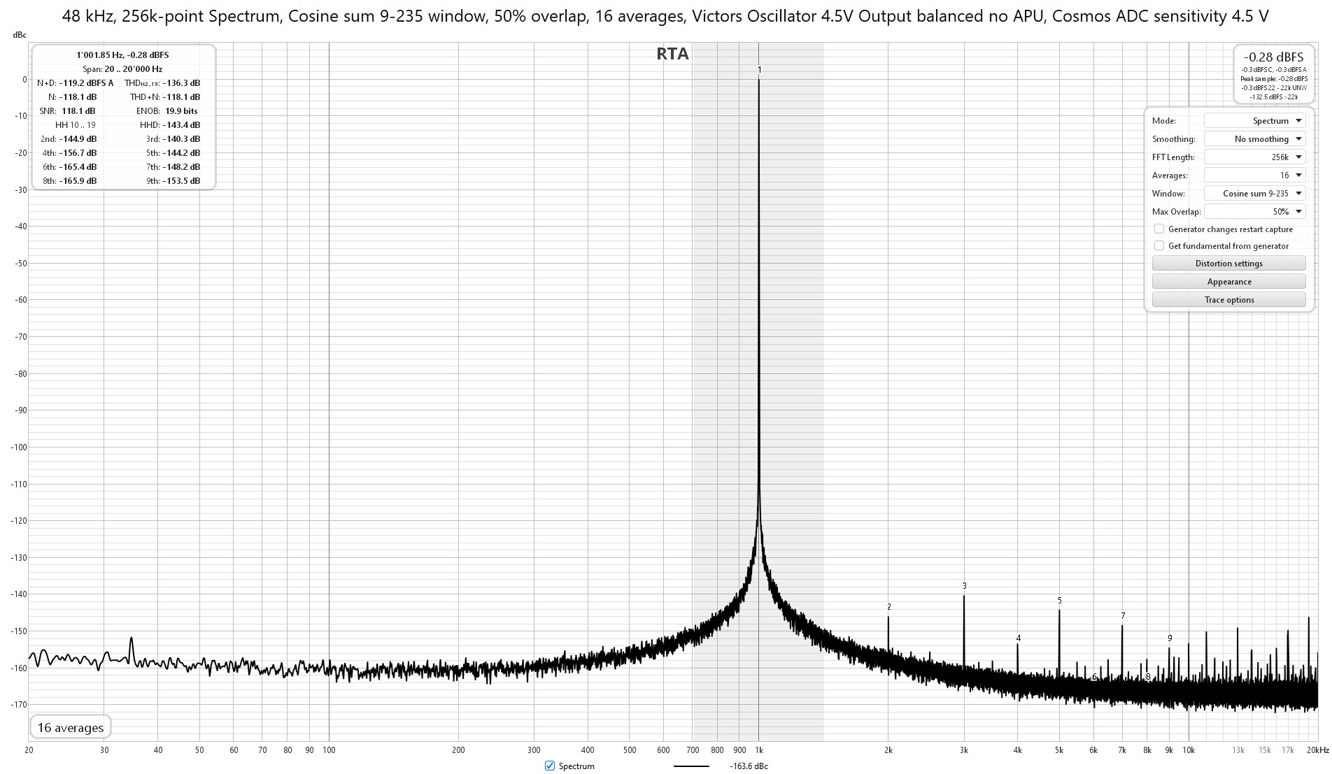

Well, it depends on how did you make sure your real H3 is -138db?Without APU my DAC measured H3 -138dB. So is nearly 10x times worse (17dB) to be expected with APU?

if -138db is real APU should give -138+/-2db as well. Of course, if H3 levels DUT vs APU match let's say at -150db, and the phase of both H2 magically match as well, then we may expect -144db as a result.

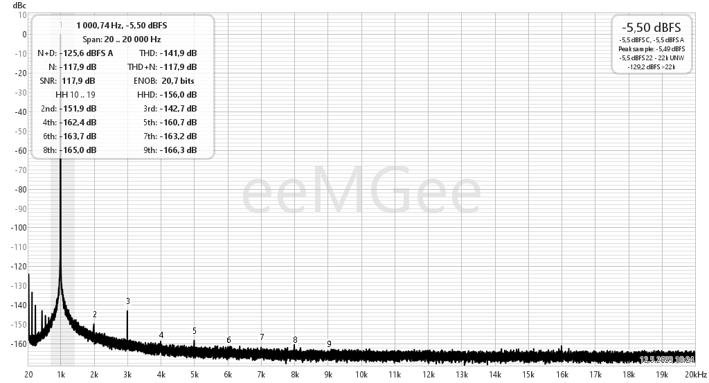

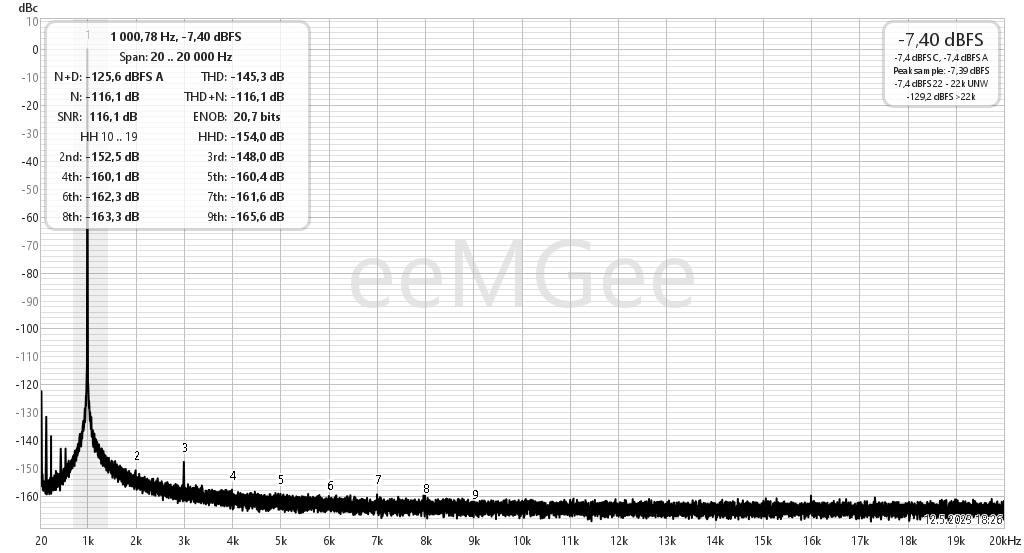

For 5,5 Vrms REW FFT is in my post #277 here:matulo_g, I see, so when you reduce the output level of the OSC your passive notch shows the same -160db of H3?
https://www.diyaudio.com/community/...perform-apx555b-for-30000.386001/post-7344669

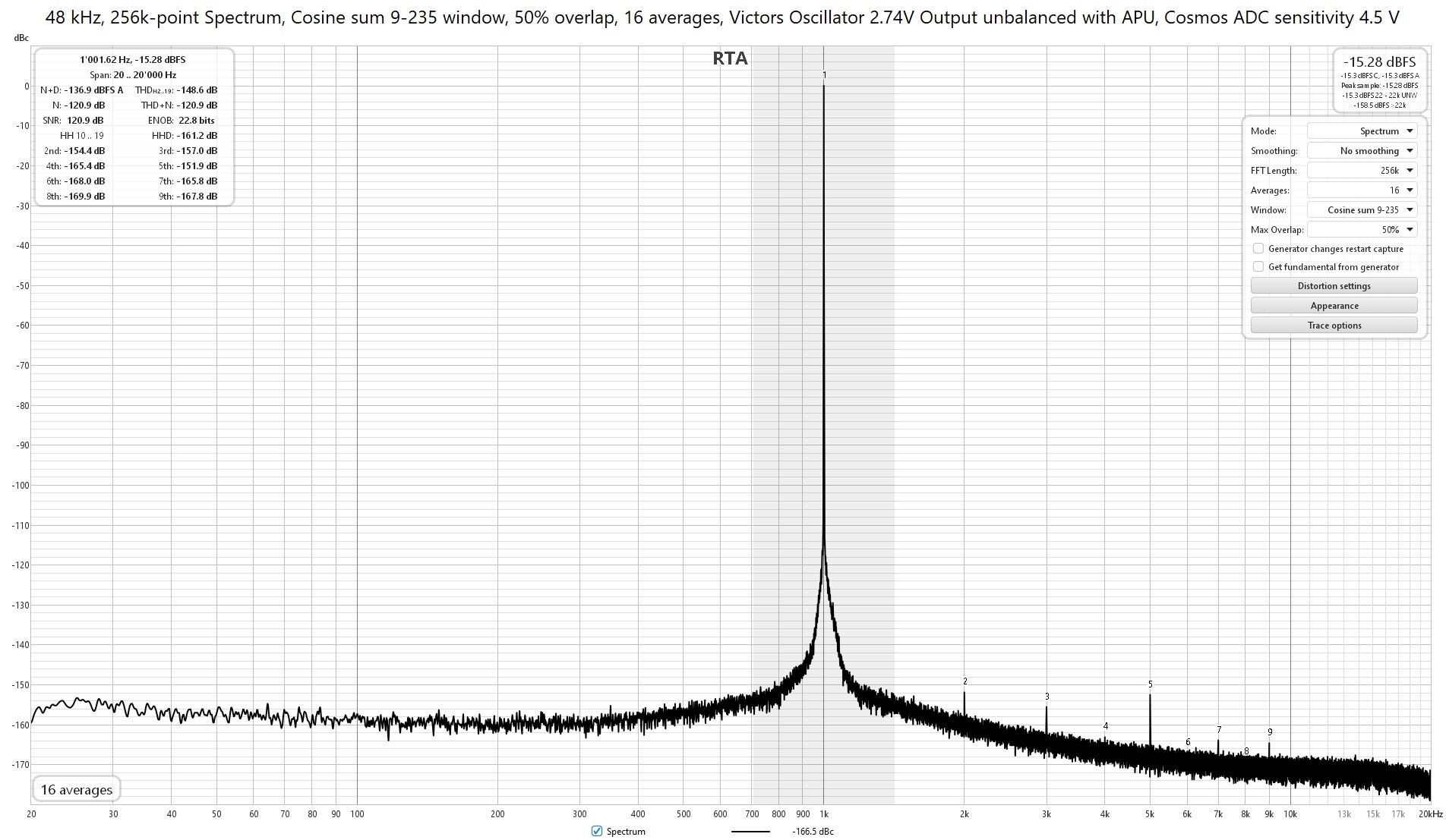

For lower values I can try it later this weekend, but for more than 4,5 Vrms H3 is starting to rise more than declared on your web. For the lower values noise of the osc/passive notch is dominating.

Yes, 0 dB gain - with 5,5 Vrms and +6 dB gain APU clips (heavy distortion due to the overdriving).
I don't see any unusual behavior here. The higher the level, the more the op amp comes out of its class A region.
@matulo_g IVX shows the data he measured with his DAC and low pass filter and not with Victors oscillator, so you cant compare his measurements with your measurements.
We dont know your measurements of your victors oscillator without APU, so its unknown if your harmonics are coming from your oscillator or from your APU
We dont know too your FFT and sampling rate data.

Here are some measuring results from my Victors oscillator and APU
I can see interferences lower 1 kHz. Is it a power supply problem or a shielding problem?
