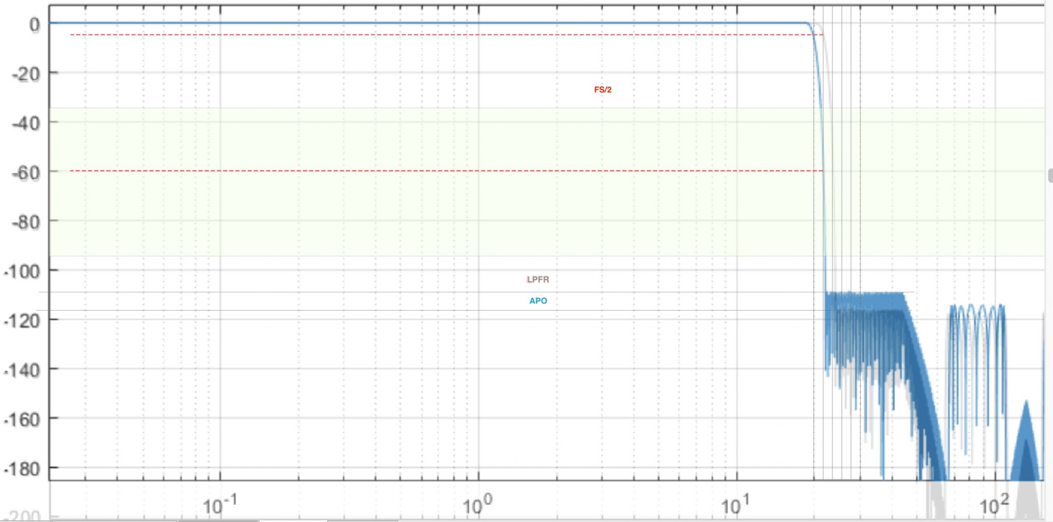

I did some scrutiny of the filter plots... here its looks like that the Lin Phase FRO breaks the fs/2 theorem rule already at say -5 dB but the APO stays below down to say - 60 dB... but not so hirez pdf so...
I will use the APO for the time being.... It was set as default if I remember correctly.

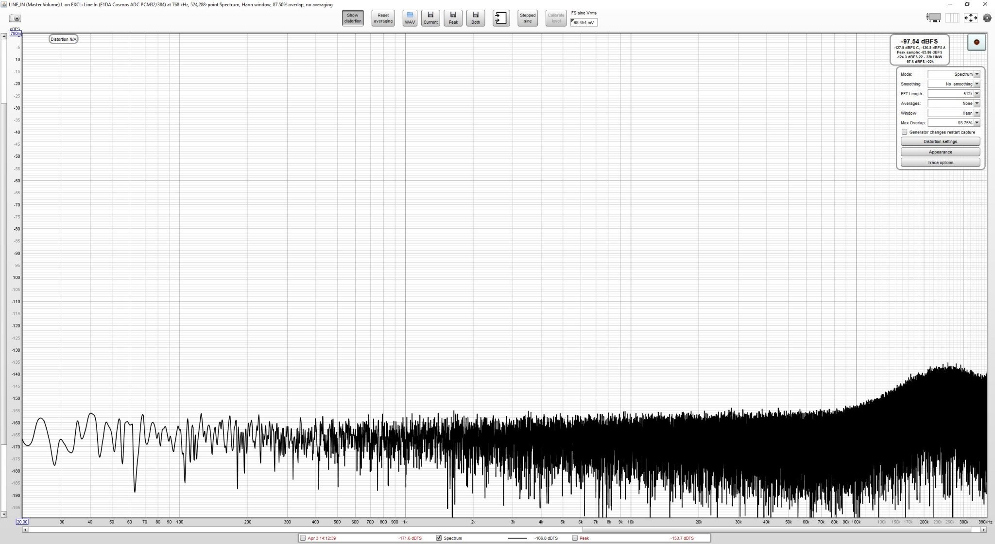

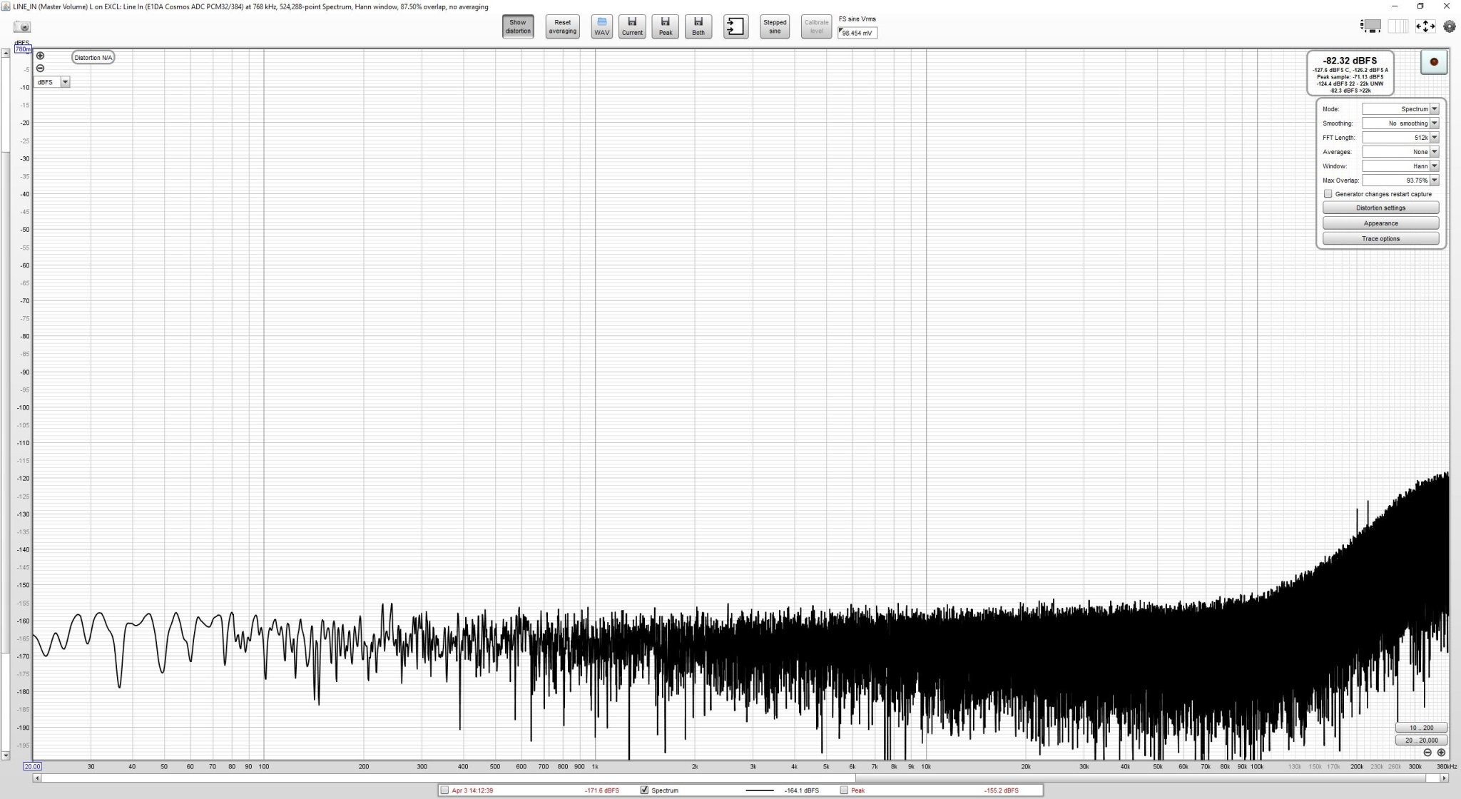

the out-of-band noise hump is reduced, just by the way.
I think you guys remember that hump if used 384k of sampling rate, it starts from 100k and higher so that hump is reduced. Furthermore, 10-20k H3 is also dropped to 3db or so. A-weighted noise may be .1db improved, so the new FW is about out-of-band noise mostly.
Some users report 1db(A) less noise with the new FW, I tested two samples one had .1db(A) and another one .5db(A) of the improvement. In other words, the new FW may lift the grade of your ADC to the next level(if the improvement is .5-1db that's for sure) 😱
