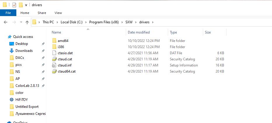

Manual way seem to require .inf files but these are not available in the download you pointed to as this is an .exe file...
When I unrar that file I only see: SXW_setup_WHQL_20210429-1.exe
Is there a way to see whats inside a .exe?
As I remember, the .exe anyway will create the folder I mentioned. The only thing you need to allow is permission to install that without a digital signature(the Comtrue driver isn't signed).When I unrar that file I only see: SXW_setup_WHQL_20210429-1.exe
Thanks - I now managed to see the .inf files etc 🙂Try viewing/extracting the exe file with 7zip or other archiver sw.
I did press F8 at startup and choose the option to disable signed driver check.
Still, att end of ISP tool installation where it asks you to plug in the ADC, it just repeats "Plug in the ADC"....
Doing cancel still also ends with Succeded/Installed.

OK - not only needed I to install with signing deactivate - of course also when after restart, I need to run the computer again with sign check off.
Now I can see a green field and Device 6012 exists.
Update succeeded 🙂

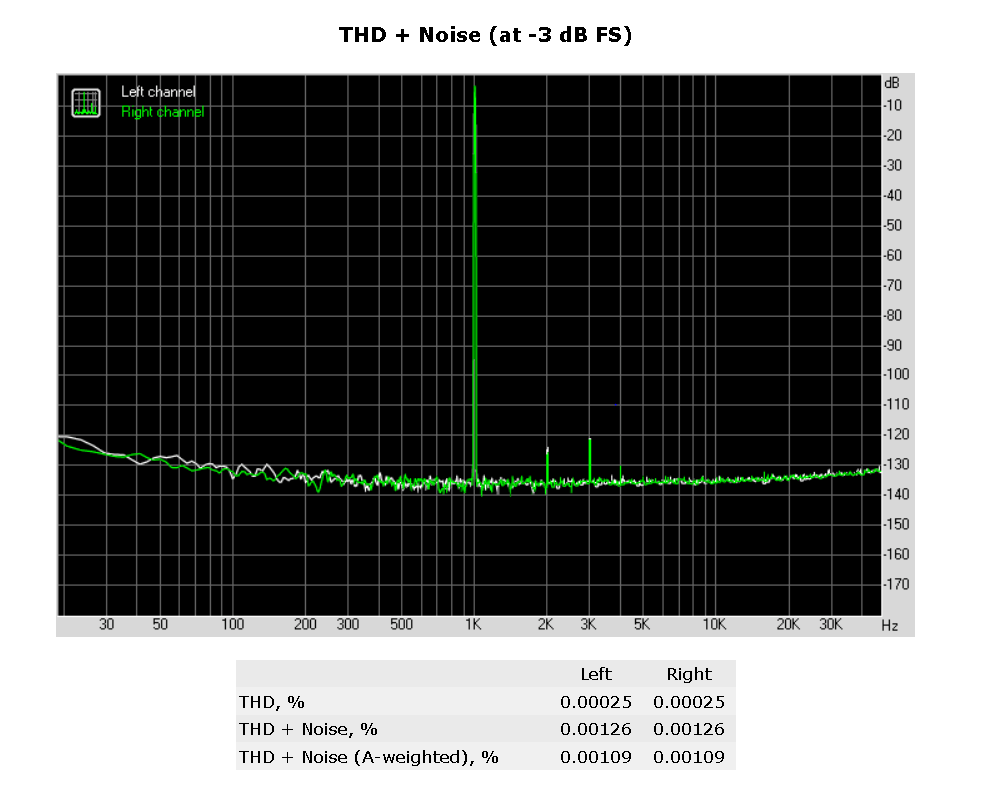

Hi, I have a question about using Cosmos APU with Asus Xonar U7 MKII. Were measurements taken? Cosmos APU for ADC Asus Xonar U7 MKII will be just as good?
Well, Cosmos APU Notch will improve your Asus harmonics resolution for 30db, in the case of Cosmos ADC, with typical H2<-140db and H3<-135db, has resolution <<-160db(if the particular APU also would have <<-160db, usually -150-160db). I have in my drawer such Asus but quite heavily modified with H2&H3 -125db, hence such ADC will not be a bottleneck for the APU with H2&H3 -150db, and you'll see exactly the same results as with Cosmos ADC. If your Asus has H2&H3 about -110db(I don't remember how bad is original ADC, just guessing), then you can't see distortions <-140db and so on. If you asking about the noise performance, there is no problem with any ADC, including the internal audio input of your laptop, all of them will show the same result of SNR or DR due to Cosmos APU LNA having a gain of up to +60db. I can't give you the exact link but you can find it in the ASR forum I posted the result of my laptop+APU combo, and it was better than my AP SYS2522 at least.Hi, I have a question about using Cosmos APU with Asus Xonar U7 MKII. Were measurements taken? Cosmos APU for ADC Asus Xonar U7 MKII will be just as good?
PS: I want to mention one more option, especially if you got Cosmos APU as an uncalibrated PCBA. You can try to adjust the notch ratio higher than -30db, probably -35-40db is ok but it depends on the particular APU unit.
My ASUS Xonar U7 is also slightly upgraded (other op amps, keys removed), but the noise level prevails. Next will be replacing cs5361 with cs5381.
Does it make sense to buy Cosmos APU? I'm more interested in general SINAD.
