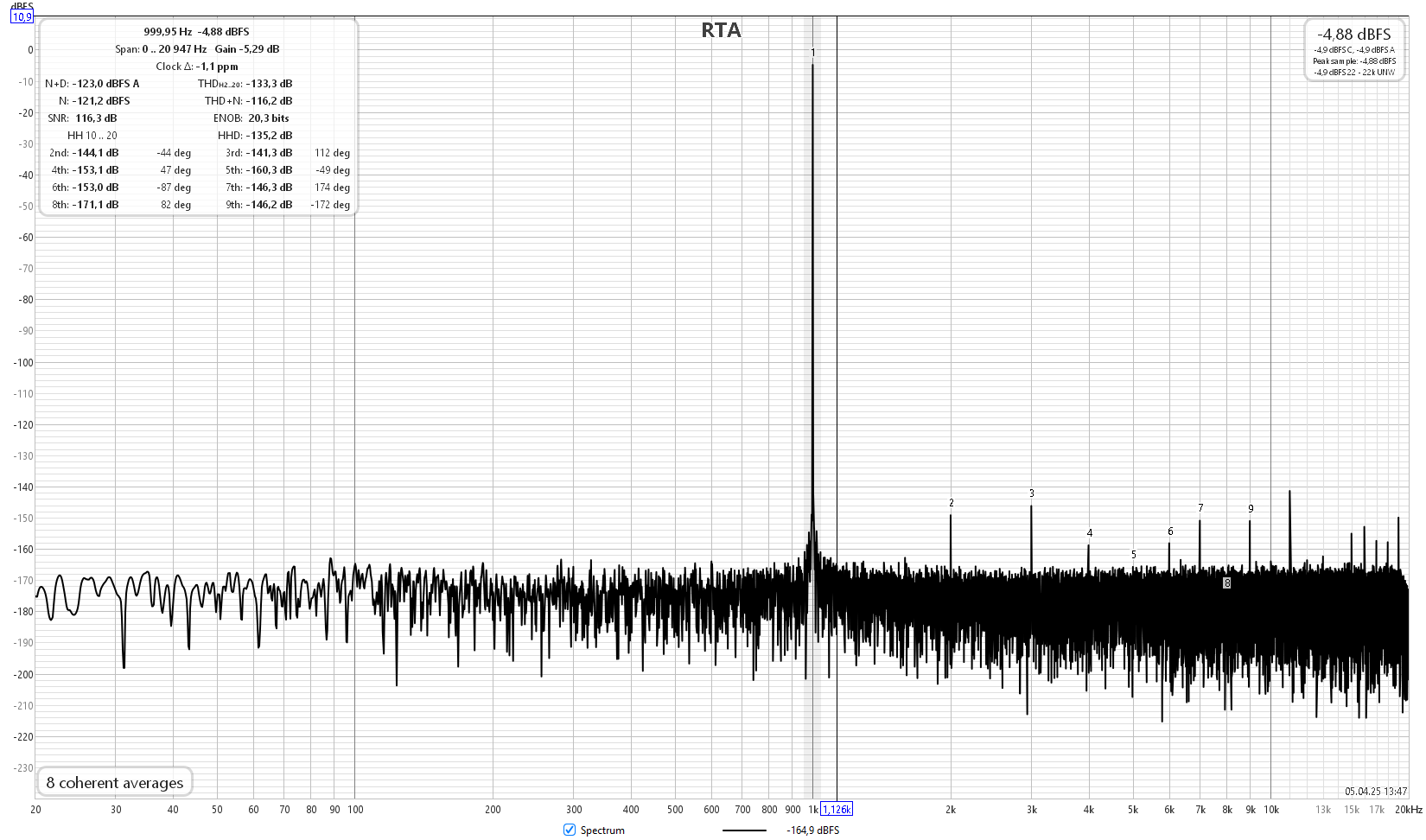

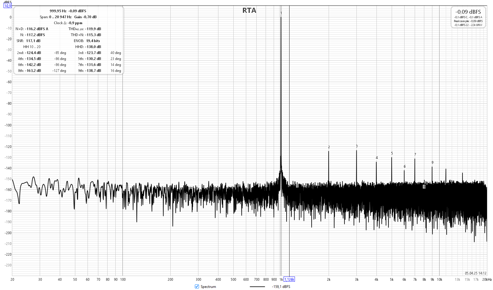

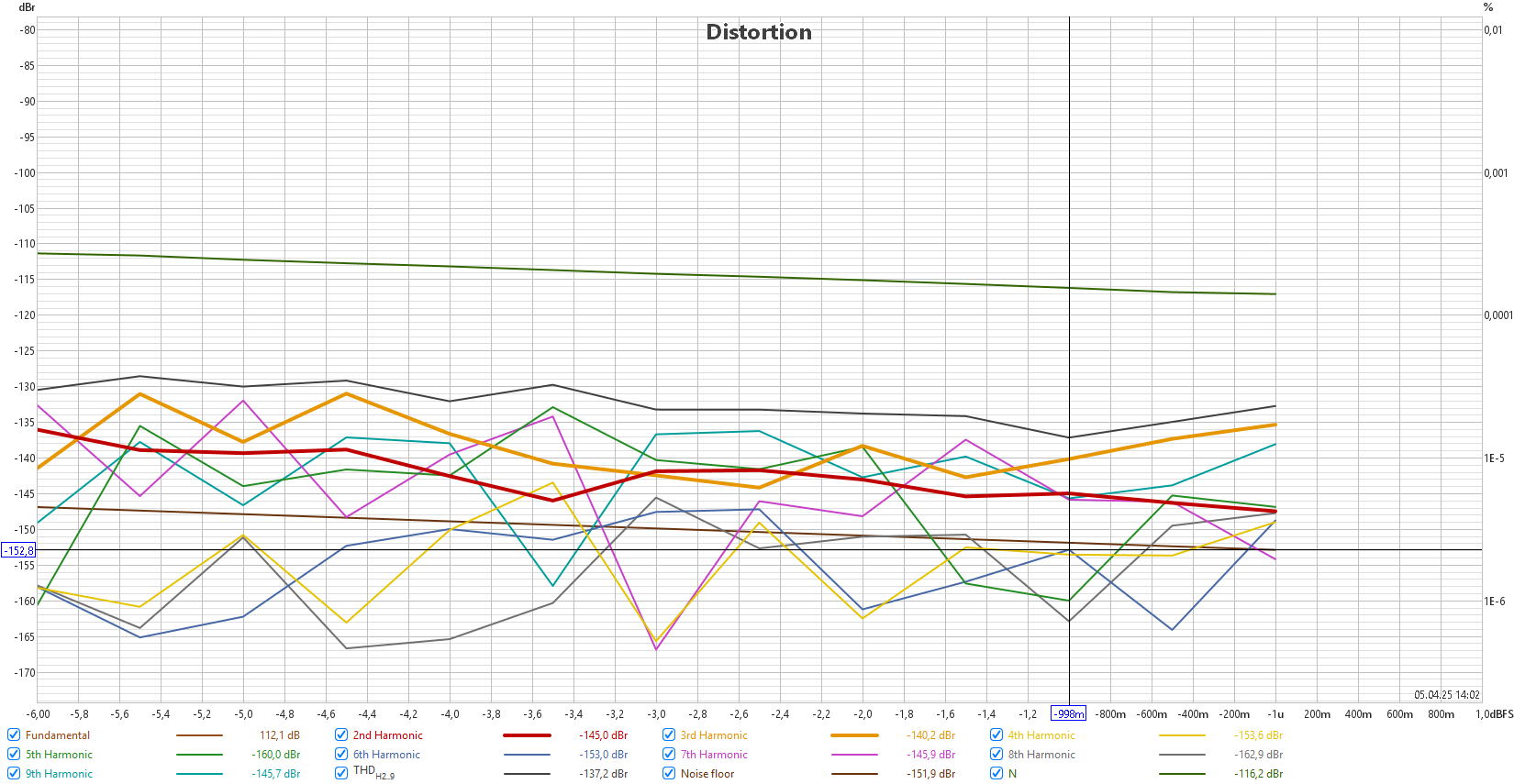

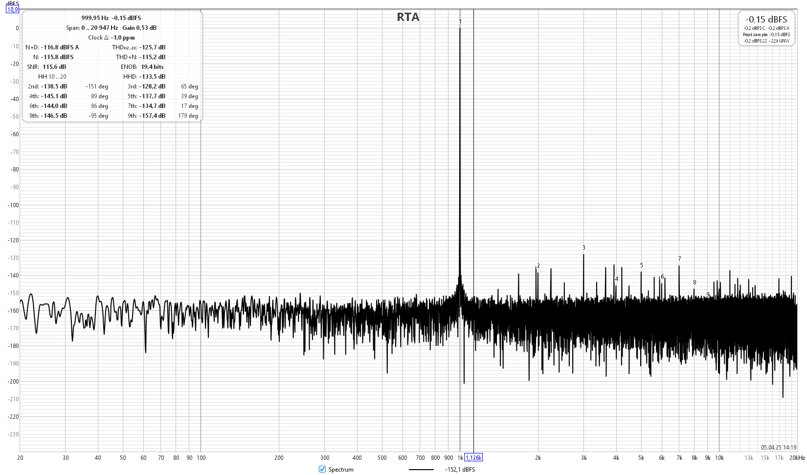

But interesting to use a SMSL SU-9 Pro XLR and ADCiso
Same output
ADC values.

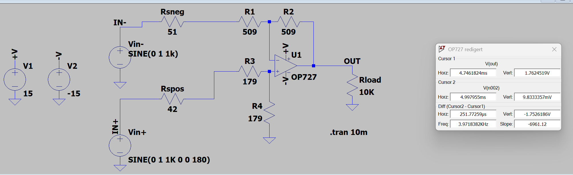

Since the resistance of the legs are different but precission, I wonder if the Unbal circuit can be used to measure the source resistance
I am optimistic, but a lot of variables so plenty room for error.
1 volt in with no source gives 2 volts out
Opening and closing sw 9 and 10 measure gains.
And then scaling to new 2 volts out vith Rs and find possible values.

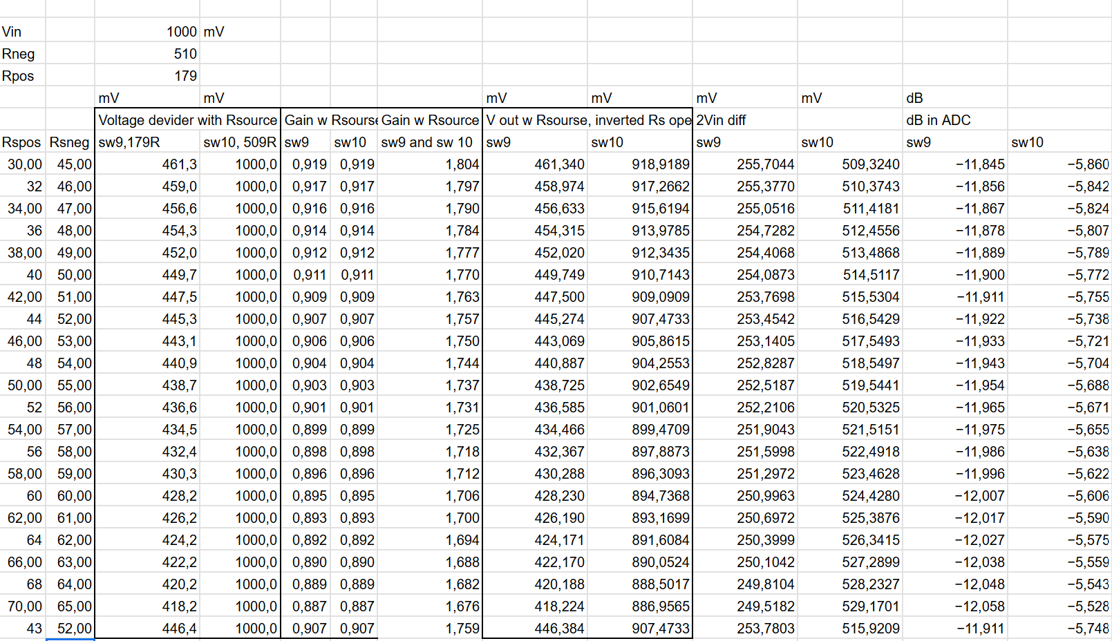

This is LTspice file and the Google sheet.
Problem solver in Google sheet can not solve with two inputs so I had to search for the right values myself.
Start with ballgame numbers and iterate.
The total source resistance is split two values so two values needed as input.
There are three gains that are changing by changing the two source resistances.
- Gain with sw 9 and 10 open
- Gain with sw 9 open
- Gain with sw 8 open
- Find value for sw 9 and 10 open
- Find value for sw 9 open. The vaulue for 'dB in ADC sw 9' is the difference to 1.
- Find value for sw 10 open. The vaulue for 'dB in ADC sw 9' is the difference to 1.
- Search for the values in 2. and 3 by changing Rspos and Rsneg. When the values are found. That is the Rsourse resistances.
