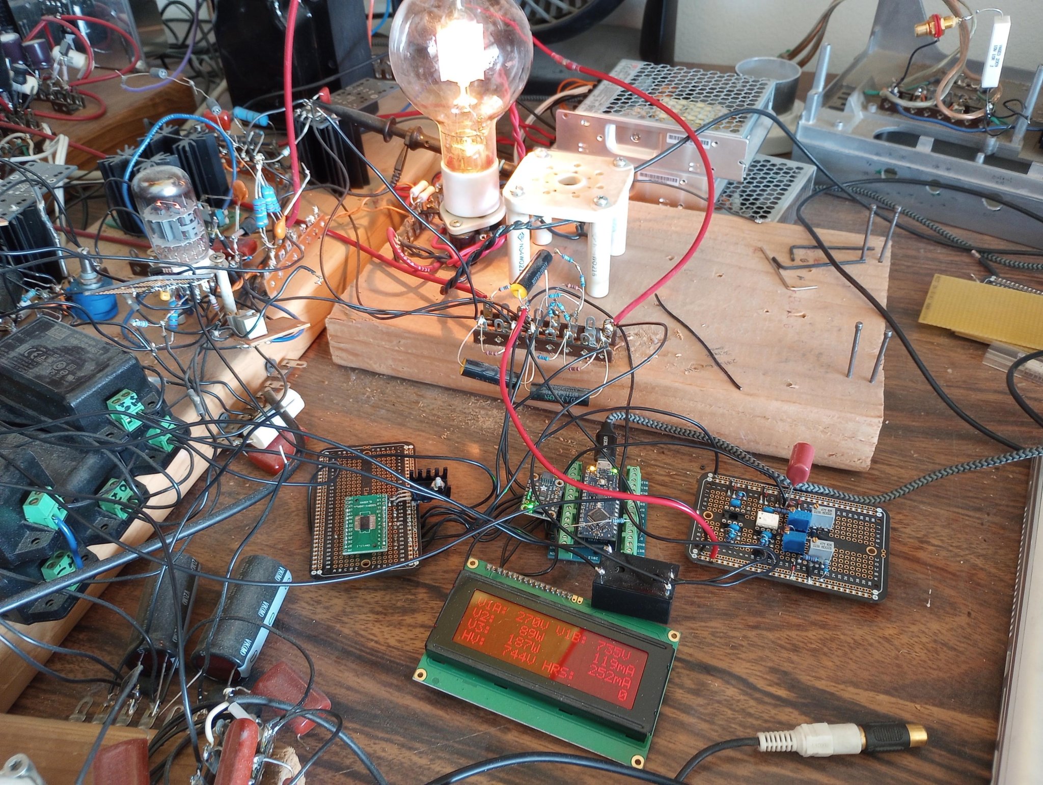

Ok, here's the promised update on the Arduino bias/monitor system:
I've got the Arduino Nano Every with a 4-channel DAC peripheral board connected. This drives a high voltage amplifier chip on the left so that I can generate controllable screen voltages for the input tube and grid bias voltages for the output tubes. I was afraid because the chip package is so small and all of the pins so close together, so I conformal coated the chip to help insulate the pins/pads from one another (+144V and GND are right next to each other). It seems to work and has survived a bunch of power cycles.
For the output tubes, I started out with a simple cathode current sense resistor, but this doesn't tell me what the plate current of the output tube is since grid current is in there too. The board on the right is the TLP7920 and some circuitry to scale the output to a voltage that starts at 0V and increases with increasing current on the input. One difficulty I had with the TLP7920 was with the 5V supply on the high voltage side. I used (abused?) a Meanwell switching supply with an isolated output. The datasheet indicated that the isolation was tested with some pretty high voltages but stopped short of stating that you could float the output at 750V in a design. No smoke has come out so far. The other alternative that I considered was a Zener/resistor string but that would waste quite a bit of power.
I also had another problem. Sensing current on the high-voltage side means that my feedback resistor is part of the current measurement. I RC filtered the output and subtracted the average resistor current through the resistor in software. So now I have plate current, HV measurement, and a calculated plate power on the display for the output tube.
Next step is to start calculating bias adjustments. That's the part of the software I'm working on now. At first, I'll have a button to initiate bias adjustments but later I'd like to detect silence at the input and calculate/apply adjustments from measurements made then.

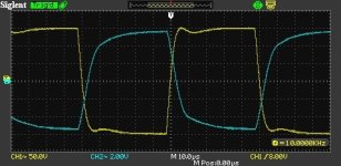

I also got the HQ-5090 output transformer in the circuit and tested it some. I swept frequency response of the amp at 1W. It was down 3dB at 40kHz, matching the datasheet. I swept it on the low end but it was still perfectly flat at 10Hz and I didn't really want to go below that. Datasheet says it should be 3dB down at 8Hz. I measured 1W distortion before (with Electra-Print OT) and after. It was very close but slightly lower with the HQ-5090. Difference was very small and might be within the margin of repeatability of my measurements. I measured Zout at 0.63 Ohm (12.7 damping factor). Pretty respectable, but I knew it would be with these low winding resistances. This is probably the perfect type of output transformer for this amp. It is almost optimal. It is gapped for more standing current than I need but is otherwise pretty perfect.

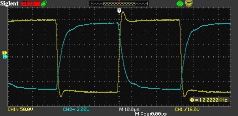

I have attached some square wave test results. I tested with an 8 Ohm purely resistive load and with 0.1uF, 0.47uF, and 2uF in parallel with the 8 Ohm resistor. Blue trace is the output tube plate and yellow trace is the output transformer secondary.
Unfortunately, I think the experimentation phase of this project is finished and I need to build it up in a chassis. I mean, I love experimenting so I'm actually kind of sad that part is over.

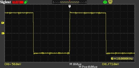

From your schematic in post #377, and scope plots in #386, there is an identifiable 100kHz resonance on the plate waveform, which is your feedback take-off. I couldn't easily identify your scope-probe bandwidth, or your square-wave generator bandwidth - do you know them?
You have a 100kHz RC within the loop. Do you know the opamp bandwidth for unity gain?
Do you know your feedback level in dB? Perhaps tricky to check, as you would need to use the nominal idle bias level of the input cathode from a fixed bias.
Typically for GNFB amps, the output is checked with a few spot caps from say 1nF to 0.47uF, but that is all very ball-park, and sort of depends on the square wave response, as you don't have a gain-phase measurement setup.
Probes are 70MHz, scope is 50MHz, the opamp is an LM4562 with GBW product of 55MHz(typ) 45MHz(min). I will confirm the generator BW. It is just a cheap unit and I recall it being something like 800kHz.
I measured open-loop gain of the stages once and came up with the ratio of open-loop to closed-loop gain. I don't remember what output tube I did that for but I came up with something north of 30dB. This input stage has a lot of gain. I'll try to run that again so I can get a better number.
Looks like I'm running about 25dB of feedback right now. I forgot I adjusted the feedback resistor ratio which cut the gain down to less than half of what it was. I just swept the generator and it looks to be 3dB down at 900kHz.

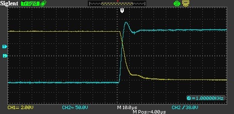

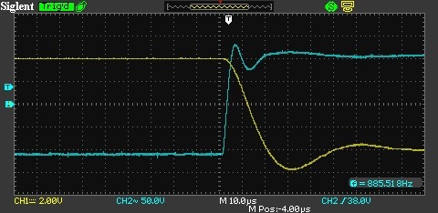

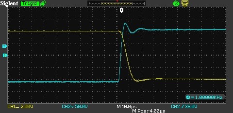

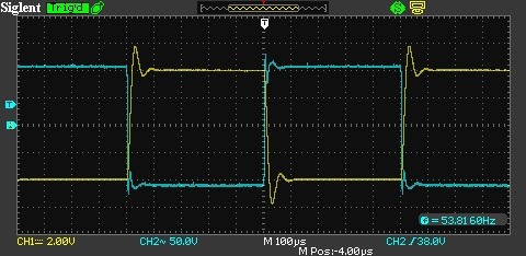

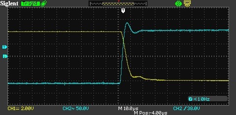

I adjusted the RC network to 100pF and 36.8k and got the square wave response below. I can try other capacitances later but ran out of time for tonight. I also attached the generator waveform for reference.

Here is 300pF and a 10k resistor. There is no overshoot but there is a dip after the leading edge. Is it better to try to round that bump off or is this pretty good?
I didn't have a dip in the square wave with the Electra-Print transformer loading the output tube plate...
The waveform on the secondary is definitely a bit smoother.
Edit: I have not tried differential feedback as you suggest. Gain would be pretty huge if I tried to apply it here. I'll definitely think about it.

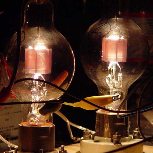

Just found this thread! Been wanting to try A2 for a while. Someday, I will! Followed a number of A2 threads here; pmillett and Michael Koster to name a few. Been collecting Eimac tubes for years for potential projects. Ran some 100TH & others in PP using Jack Iliano's driver transformer and an Edcor 100W 10K OPT (thanks Wavebourn!). Had to run the zirconium coated plates cherry red for a few hours to mop up gasses. Got to 100W but distortion products were a little high. Did not take notes back then, unfortunately.
