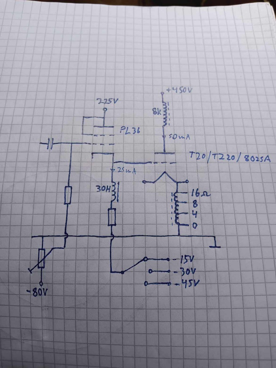

Is there a reason you went with the chokes? Was it to avoid a negative rail?
Sort of, yes. The easiest way to make a driver stage with a delayed soft start was to use a choke loaded indirectly heated cathode follower.
As I'm using SS diodes in the power supply (+500V and +250V from a 180-0-180VAC transformer) I had to take some measures to make life as easy as possible for the output tubes during startup. The best I could come up with without timer circuits etc. was a choke loaded cathode follower where the cold end of the choke connects to a negative low voltage rail and the CF tube has a thermistor in series with its heater to add some extra delay. This way, the output tubes are biased into complete cutoff until their filaments have reached their full emission capacity.
Things get a bit more complicated as I intend to build this amp to fit three different output tubes with different bias requirements (+23V for TZ20, +12V for T20 and around 0V for 8025A), the solution was to use a few spare heater windings to make a "ladder" of negative voltages available. This way the voltage drop through the choke and thus the idle current through the CF can be kept fairly constant.
A conceptual drawing of the driver/output stage:

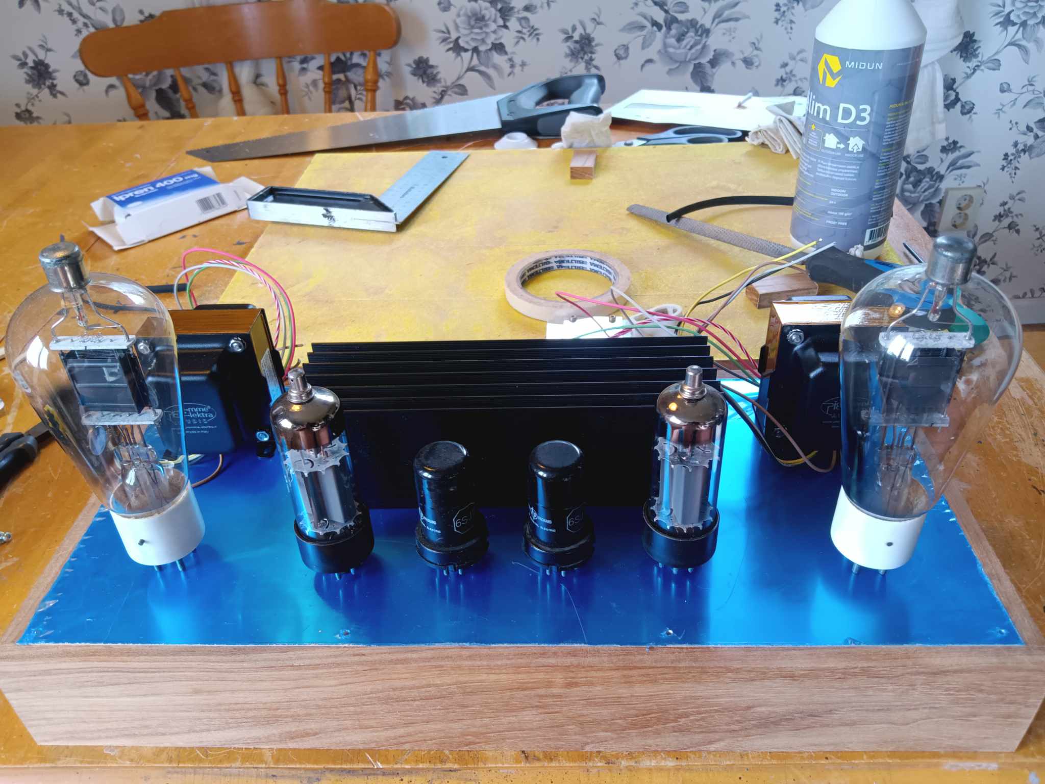

Here's an update on my progress on this amp. Chassis work had begun.
I've constructed a solid state preamp/crossover for the input of this amp. I just wanted to have balanced inputs and to be able to biamp with a subwoofer. The crossover has a bypass switch in case I don't want to use it. I also need a bit of gain up front for some sources.

Looking good!
Beware of vibrating power transformers, I had to rebuild the PSU for my 808 amp completely because of that. All those flat .040" alu sheets (with the same surface area as four 18" drivers...) sang along with the transformers even with rubber dampers everywhere, in the end I moved everything over to a box made of welded .05" steel that I stole from a scrapped CNC lathe that was rusting away behind my old workplace... 😎

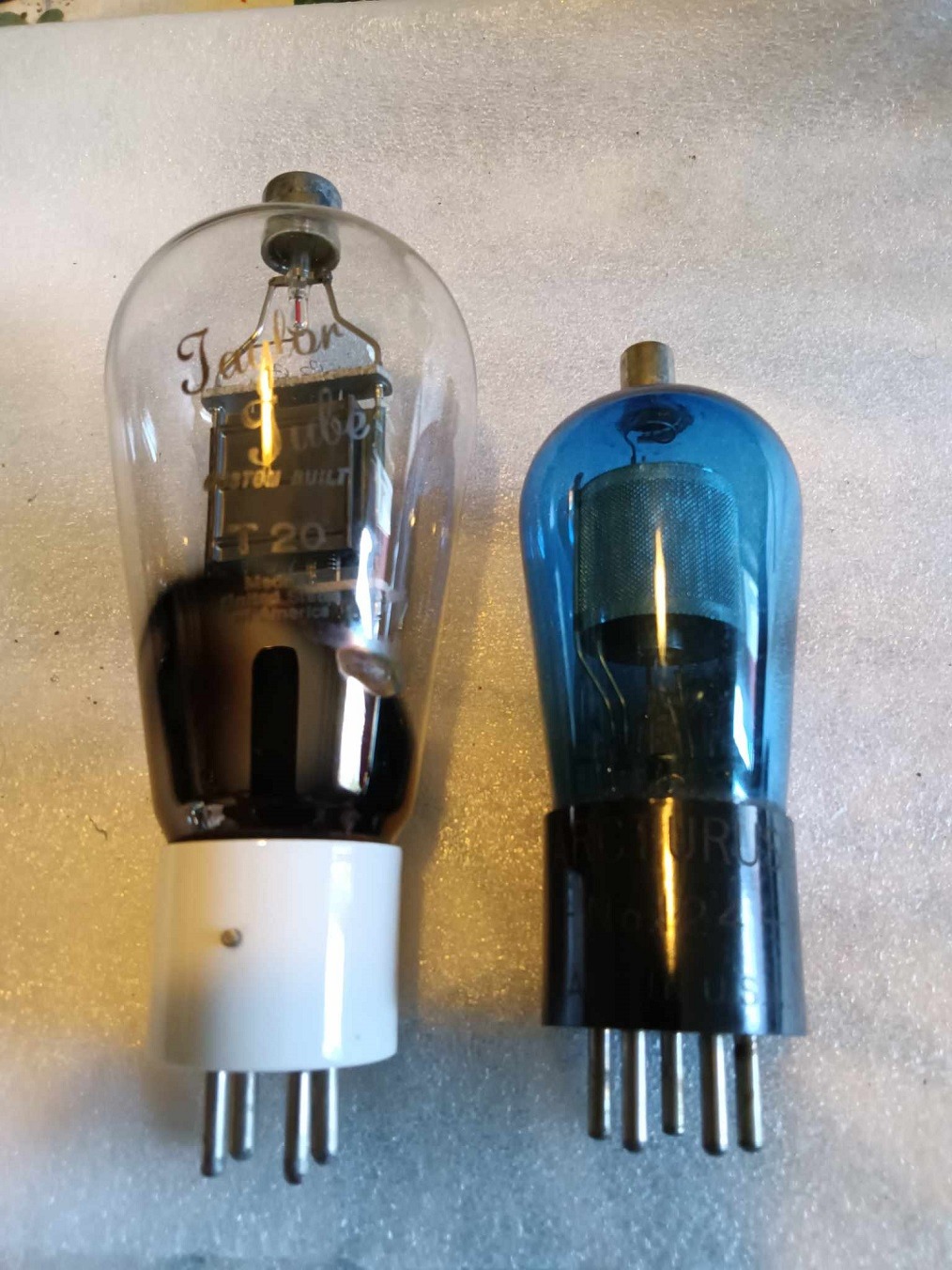

What type number is that little blue tube? I have one but the marking is gone.
I believe the old #24 exists in a myriad of versions: 24, 24A, 124, 224, 324, UY224 and so on. If the numbers are completely rubbed off it could also be a 35 or a 51, as far as I can tell they look the same.

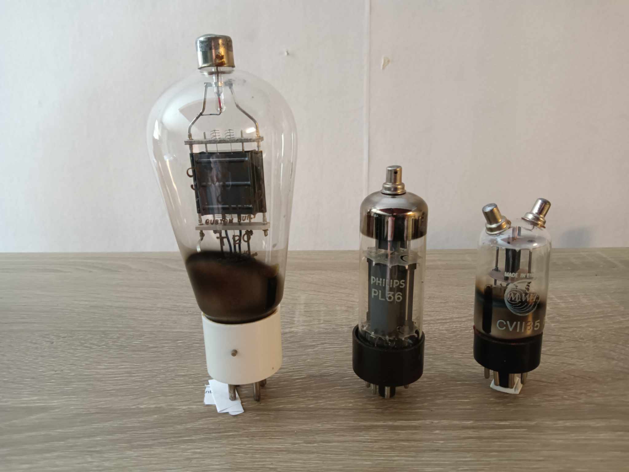

A cool looking tube for sure, but a bit too modern-looking for this projekt. Unless I change my mind again I'll cut holes for two octal sockets per channel, that should leave me with plenty of options for both input and CF tubes. Using noval sockets for the driver tubes would allow me to use tubes with some serious gm for the CFs but the 25E5 (~6CM5, EL36, PL36) gets the job done and can be replaced with the pin compatible E130L (27mA/V) later on.
As input tubes I can think of several single triodes or pentodes that chould cut it, depending on how the plate to cathode feedback experiment goes. 6J7 or 6SJ7 should do nice as pentode input stages, and I have some nice CV1135s (~1/2 6SN7 with dual top caps) if I want to stick with medium mu triodes.
The picture shows a T20 next to a PL36 and a CV1135. A sweep tube with similar specs to the PL36 but in a fatter bottle would be nice, there is probably some American tube that I don't know about that would fit the bill. 6DQ6 somes close but has lower gm according to the datasheet.
My experiments with output plate to input cathode feedback in the T20 amp didn't turn out too well: After fiddling with the resistor values around the 6SJ7 I managed to get a but over 2dBs of feedback. It currently has 66k plate resistors, 470R cathode resistors, 200k feedback resistors and 95V on the screen grids.
I guess I should have picked an input tube with a bit more gm.
