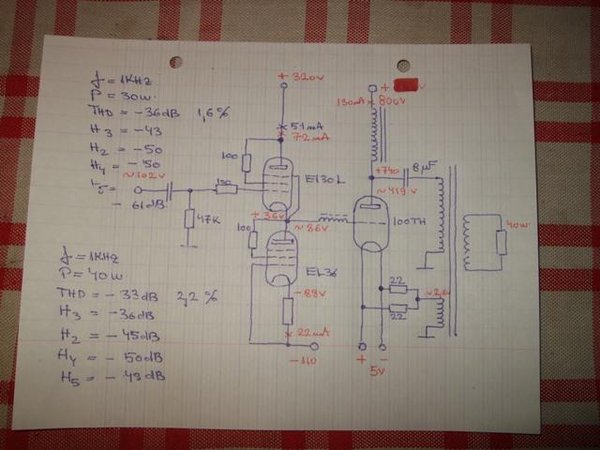

Very nice results obtained by you with this tube. I also tested an SE amplifier in class A2 but i couldn't find a pair for 100TH and i had to abandon the project but i still did a mono audition and i was very happy with the dynamics of this SEYeah, the 100TH exceeded my expectations by a good margin, and I love the way they look.

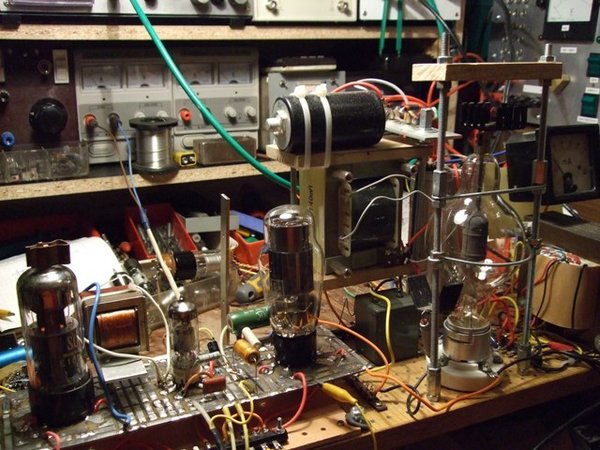

That looks just like my Lewis and Kaufmann tube. It's too bad Russia never used 100TH in military applications or they would probably be cheap and plentiful today.

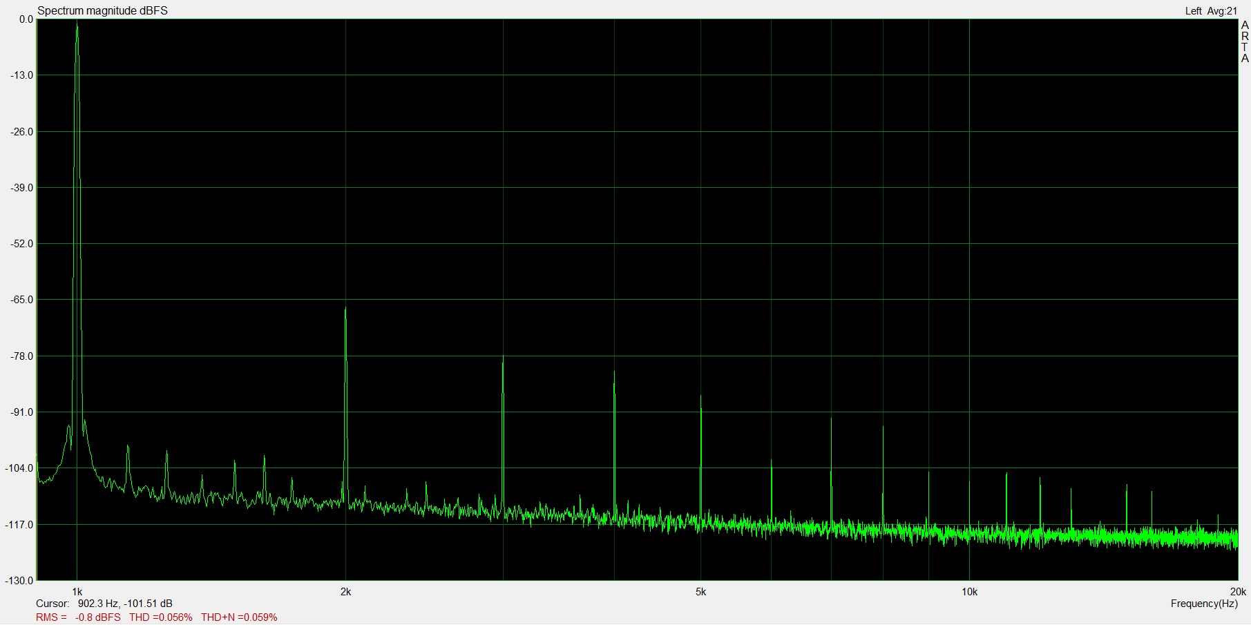

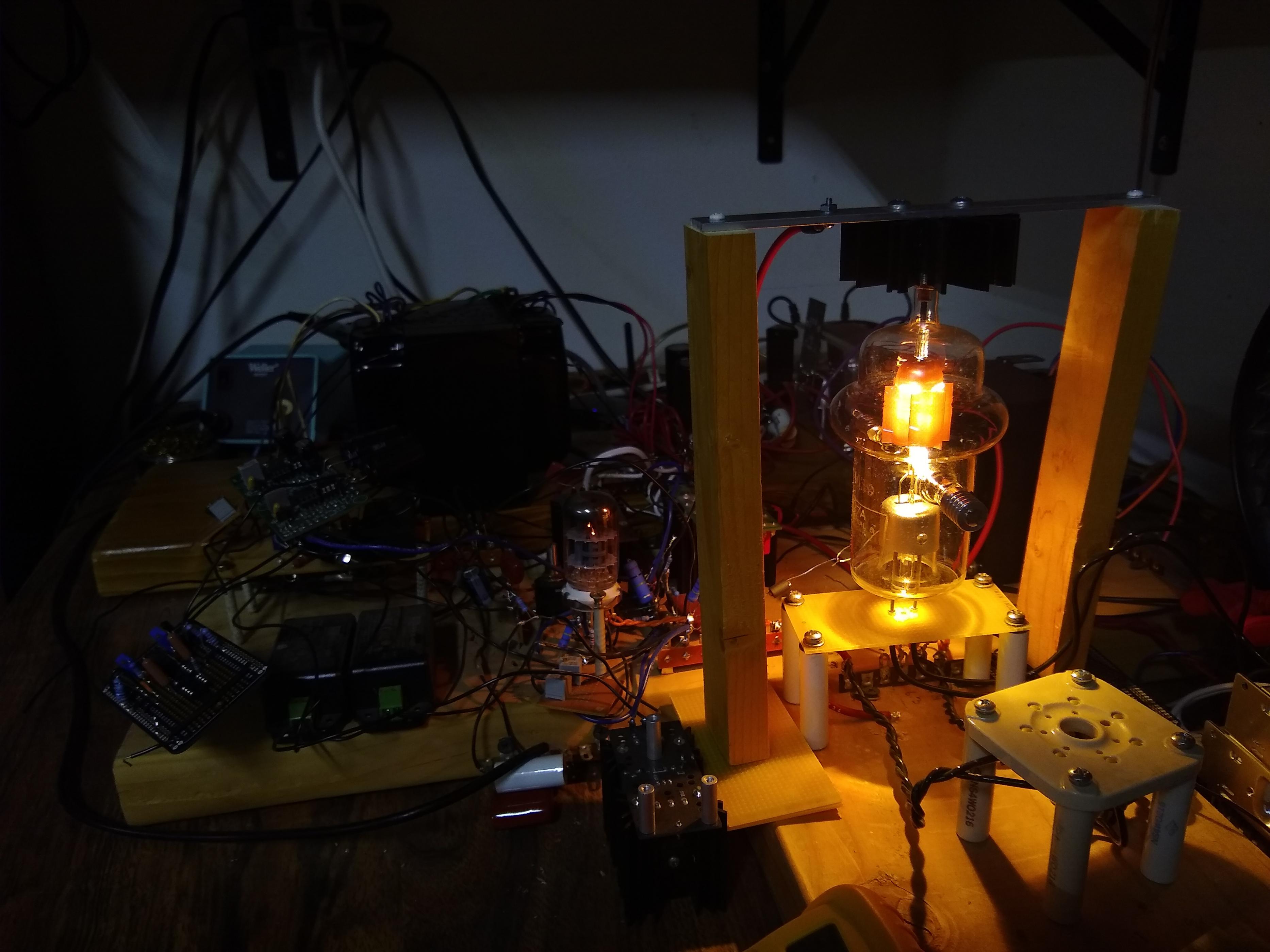

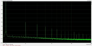

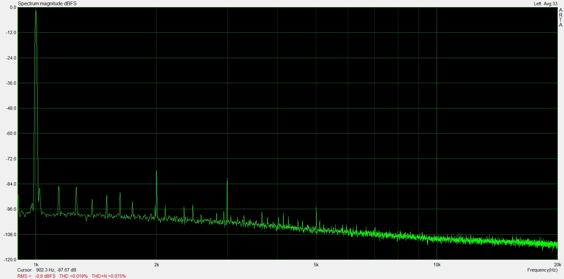

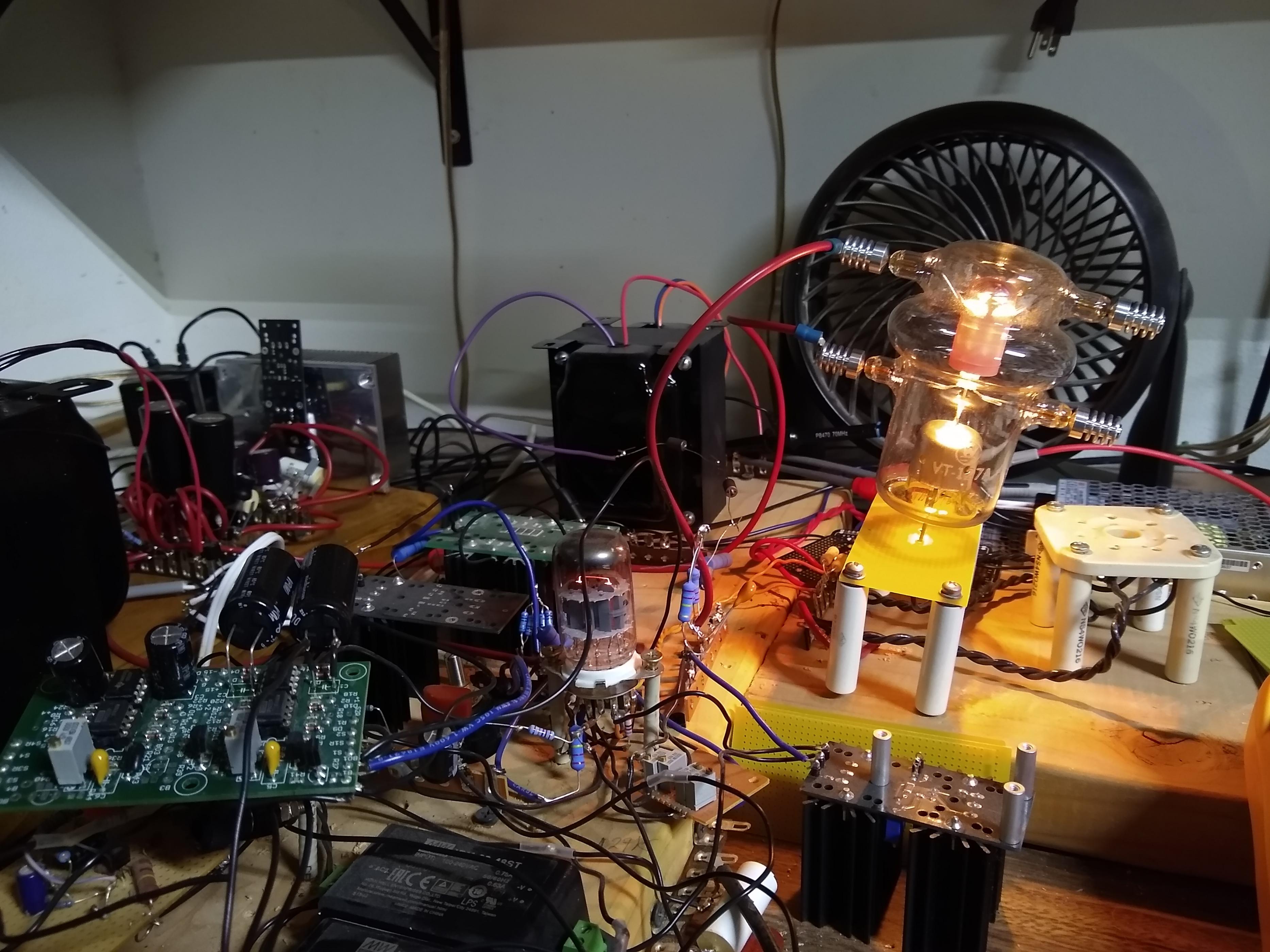

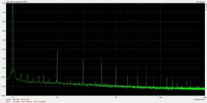

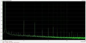

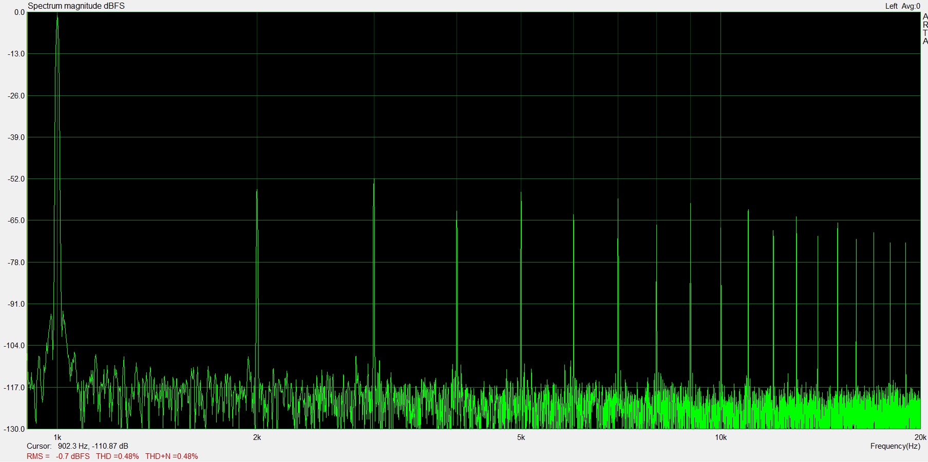

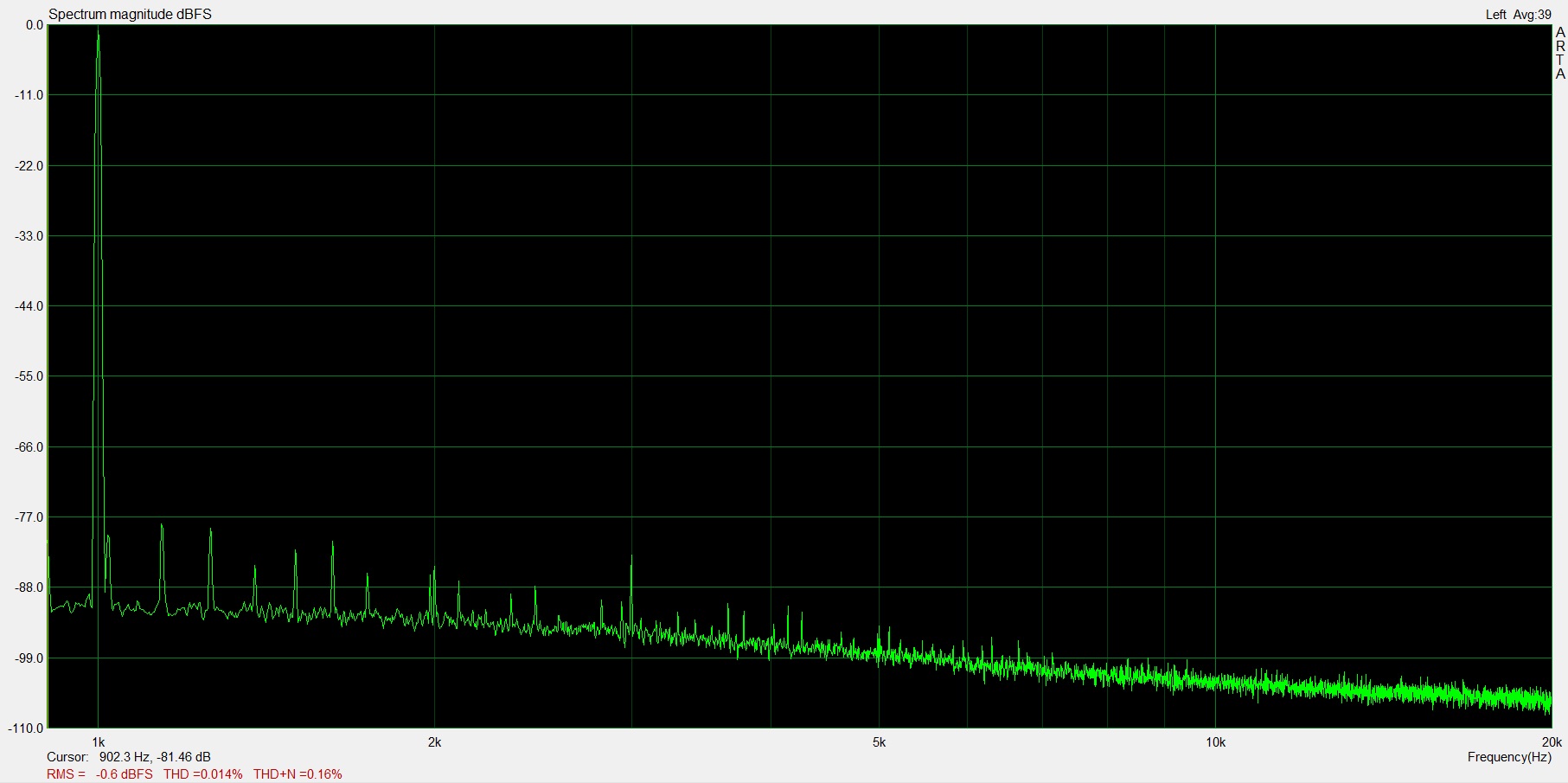

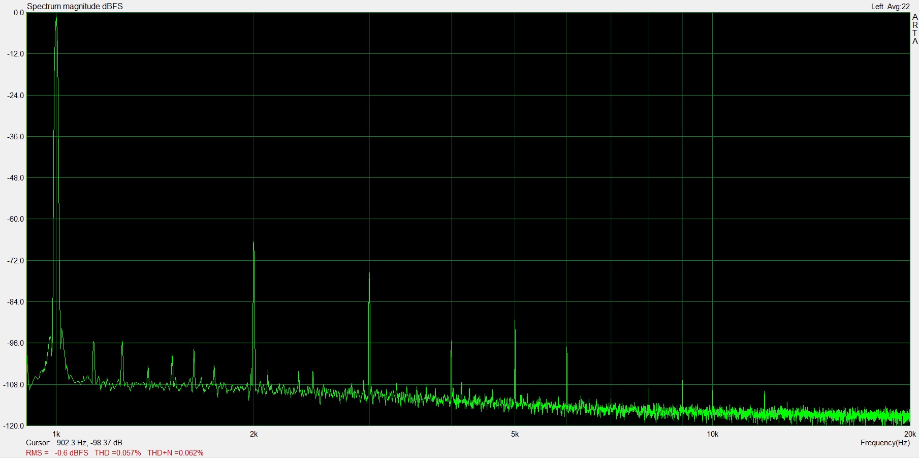

I got the 327A installed today and running. The 327A uses the 100T plate. Gain is slightly less than a 100TH, and it has a 110W filament 😱. The tube lights up extremely bright. It was designed for pulsed duty in a WW2 ship radar, so it must have needed a lot of peak emission to have a filament that dissipates more than the plate.
Sound was excellent. Sweet and effortless even at ear-bleeding volumes. A real pleasure to listen to. It topped out at 38.3W.

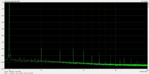

I'll attach the distortion measurements to the next post. Too many pictures for 1 post.
100mW: 0.014%
500mW: 0.019%
1W: 0.026%
2W: 0.038%
5W: 0.057%
10W: 0.056%
20W: 0.077%
30W: 0.14%
38.3W: 0.48%
Distortion was generally slightly higher than the 100TH, but very close.

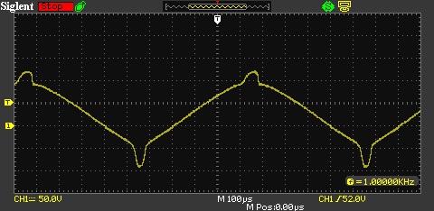

Grid waveform indicates that clipping is hitting both sides pretty symmetrically; a good balanced operating point.

Amazing result obtained by you, congratulation for them especially for running in class A2, my opinion is that a 40w SE amplifier is superior to a PP equivalent, but not everyone can do such a thing, congratulations again
Thanks!

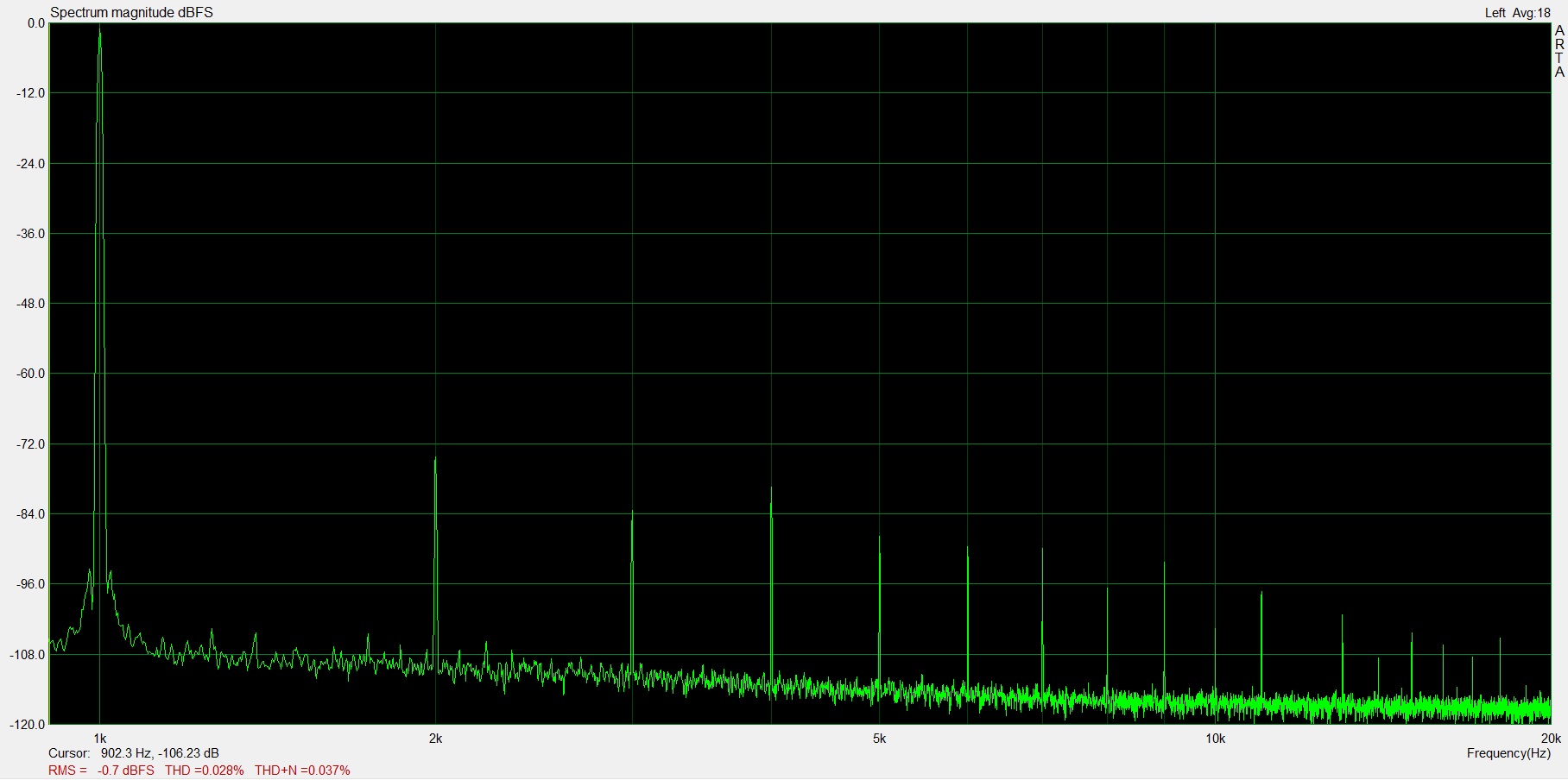

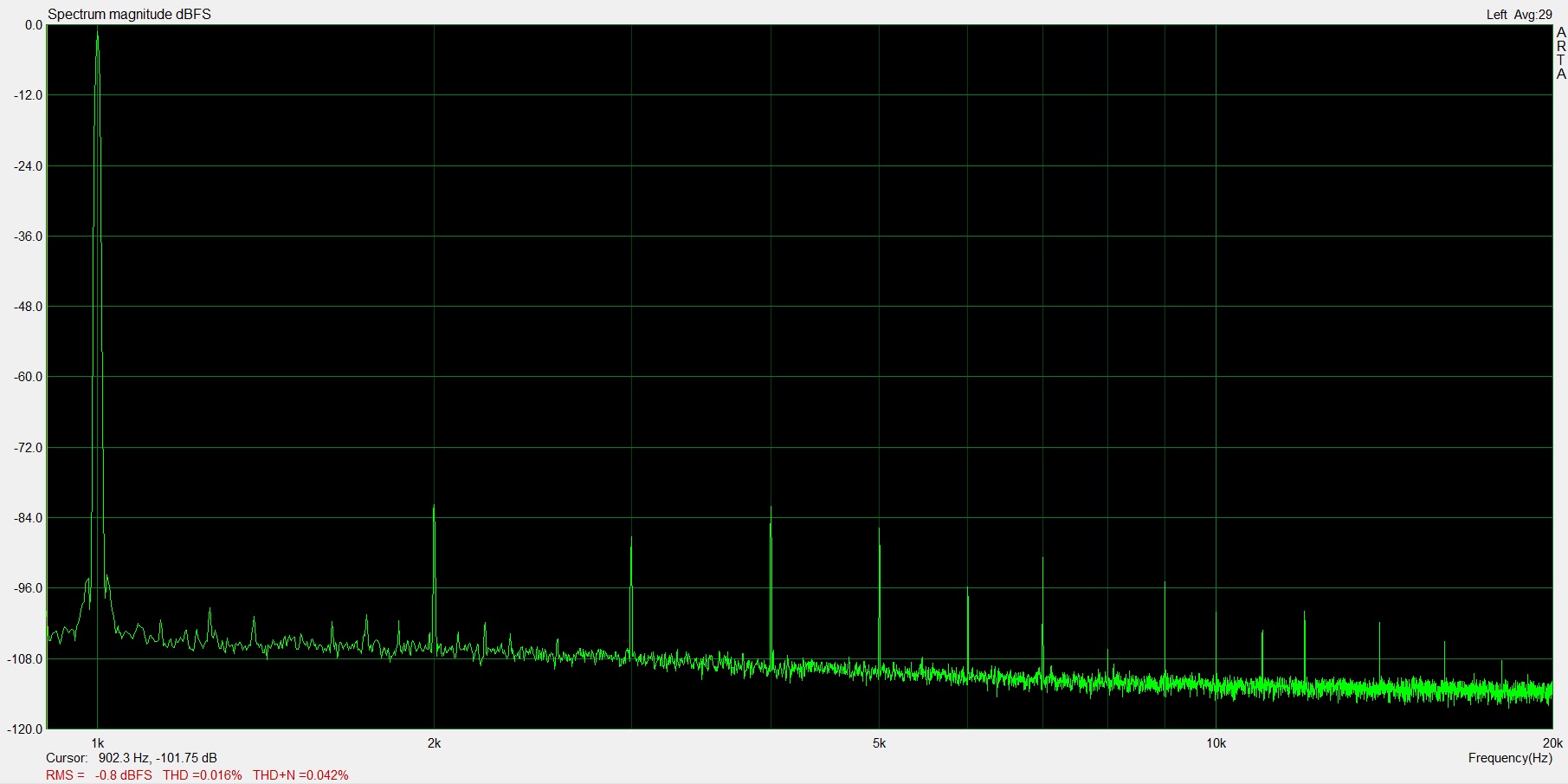

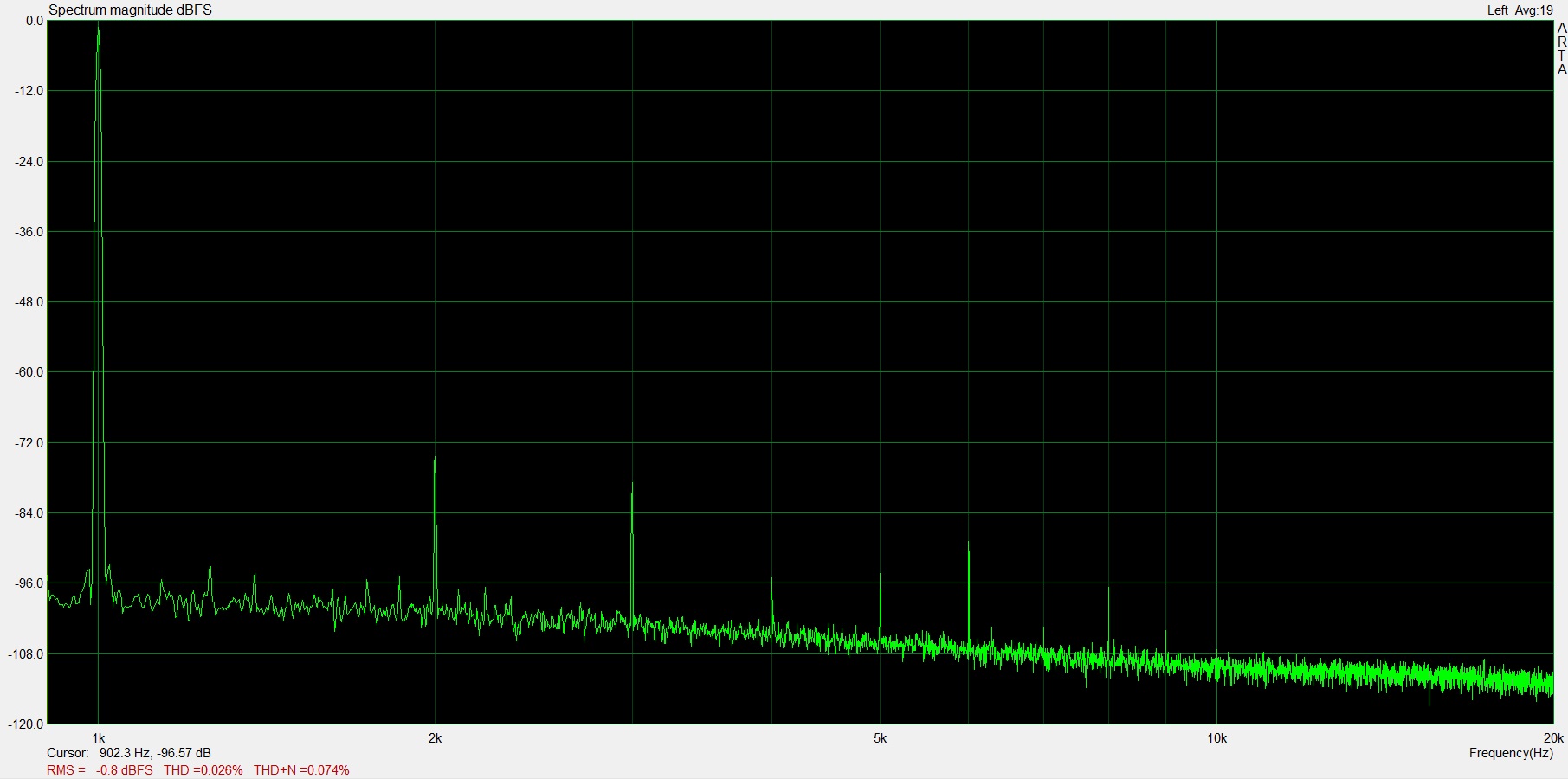

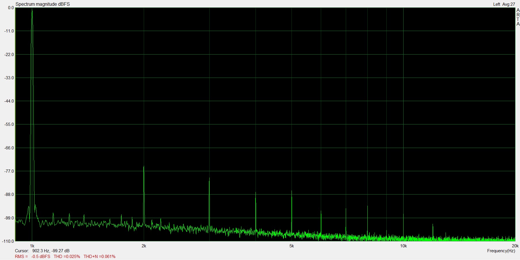

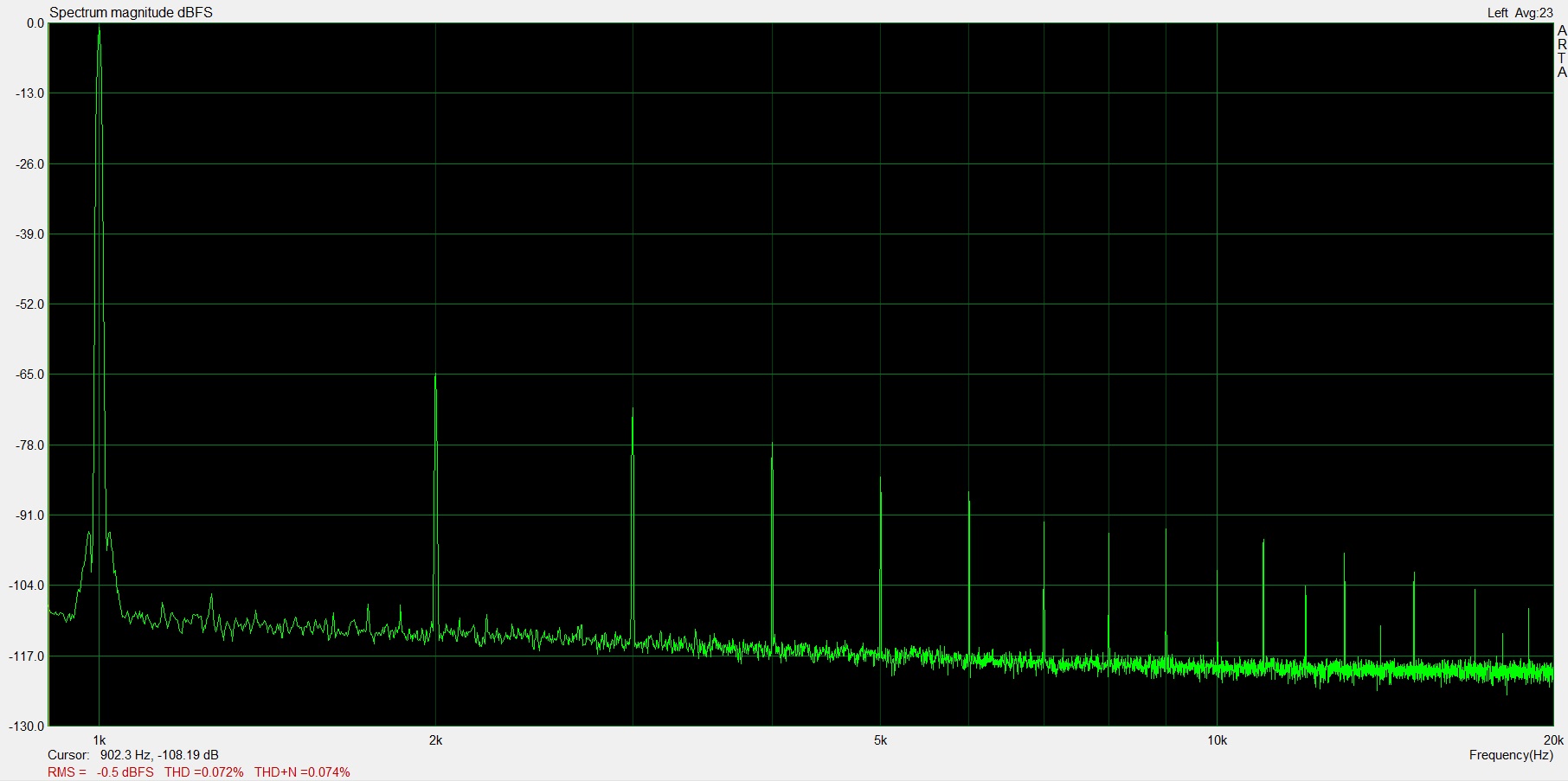

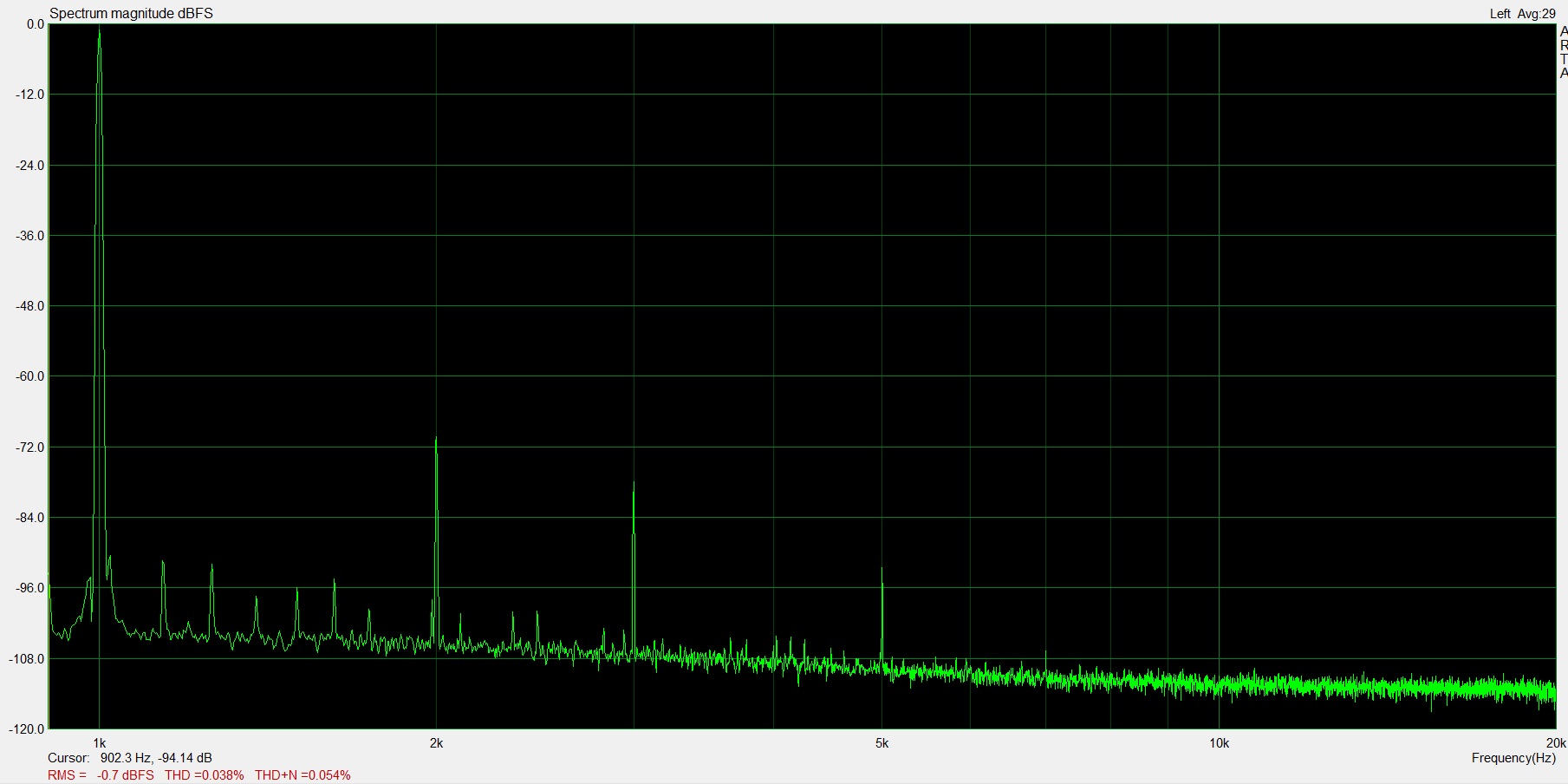

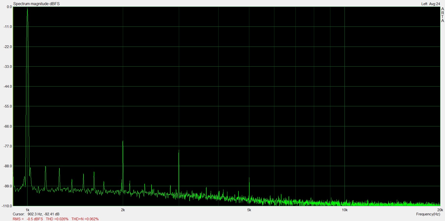

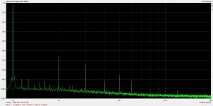

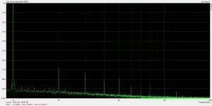

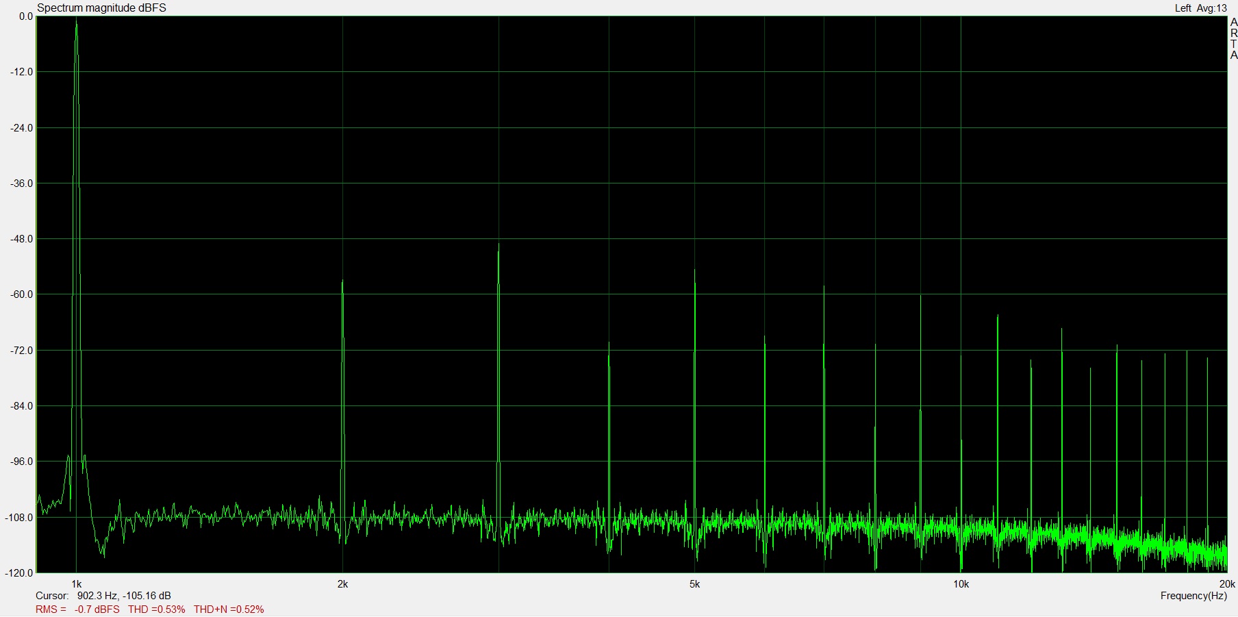

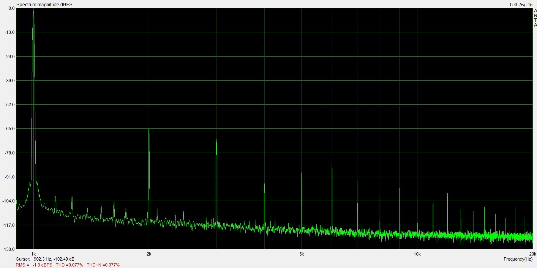

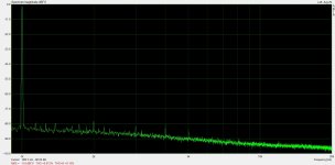

I got a VT-127 into the amp today and got it tested. The VT-127 is also a 100T variant used in WW2 ship radar. It is a lower mu tube than the 327A and has a 55W filament. Mu is about equal to a 100TL.
Attached are results. Here is a distortion summary:
100mW: 0.012%
500mW: 0.026%
1W: 0.025%
2W: 0.016%
5W: 0.028%
10W: 0.072%
20W: 0.15%
30W: 0.26%
42.5W: 0.53%
I noticed I had more high-order harmonics in the results. I'm speculating that crossing the Vg=0 line is generating this. We start crossing at about 500mW with this tube since it is biased at +10V on the grid and is lower gain than the other tubes. The higher mu tubes were biased at more like +35V and they have more gain, so we don't start crossing Vg=0 until much higher power levels. It makes me wonder if the best results wouldn't be with a really high mu triode like 811A. The grid wouldn't go negative on that one until just before clipping.
The dip in distortion between 1 and 5W was kind of strange as well. Not sure how to explain that. Also, I got a bit more power out of this one. Maybe I just pushed it a bit harder. I'm kind of just looking for where the grid waveform starts getting spikes and stopping there.

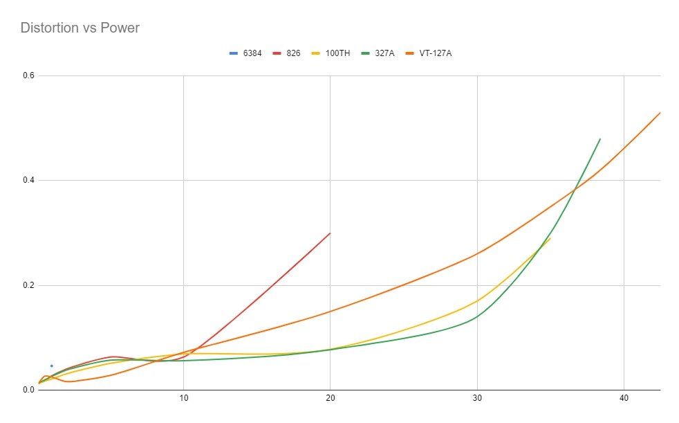

Here is a comparative plot with all of the tubes I have used in this circuit. Unfortunately I only took one data point with the 6384 at 1W with this final circuit, but I included it here for comparison.
I'll update with a 211 column when I get my hands on one to test with.
It's the same as what is shown in post #2 but I have increased the rails to +150V/-100V to accommodate the additional required swing for the lower mu tube.

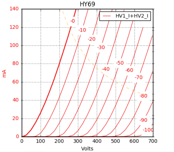

Luckily all of the 100T variants are pretty similar so the same operating point works for them. The grid bias varies with the different variants but the bias servo handles that. Unfortunately the 211 needs negative bias, which the bias servo wasn't made to handle.

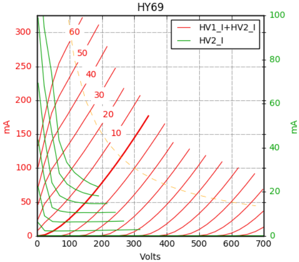

My vote would be Pentode-connected HY69->211.
The HY-69 could be run as a driver tube pentode for something larger.
Thanks, I'll give that idea some thought, they are flexible tubes. In triode, remind me of a type 50, but with nearly double the gain and can run in A2.
