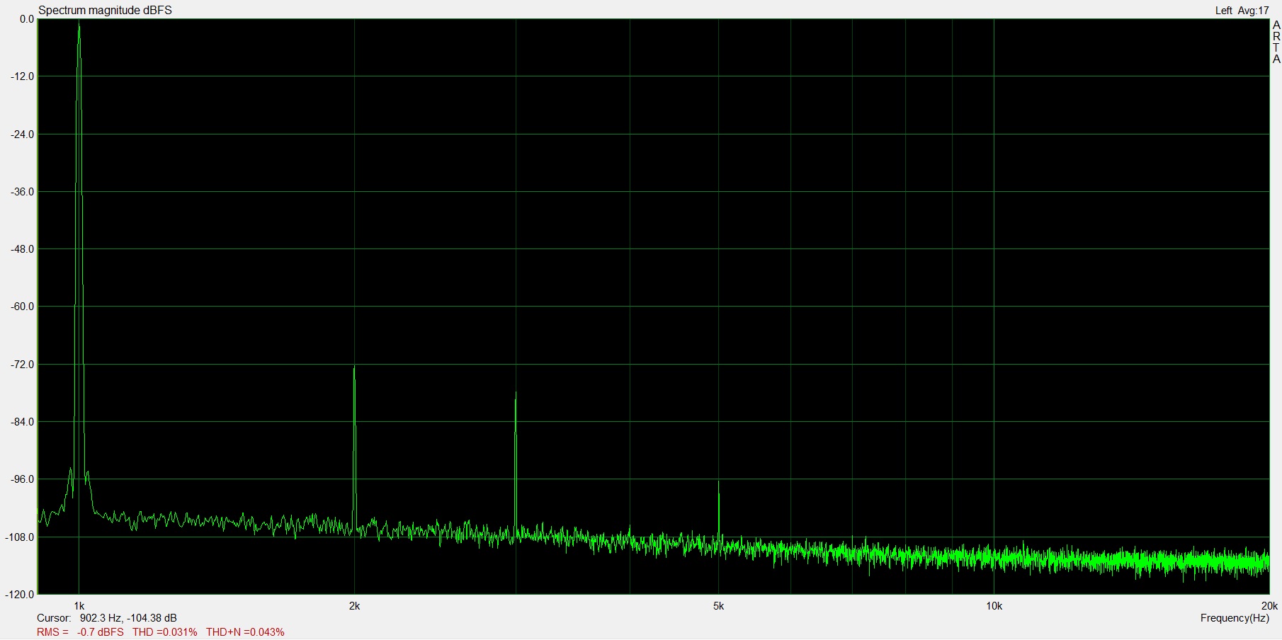

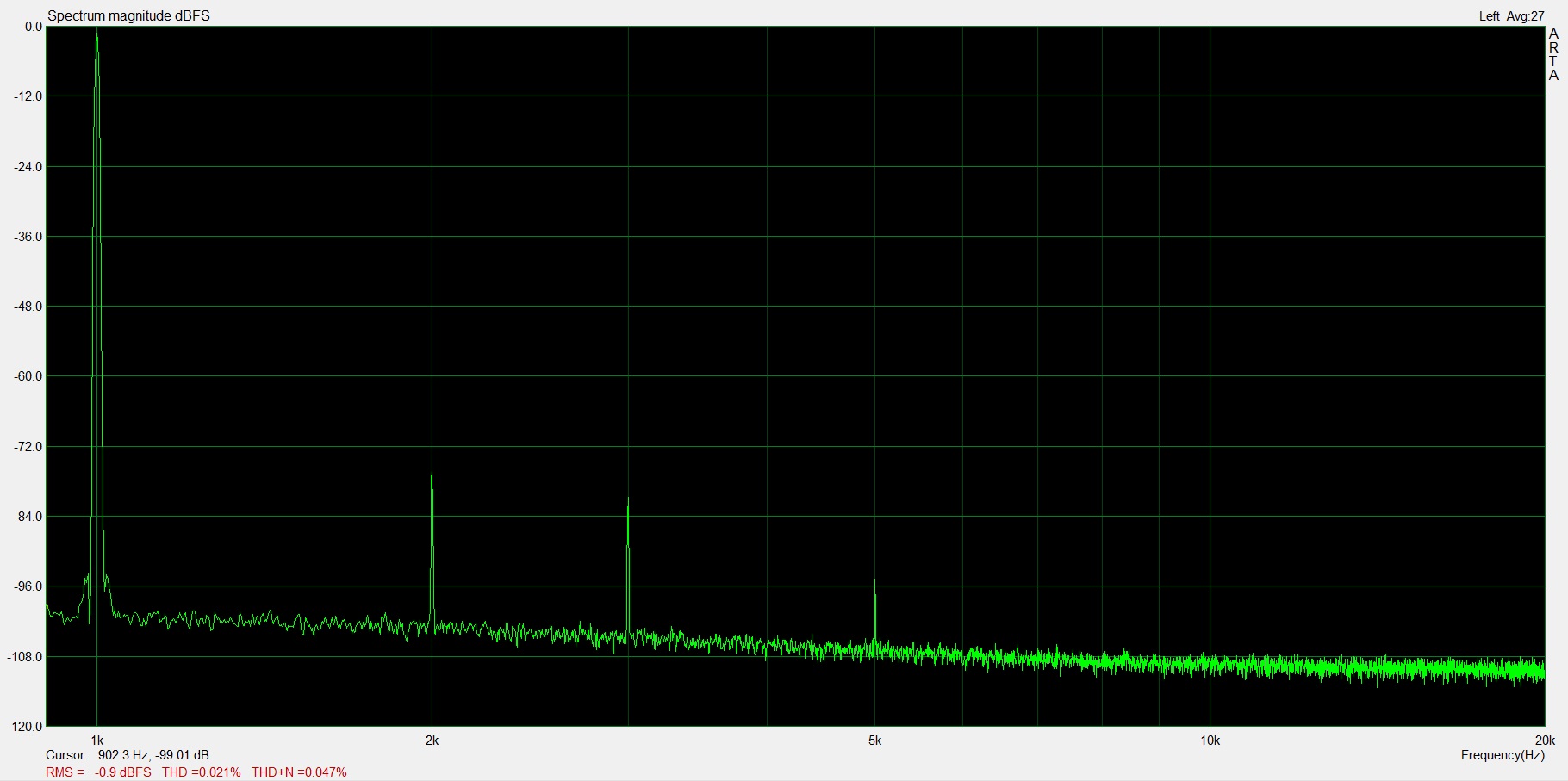

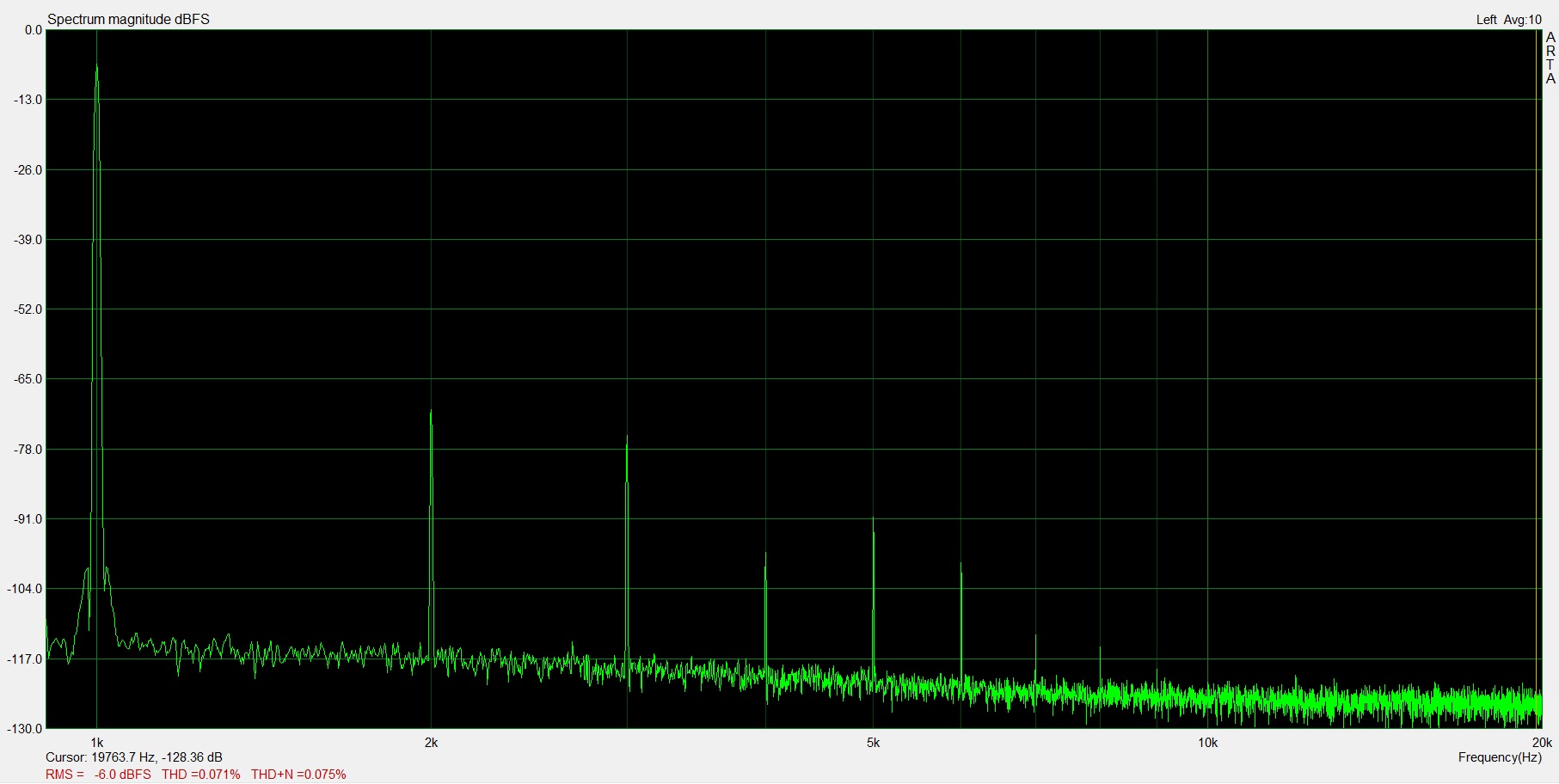

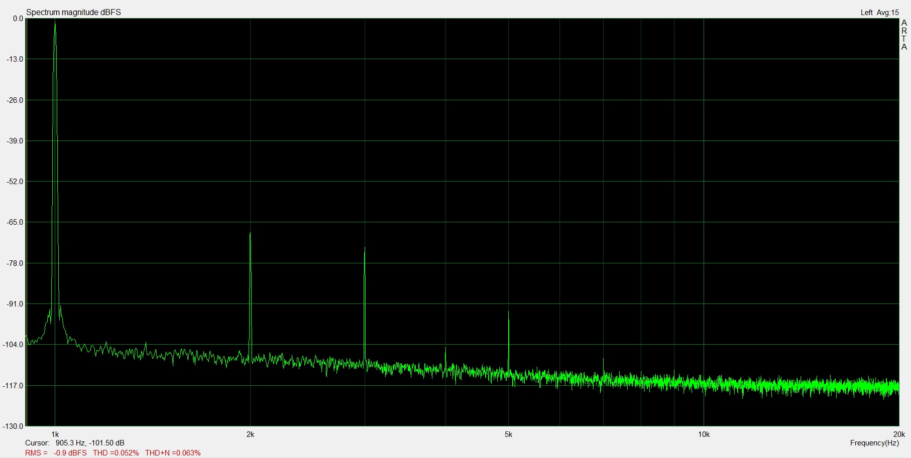

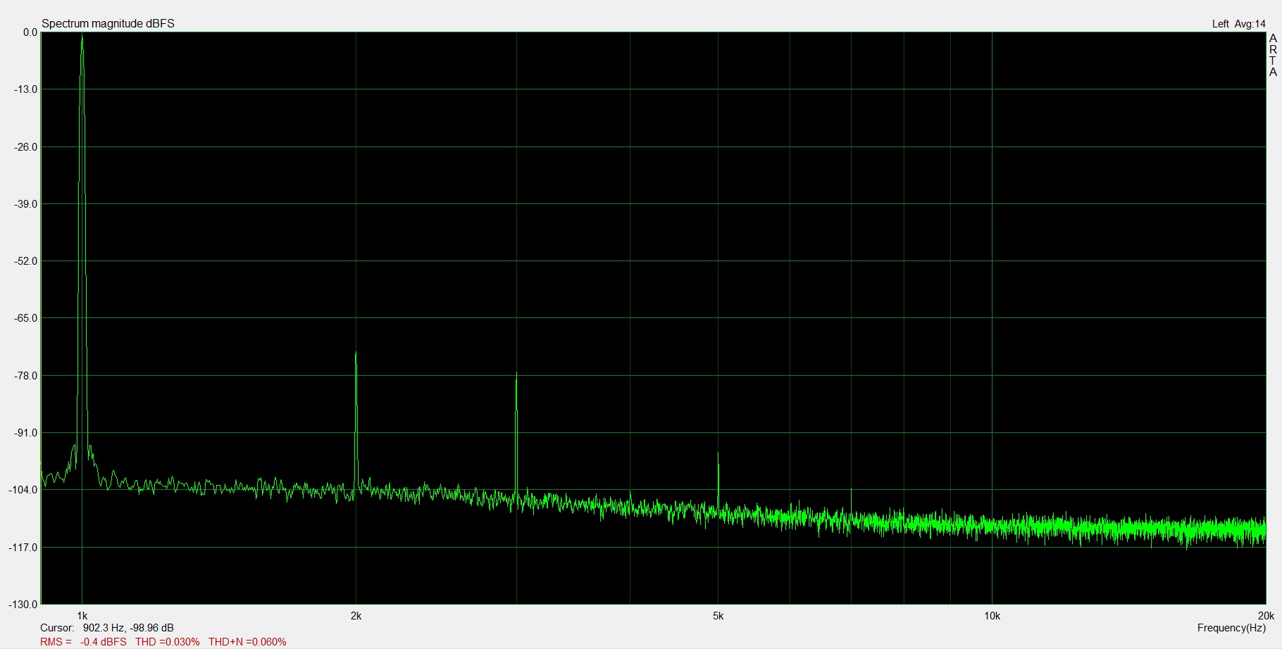

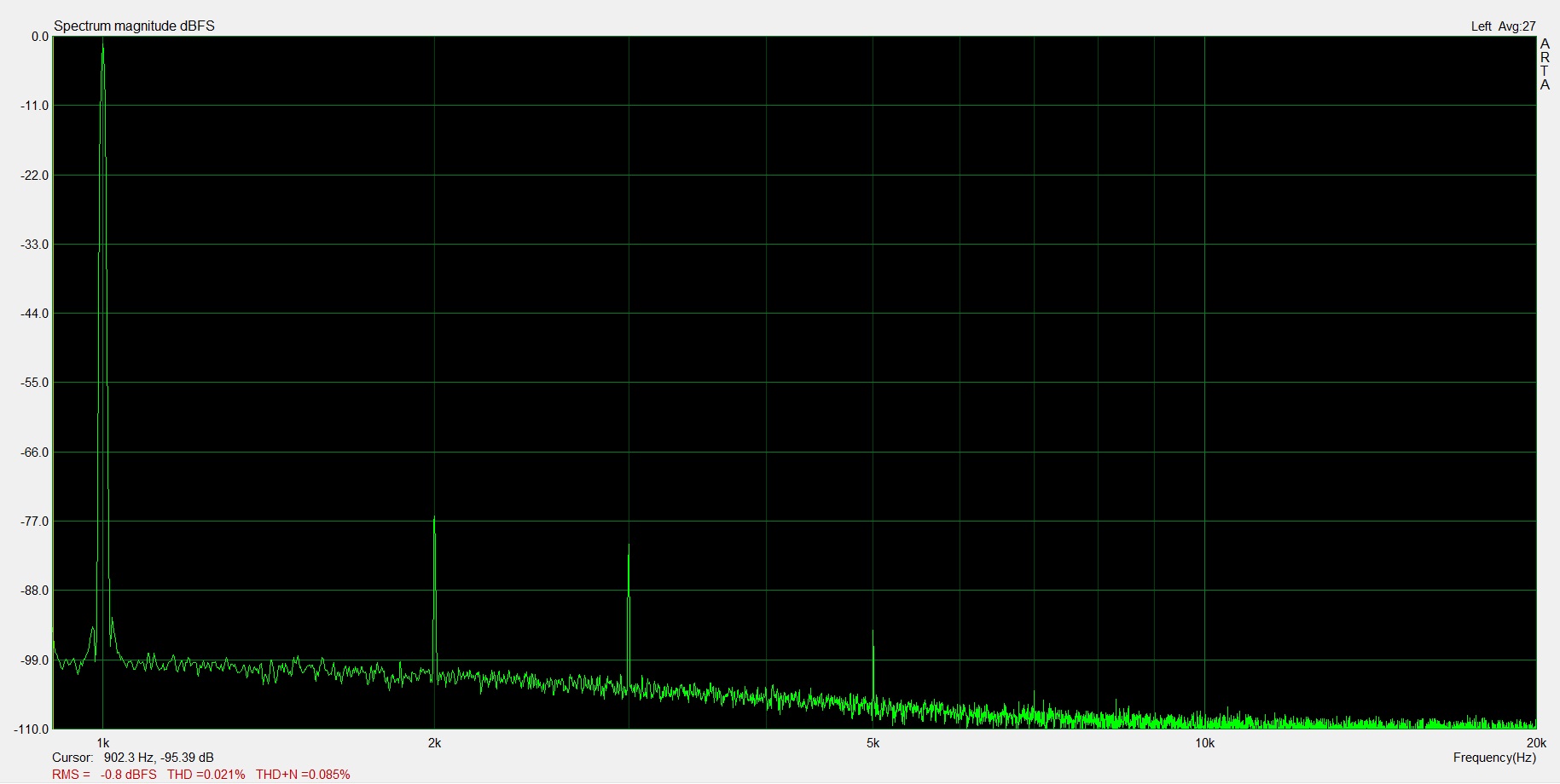

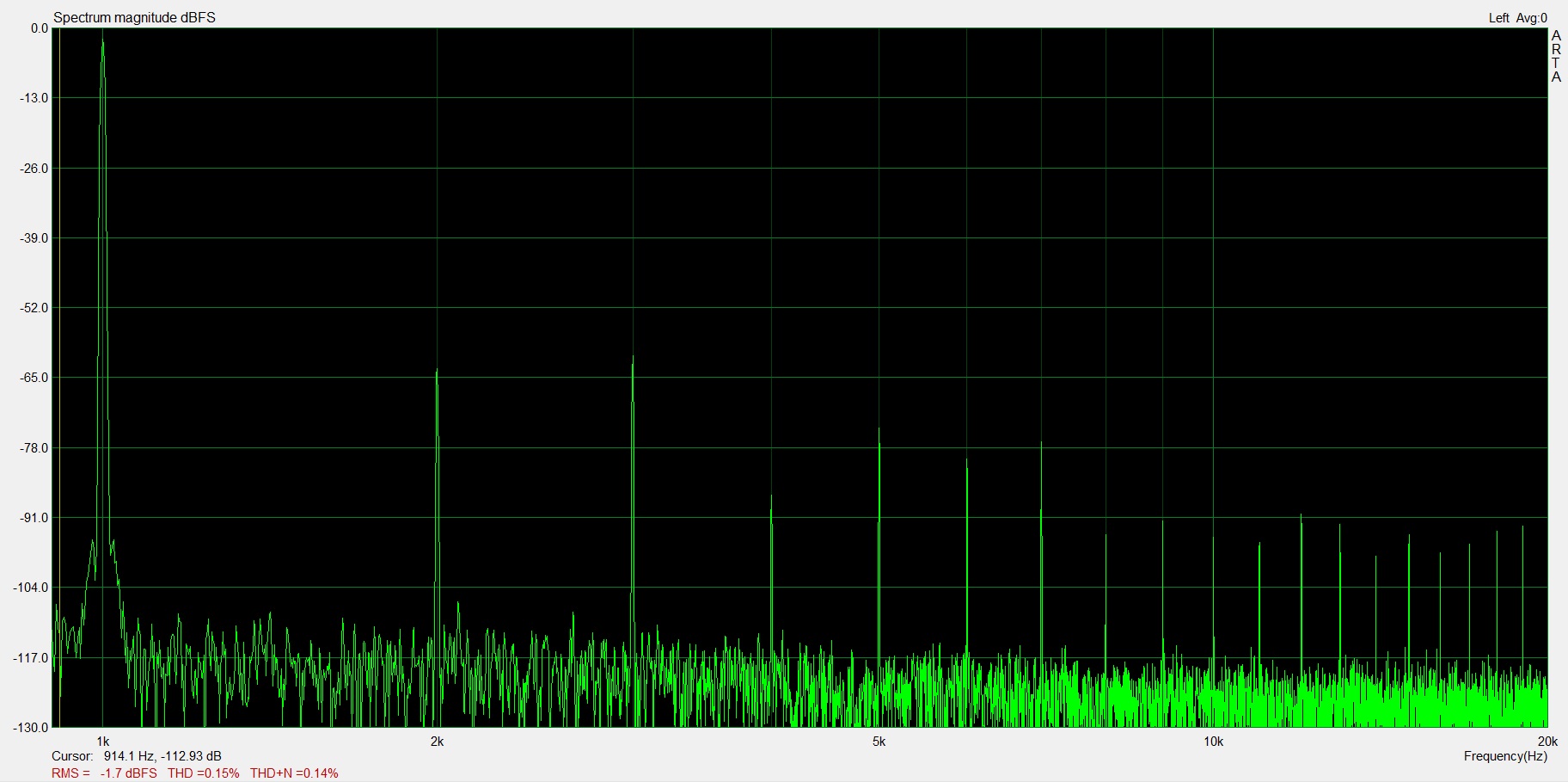

I did some measurements with the 100TH. My B+ still isn't at 750V like it eventually will be, so power output is limited for now. Clipping started at 27.4W.
Here is a tabular summary:
100mW: 0.012%
500mW: 0.016%
1W: 0.021%
2W: 0.030%
5W: 0.052%
10W: 0.071%
20W: 0.084%
27.4W: 0.15%
It's got a little less distortion than the 826 except at 10W. The 826 had something weird happen where THD basically didn't increase from 5 to 10 Watts. The 100TH increases steadily.
I also noticed that I'm clipping symmetrically but I'm hitting the positive rail on the mosfet grid driver. I'm going to have to throw another 48V supply on the stack. When I get the 750V supply finished, I'l increase q current a bit and we should have over 30W out.

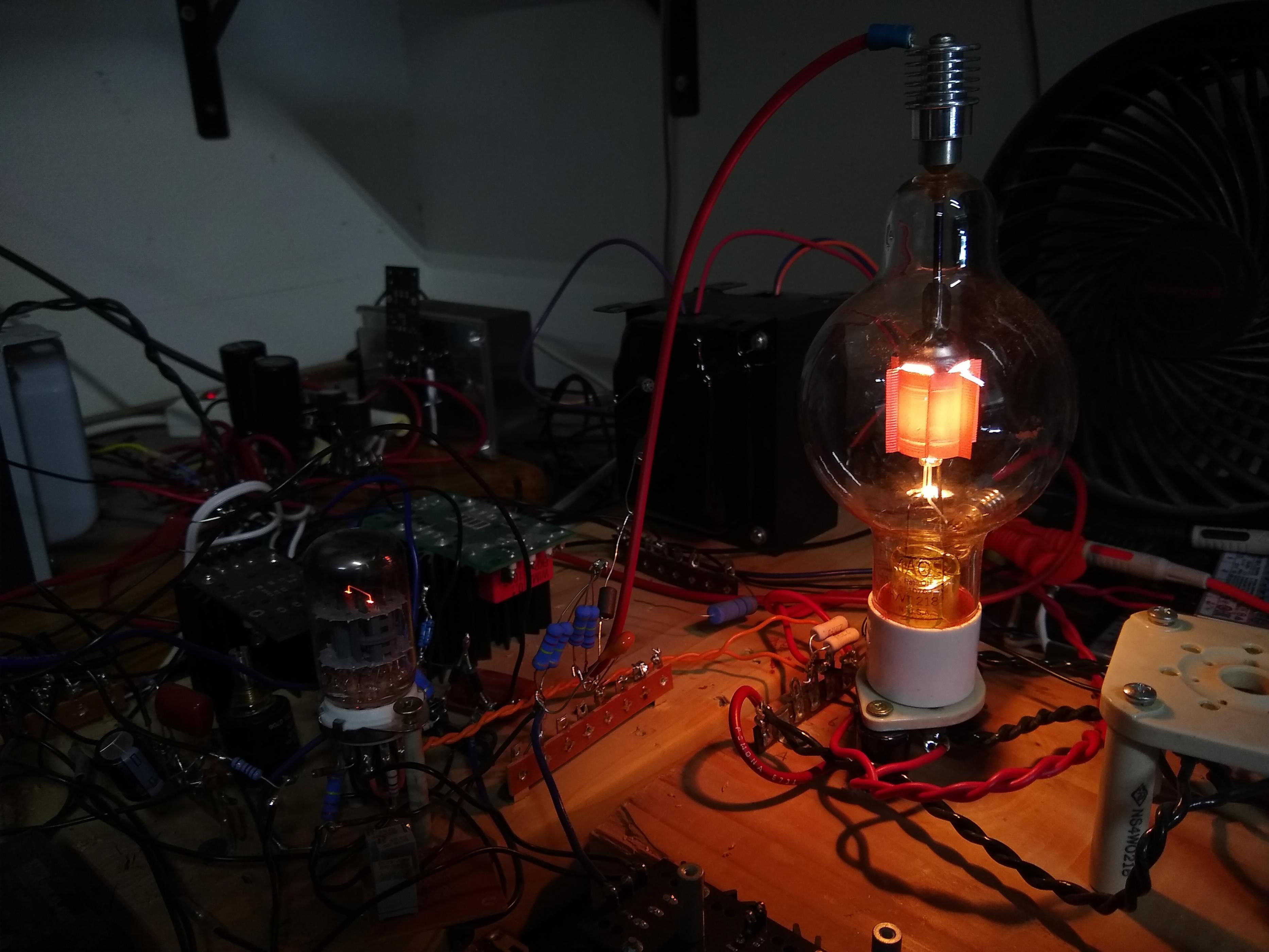

I am still collecting transmitters for an HK54 / 35TG / 35T build, got this pair of 35TG today, untested, took a gamble and got lucky, NOS from 1945.
And still rocking away with that 801A amp.
How does it sound with your speakers?

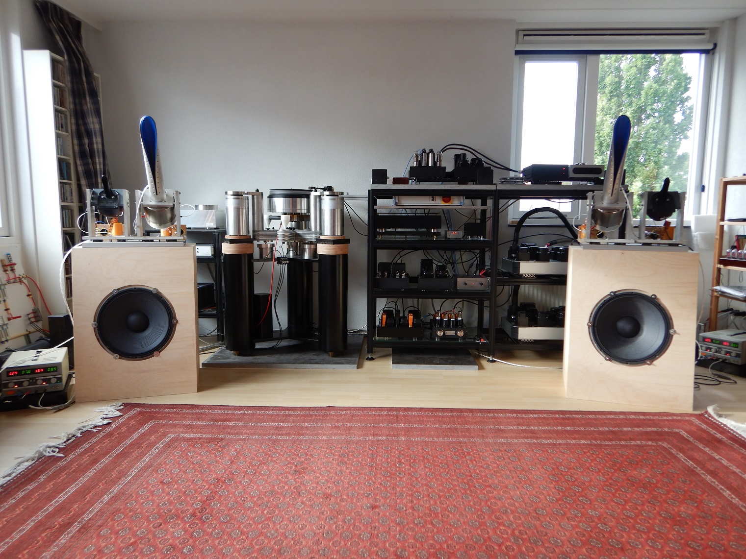

Amazing looks, if it wasn't for the exposed contacts carrying high voltage I would swap my GM70 project for this one 🙂

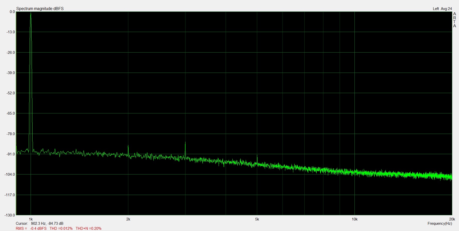

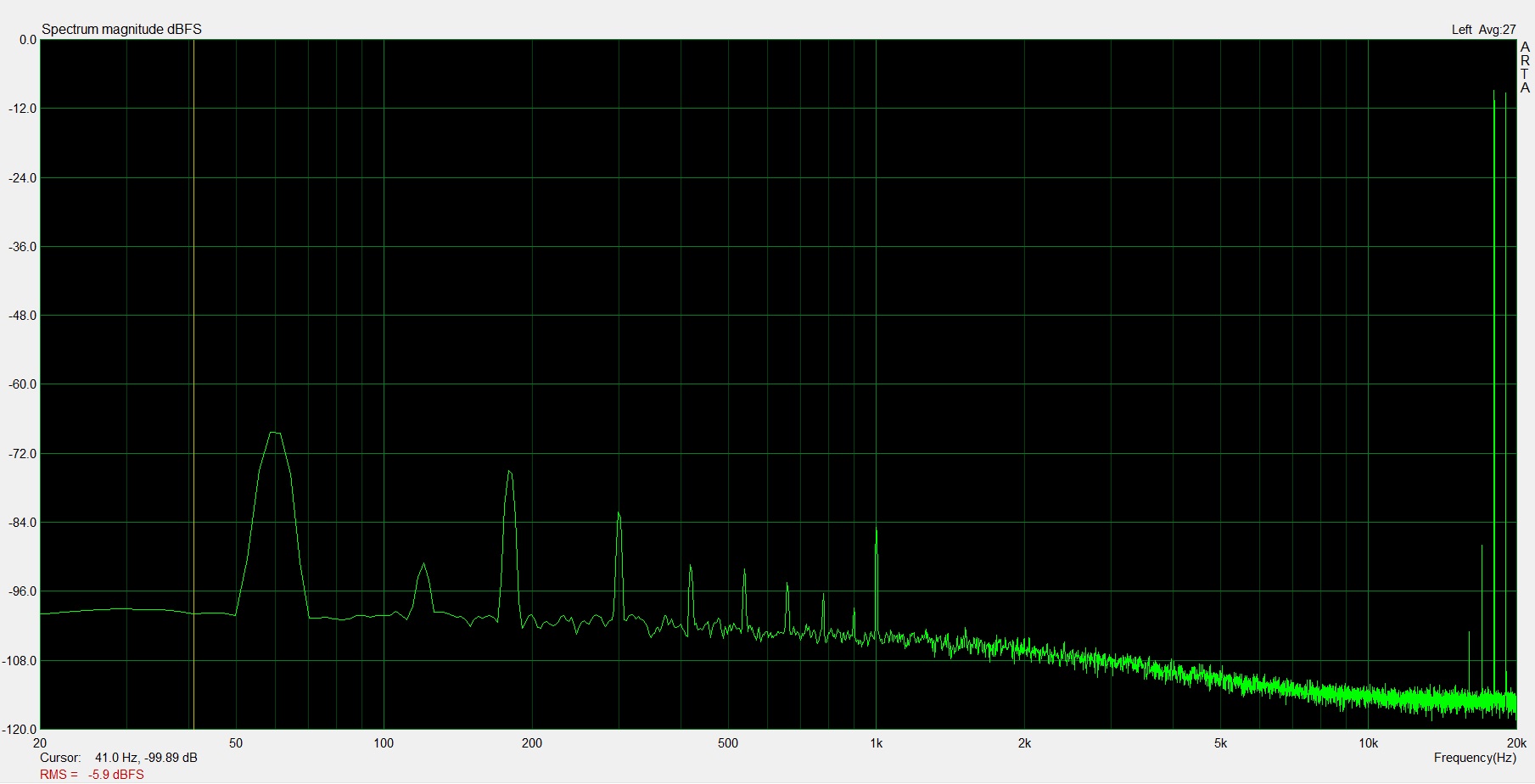

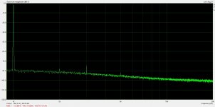

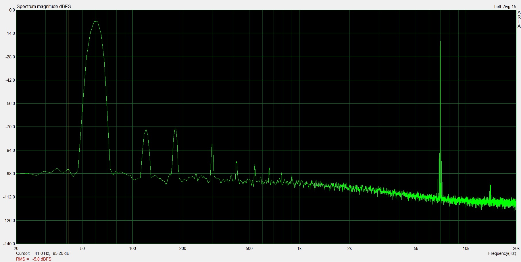

Very low THD distortion, can you measure IMD 60Hz / 7kHz and 18kHz / 19kHz?
These are at 1W output.

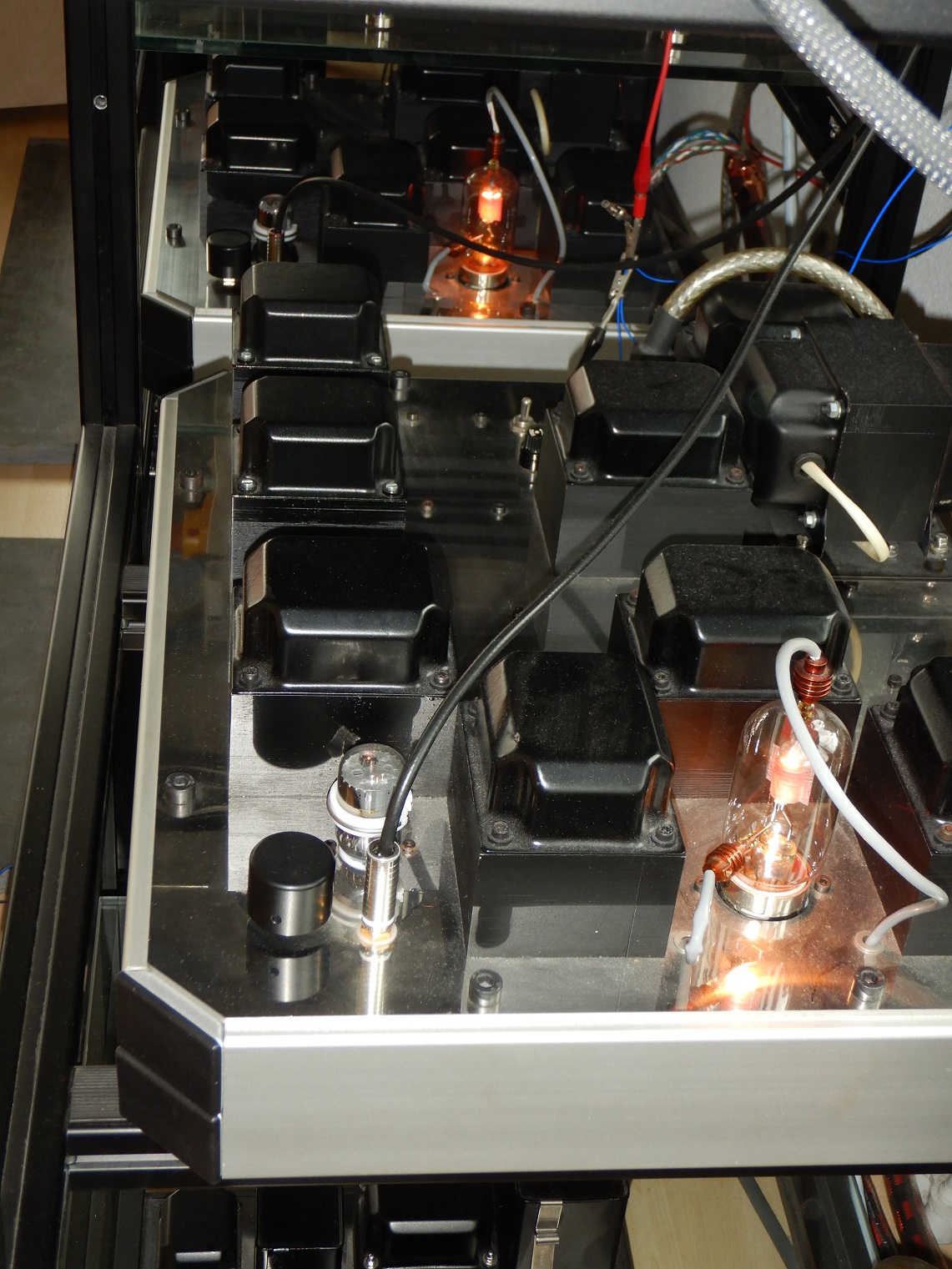

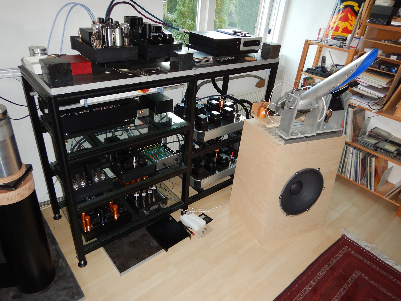

Hi SpreadSpectrum,
those 35TG's are really nice tubes.

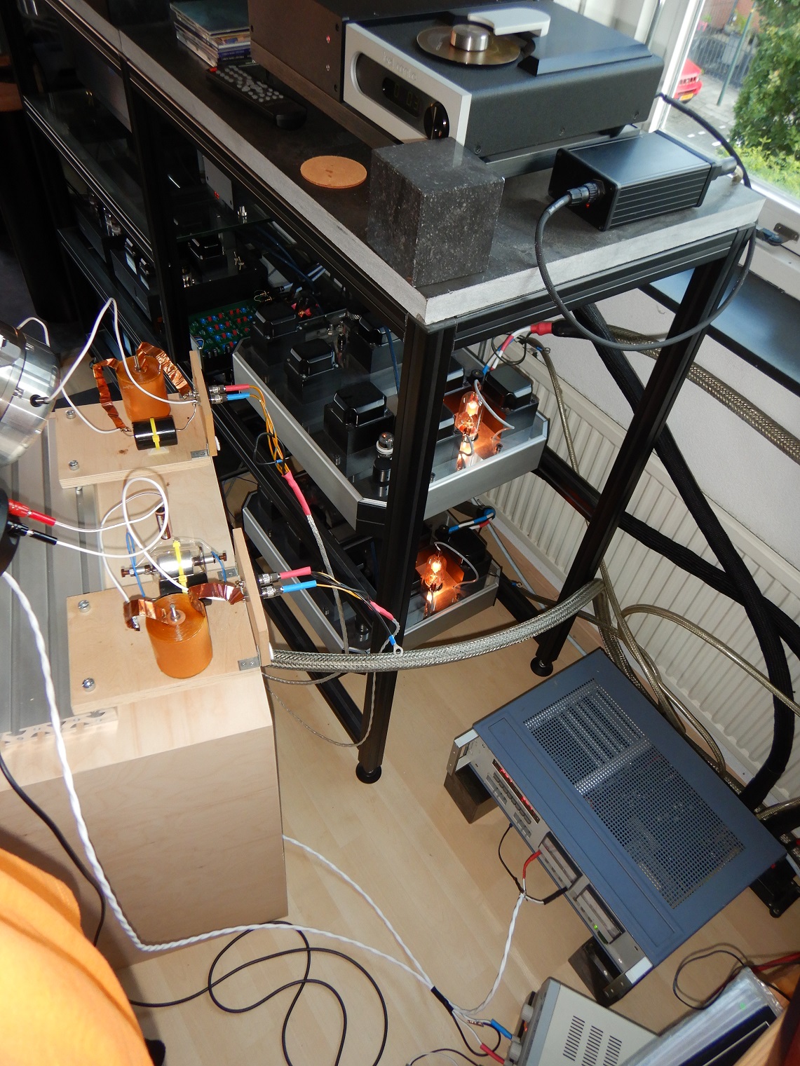

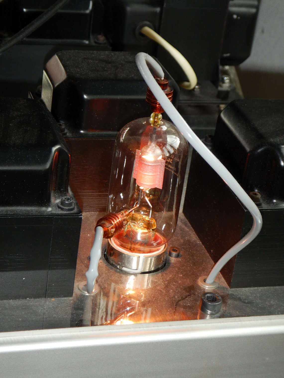

I've made an (A2, zero-bias, parafeed) amp with them years ago. Input/driver is a 6FJ7. Works very nice. It was designed as a full range amp but currently in use only to power the woofers.
Pictures included. And these are daylight pictures without photoshopping ! They become really red.
Currently i'm exploring the near equivalents (SFR E.556, HK54, UH35, DET18) but only the HK54 seems to be available; the rest is simply luck when you can source them.
Good luck with your built; they're worth it.
Regards, Reinout

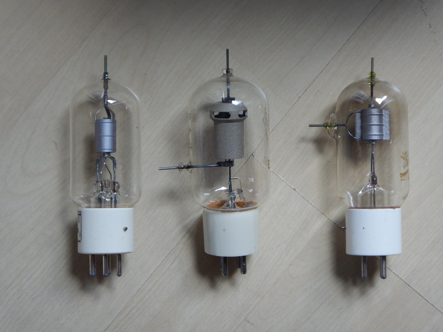

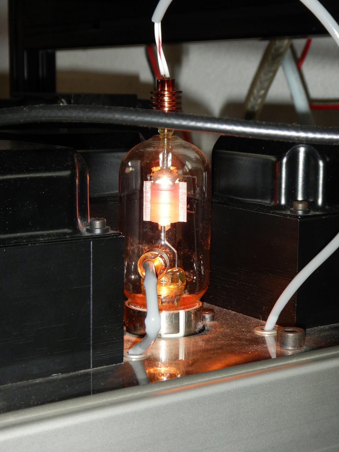

I've noticed that with the 100T variants I own, the older tubes have the finned anodes and they start glowing red at 60% or less of max dissipation. Newer ones were made of a different material and without fins. They don't begin to glow red until 85%+ max dissipation. I try to pick up the finned anode tubes when I can since they just look better.
It looks like one of your tubes has a graphite anode? I wonder how much color that one gives off compared to the others.
Good morning SpreadSpectrum,
got about 10 different versions of the 35TG:
- different anode structure (earlier ones only were cylinders whereas later ones were "capped"; mu changes from 30 to 39);
- different anode material (still metal);
- different fins;
- different sockets;
- different connection anode to lead-out;
And that is the same with the 35T.
The SFR e.556 has a carbon structure. No red anode while playing but you can look at the squirrel cage grid and the filament itself through the ventilation holes. Filament is very bright.
And although i'm not using your 100TH i've seen almost the same version with that tube as "my" 35TG's. Philips made them for a short time with a carbon anode structure.
All nice tubes. Sourced most of my stuff in the USA and like all tubes with these brittle (thoriated tungsten) filaments your chances of getting that stuff safely transatlantic is about 50/50. But if you have them and they're in working order they last for ages. I'm running my 35TG's for years now (about 10 ?!); still the same pair which i think is pretty impressive as i took these amplifiers also to some audio fairs.

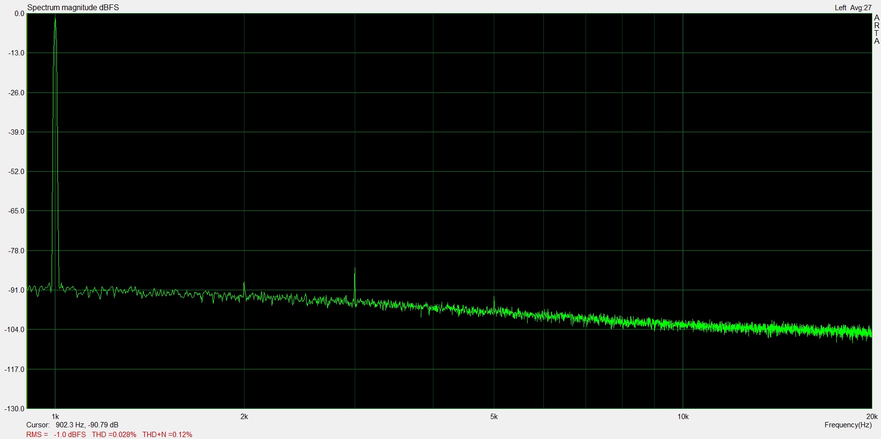

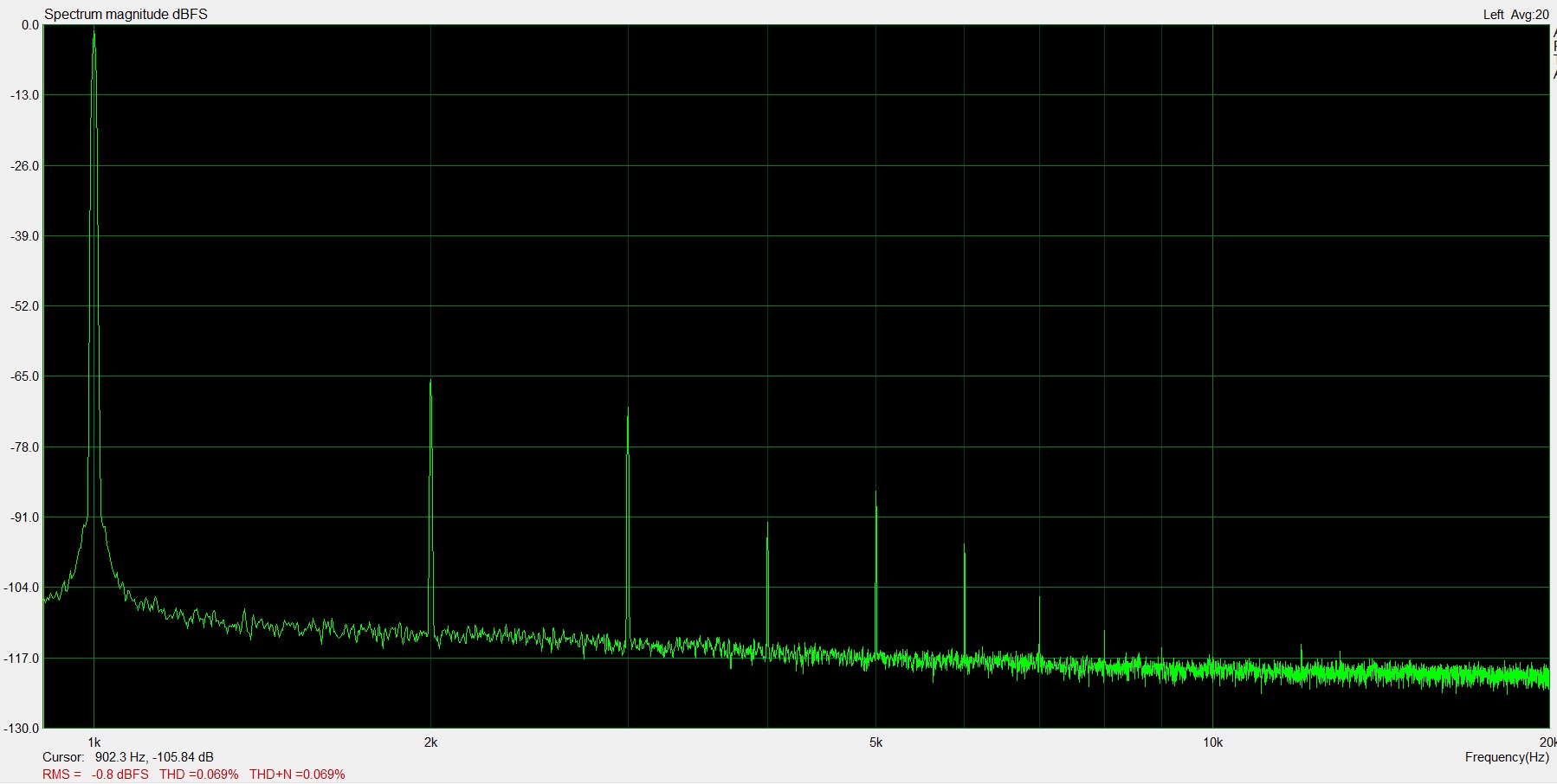

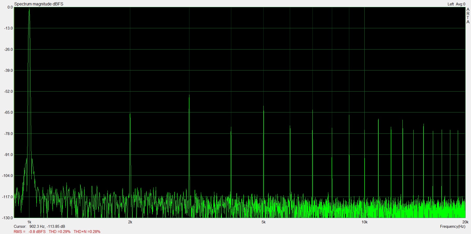

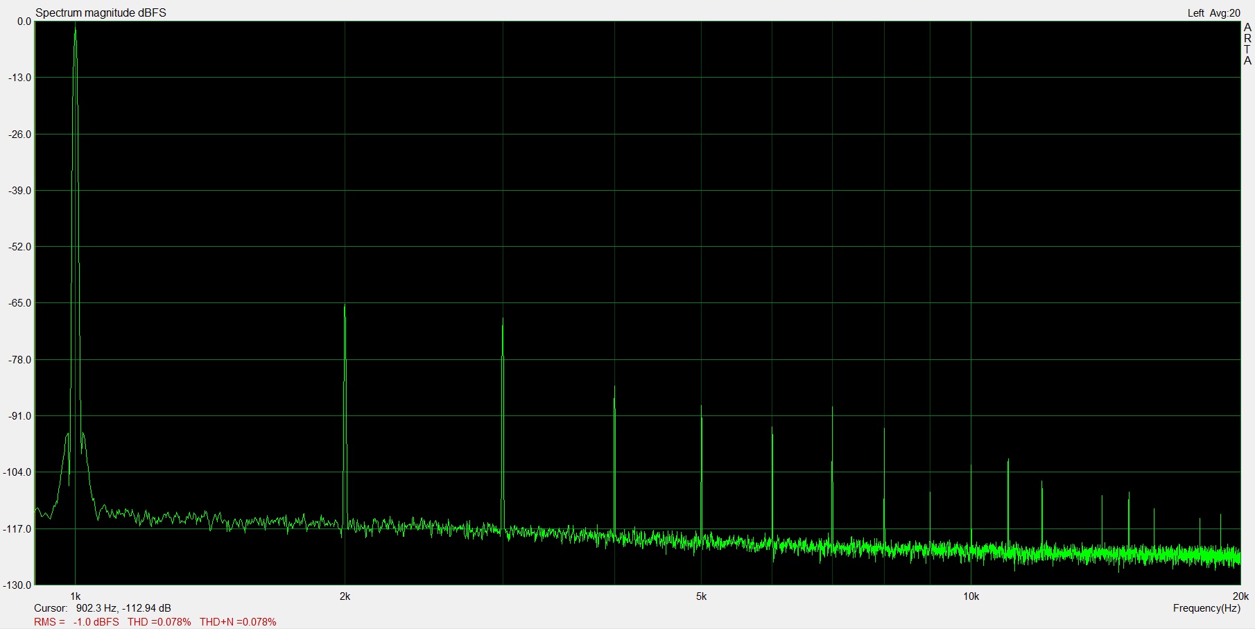

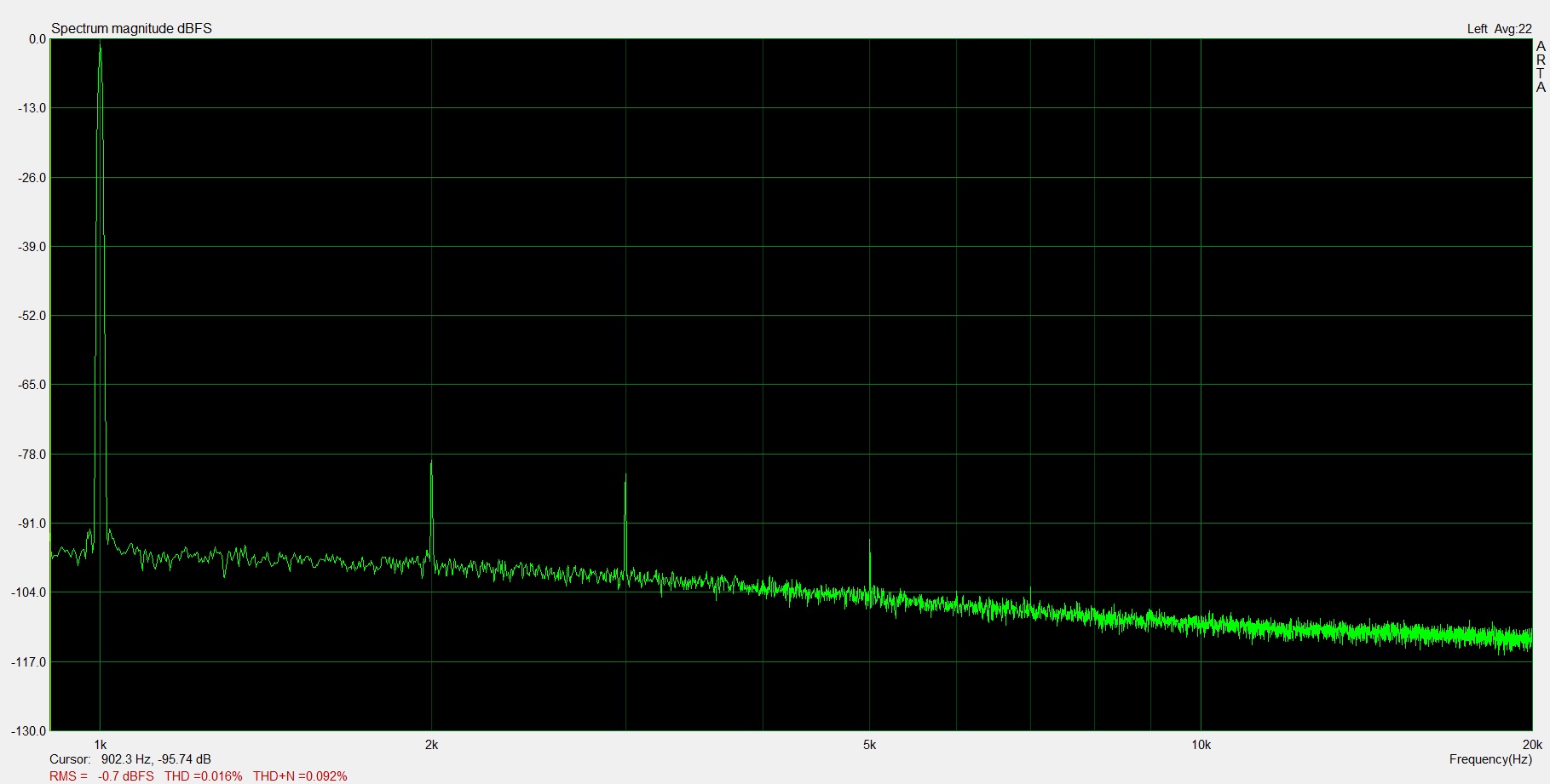

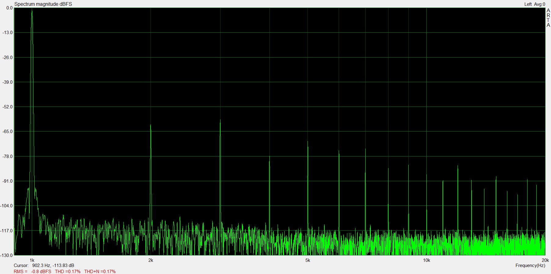

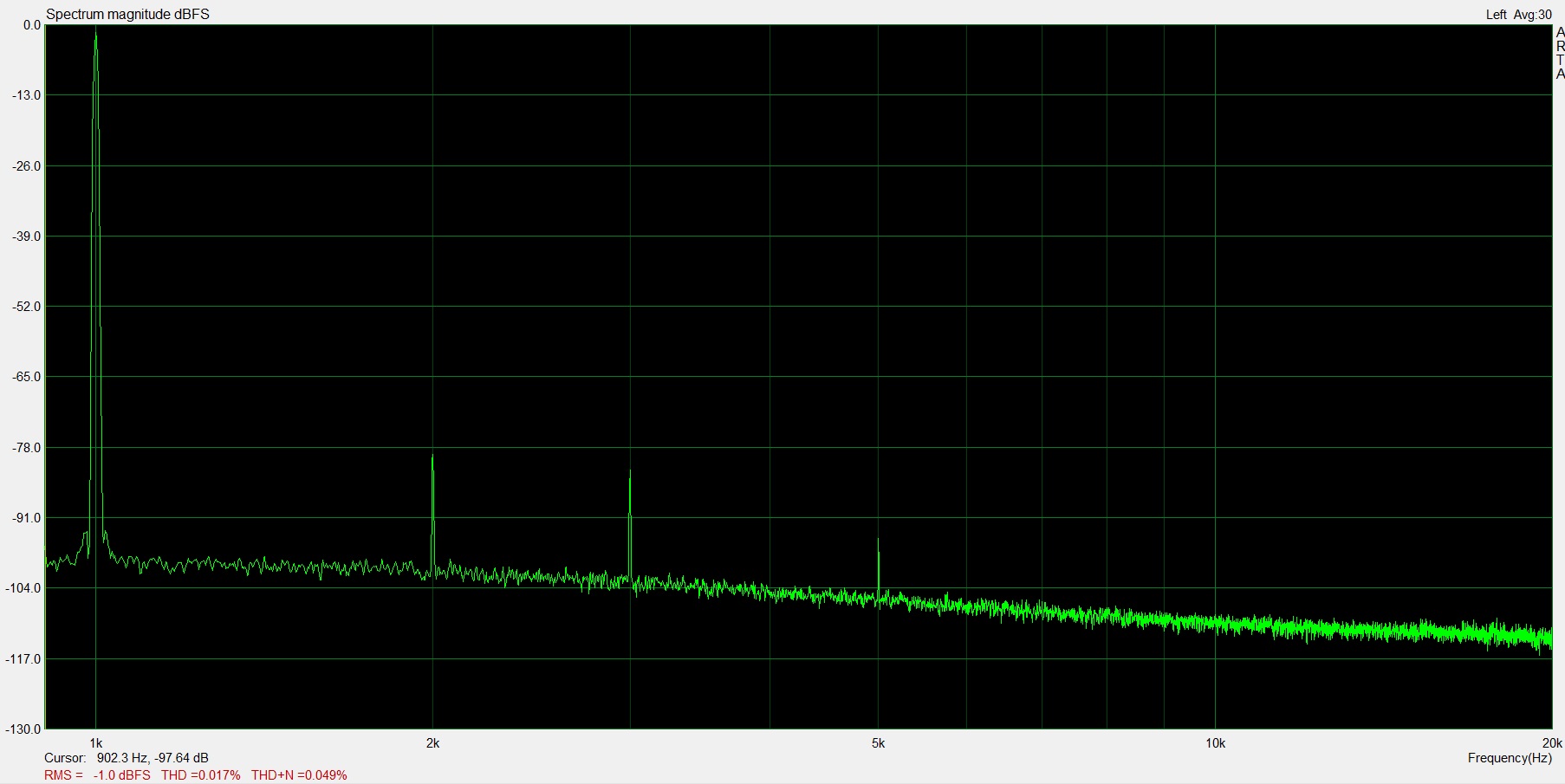

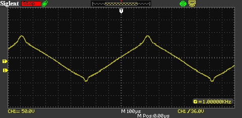

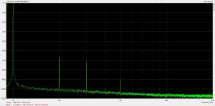

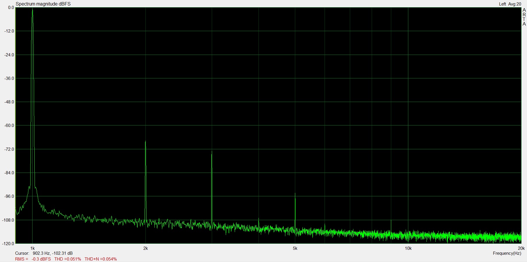

I finally got my Hammond power transformer and got the HV power supply up to 750V (125mA), which is where I want to run all of these 100T variants that I have accumulated to test.
First up was the 100TH. I've attached the measured results.
Summary:
100mW: 0.028%
500mW: 0.017%
1W: 0.021%
2W: 0.031%
5W: 0.051%
10W: 0.069%
20W: 0.078%
30W: 0.17%
35W: 0.29%
Clipping really starts at 35W, you can see sharp peaks starting to form on the 100TH grid waveform.

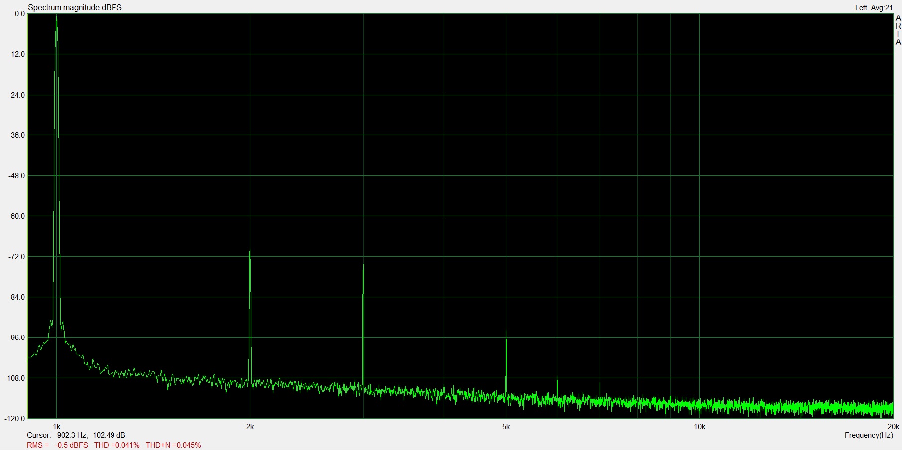

Results above are with an early Eimac 100TH with the finned anode. I tried subbing in another tube (a newer Lewis & Kaufmann) and got 0.020% @ 1W and 0.041% @ 5W.
So, results vary somewhat with the particular tube.
I plan on testing the tubes I have in order of gain, highest to lowest.
Next up will be 327A, then VT-127A, then I'll probably buy a Chinese 211 and see how that does.
