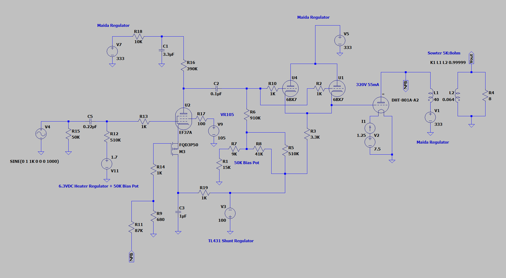

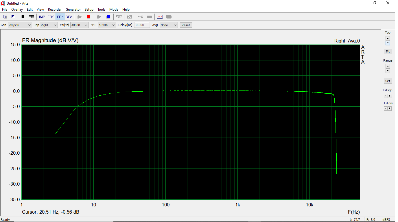

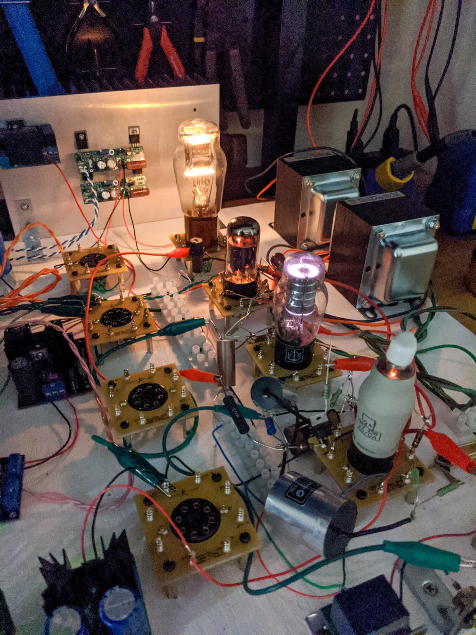

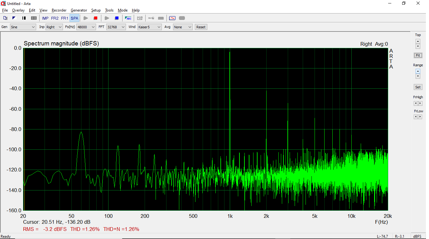

I made some progress on my 801A A2 amplifier using SpreadSpectrum's feedback methods. Since the circuit was going to need a breadboard anyway, I decided to put together a reusable prototyping board, I combined two projects into one.
I finished the board a few days ago and finished a single channel of the amplifier today. It uses plate-cathode NFB from the 801A to EF37A, buffered by a PMOS. The EF37A is loaded by a 390K resistor. The screen is regulated by a VR105 glow tube. Cap coupled to a parallel 6BX7 cathode follower, biased by a TL431 shunt regulated negative supply. It is direct coupled to the 801A grid, so setting the bias / cathode voltage of the 6BX7 biases the 801A. It is a near 0Vg1 bias point, comes out to around 320V 55mA. I think there is a schematic some pages back that shows the idea, I'll post an updated one at some point, but it has been a long day!
Output Z in this iteration is 1.7ohm, which is great, hit one target on the first go around.
Clipping starts beyond 6.3W into 8ohms.
THD is higher than expected, 1W into 8ohm spectrum below, which I attribute to the open-loop gain of the EF37A being much lower than simulated, so that is what I will be investigating next. The harmonic spectrum, however, is favorable, so even as is I feel confident the sound will be pleasing.
Here is the frequency response.
Between the thoriated tungsten filament of the 801A and the glow tube, it is a very glowy amplifier.
Lots more to do, but it's a start.

Not only are your finished products immaculate, but your prototyping is too!
If you want more gain for more feedback, that's not too hard with the CCS||Resistor trick.
Edit: Does this have the G3 bias on the EF37A to square up the knees? The harmonic profile looks good.

Thanks! Yeah I did mess around with the CCS load in the first prototype, at the time I was not using the PMOS buffer and was leaving the cathode degenerated. I will probably revisit it since I have this all built out, might as well get it right, although I'm not terribly concerned about the highish distortion given it is predominantly H2. More important for me was getting a low output Z. Based on the open-loop gain of the EF37A, this is with ~11dB of feedback, whereas I had planned to be able to apply ~15dB.
We'll see how it sounds, should be able to get the second channel done today and have a listen.
I haven't tried squaring up the curves yet, I figured I would seem how the harmonics play out with a resistive load, fortunately they look good! One other thing I did that I thought was clever, for a new guy like me: I had some Tent Labs heater regulators lying around from a project I never finished. I found these have very good line regulation and I needed a way to apply some grid bias to the EF37A to dial in the operating point, given the variable Vgs of the PMOS. So I put 6.3VDC on the heaters of the EF37A, then ran one end through a bias pot to the grid, worked like a charm

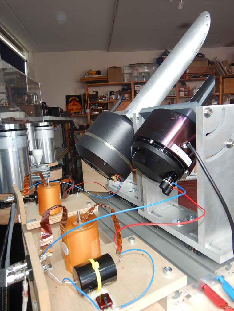

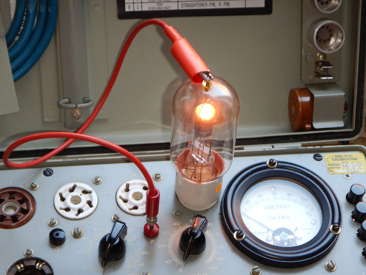

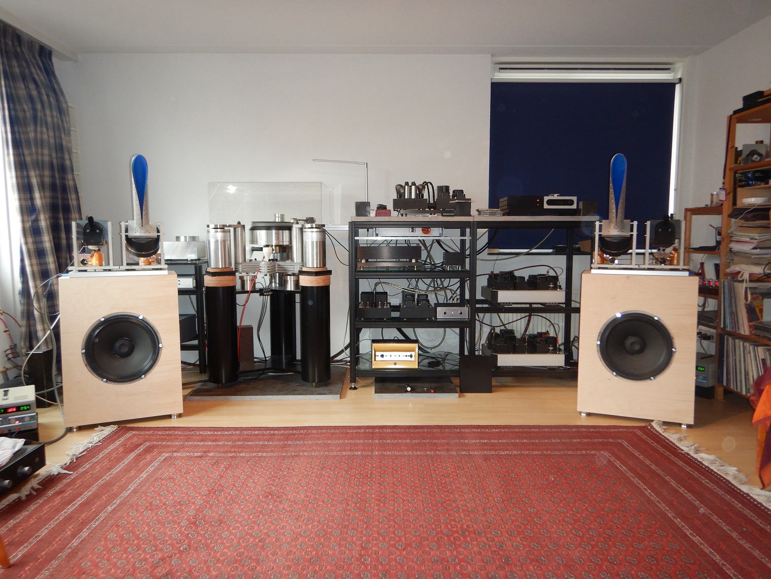

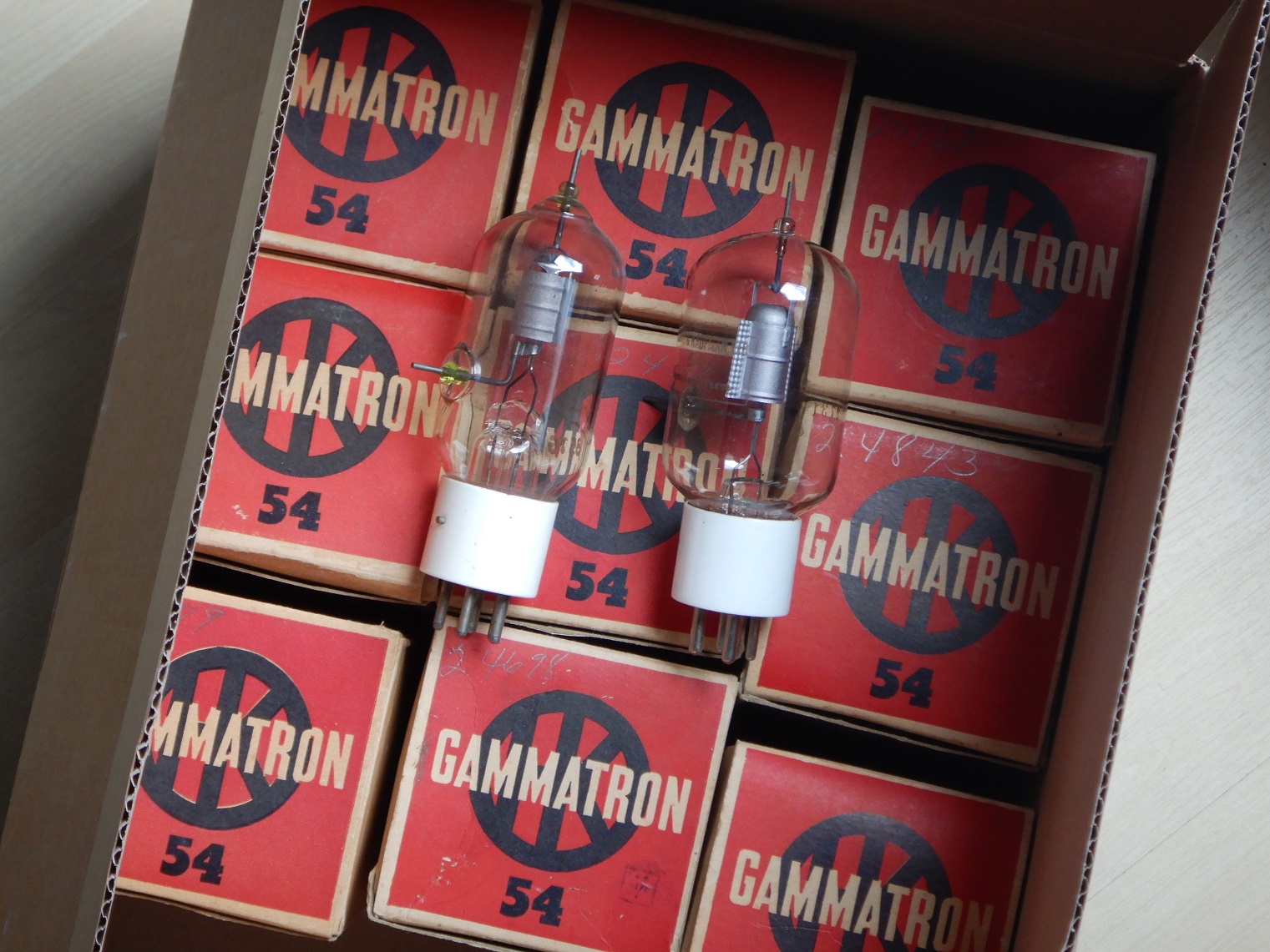

I use the eimac 35TG with much delight for years now. Not only they sound great; they last for ages ! Still using the first pair (not exaclty true because i broke one when in applied to much pressure to the grid or anode-connection). When they survive the transatlantic transport (50% crash for Gremlin reasons) they are workhorses for years to come.....
I LOVE the HK54, got my own stash of it (picture included with a 35TG and a 54HK side-by-side) as you can see into the filaments. Just as early 35T's and early 35TG's.

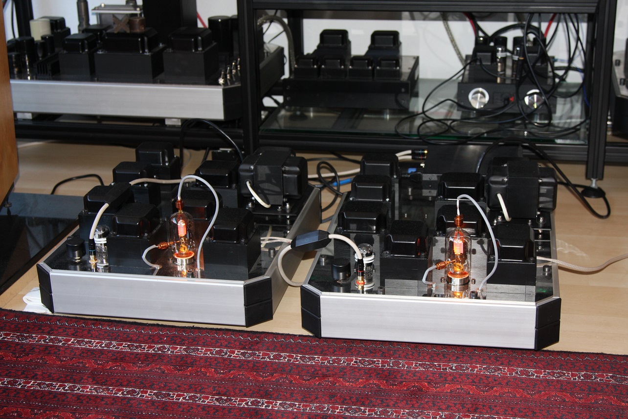

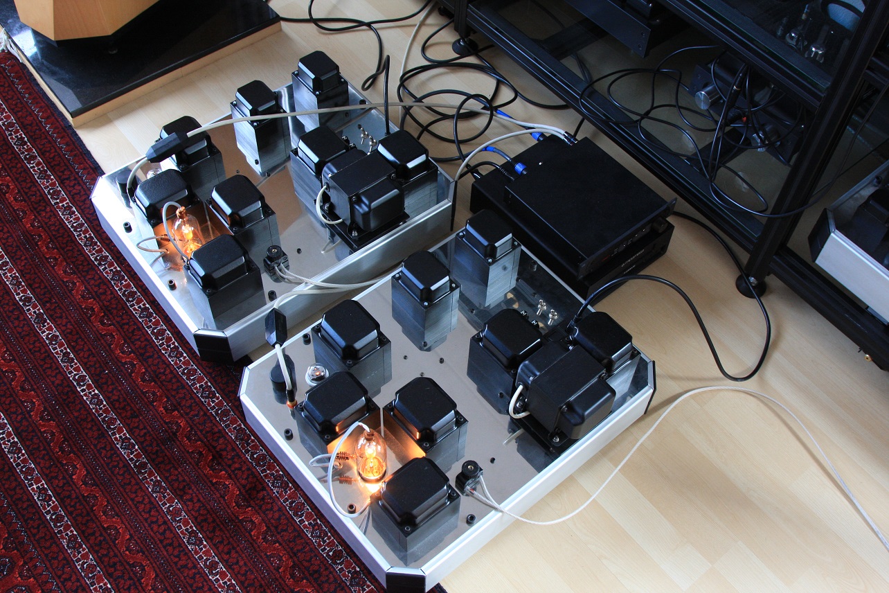

I run my 35TG's at 800V+ DC; completly A2 driven by a 6FJ7 trough a 4:1 step down interstage in parafeed-mode (A2 triodes like to see oomph...) .
Is everything A-ok ?! No.....of couse not this is an audio-adventure and currently these 35TG's are driving the bass-section only. Already got the new trannies for the amps (no air gap !) to get the max bass-response which is possible in parafed but first priority in my set set is a dedicated 1 watt amplifier for the highs (currently underway).

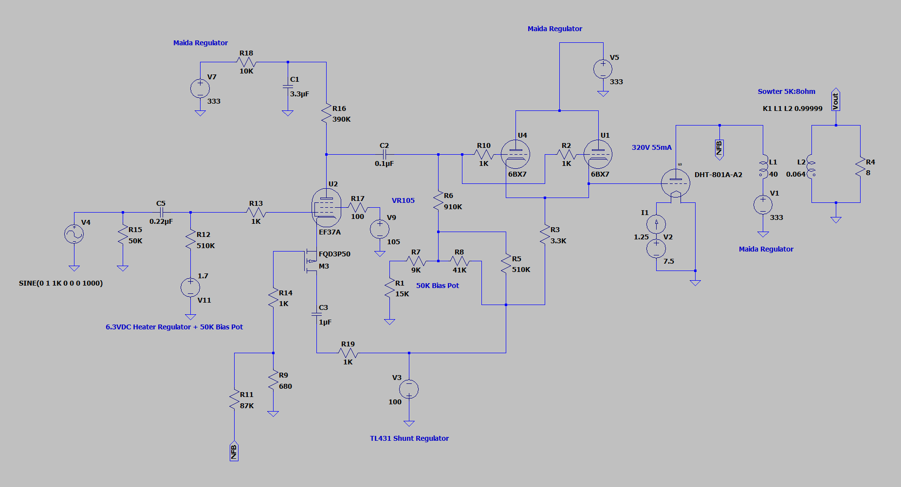

Are you sure, that M3 FET only AC coupled to the negative supply?Here is a schematic ...

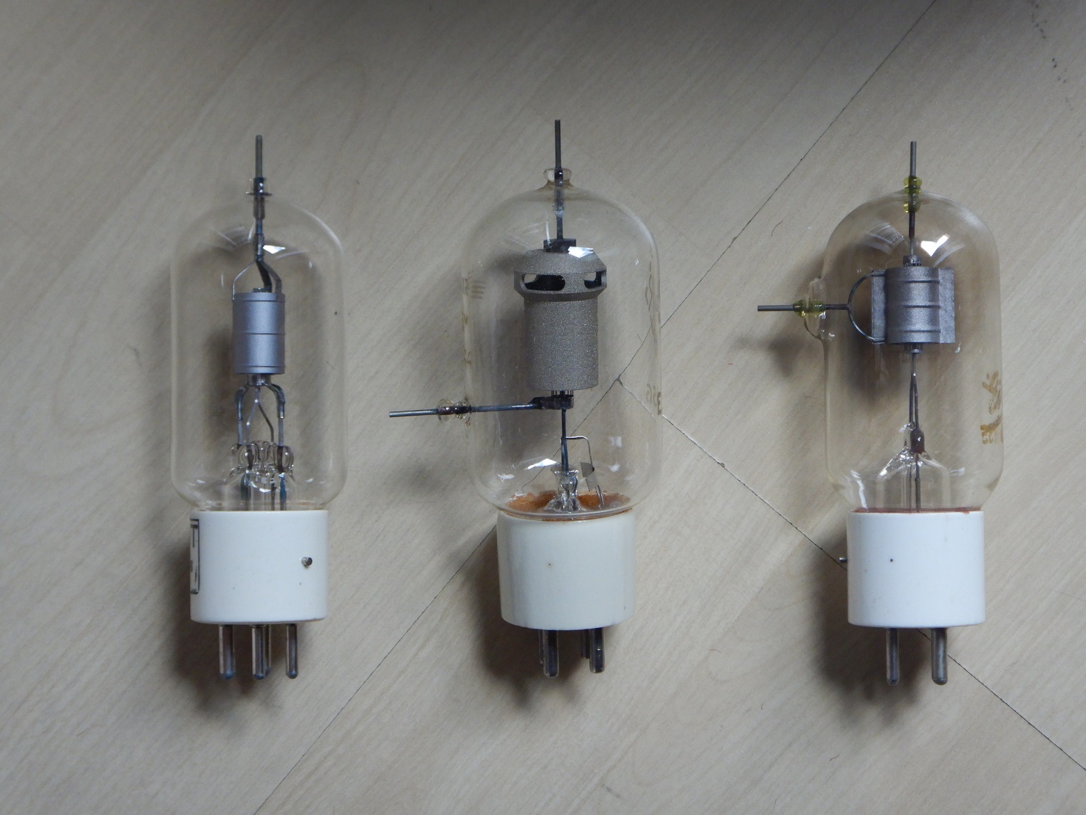

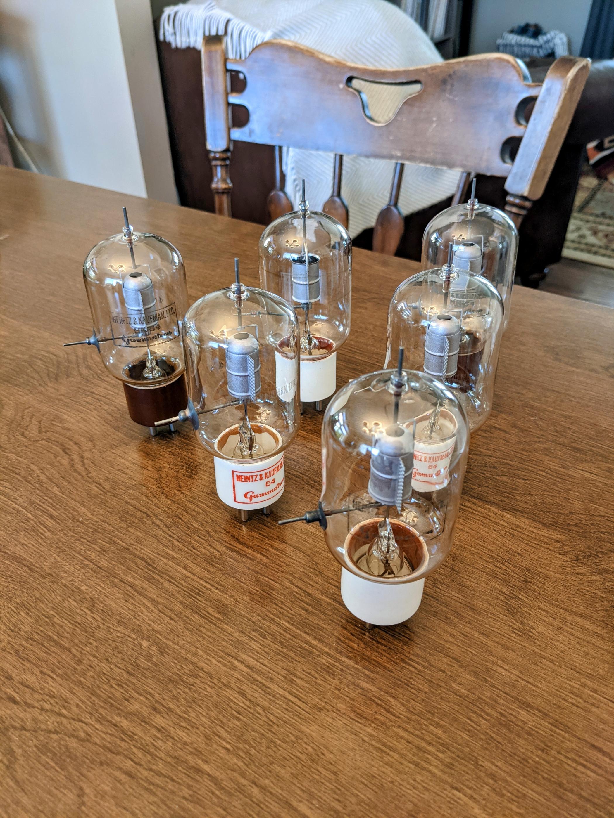

In my pictures (with the box of HK54's) you see a 35TG and a HK54 side-by-side.
These tubes are almost equivalent. Almost as the 35T(G) needs 5V/4A for the filaments and the HK54 wants to have 5V/5A. For the rest they are the same.
There are numerous incarnations to the 35TG and HK54. The "topless" versions are the early ones of both factories.
But there are other differences as well: different anodes (coating), differnces in application of the Uranium glass (sealing), differences in top-structure, etc.
Besides these known Eimac 35T(G) and Heinz and Kauman 54 there are others that produces these triodes with almost the same specs (near-equivalent).
Lewis produced the 35T also (but like all Lewis tubes seriously less in quality).
In the attached picture you can also see the SFR 556. A BEAUTY !! But i have only one (please please please....if someone has another orphan lets make this a pair....)
But also Eimac itself played for some time with this construction. See picture where you can see the UH35 on the right. Electrically the same but because of the heating the glass on top becomes overheated......which brought Eimac to the 35T/35TG where the anode-construction is lower in the glass.
Again, i have just a single/orphan...can somebody pair this to a second ?

Included a picture of a Lewis 35T (left), SFR556 (middle) and Eimac UH35 (right). Compare those with the much more common HK54 and 35TG in the other picture
