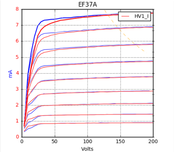

I tried the above with a 9V battery as a proof of concept. I measured it beforehand at 9.5 volts.
Here are the curves, red at 0Vg3, blue at 9.5Vg3.
Most pronounced improvement at low grid voltages, will be interesting to see how it affects THD in circuit. I measured the g3 current as well while taking a measurement, roughly 5µA.
A 9V battery has a 500mAh rating, so at 5µA draw, that's 100K hours. Meanwhile a 12V A23 has a 55mAh rating, and current draw will be higher, guesstimation 8µA, so roughly 7K hours.

You can kind of see that it causes some little kinks at very low currents, though, so you would want to be mindful if you ever wanted to operate there.

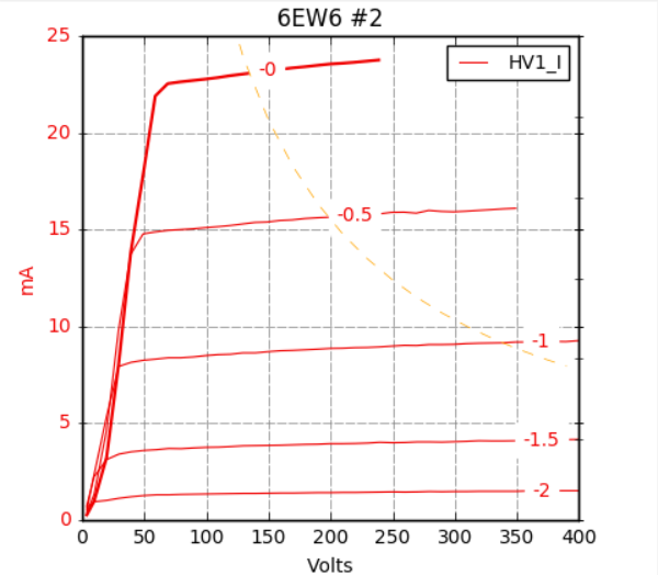

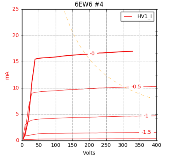

I grabbed some 6EW6 SpreadSpectrum, a five pack of Amperex-made. Interesting little tubes, didn't expect them to be so small.
I know they were not made for precision, but it's a good thing they are cheap and plentiful, the curves are all over the place . I was able to make one reasonably matched pair from the five. I wonder if the tolerances are better with different brands, I have a trio of RCA-made on the way as well, I guess we will see.

Unfortunately the differences can be large. If the tube labels are to be believed, these are Holland-made Amperex, typically high quality.

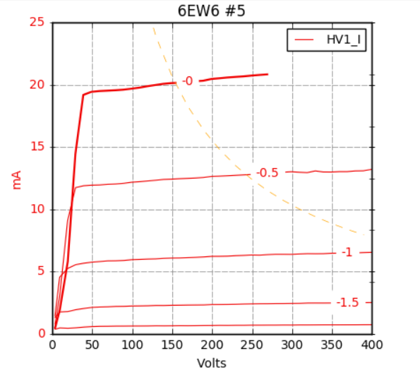

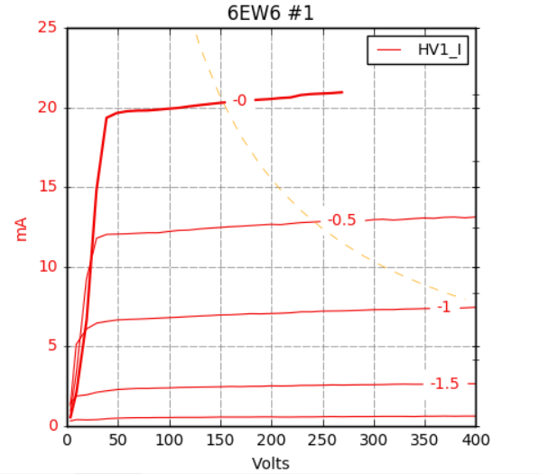

Here is some data. I measured gm for each tube at a 200Va, -1.3Vg1, 115Vg2. Difference in gm was 40% at worst, 7% at best. Wish I could say that 40% was an outlier, here are the measurements for each.
And the curves at 115Vg2.
Can't say if the same variance would be seen in a 6BN11 lineup, I would hope the sections would be somewhat well-matched at least.

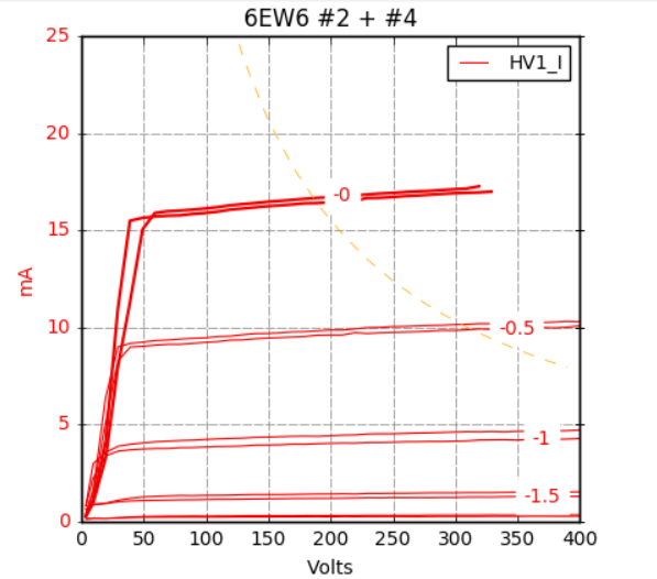

I gave screen adjustment a try with the most extreme example, tubes 2 and 4. I dialed down the screen voltage for tube 2 until the curves were a well-matched, then remeasured the transconductance at 200Va / -1.3Vg1. This put Vg2 on tube 2 at 83V vs. 115V on tube 4. Transconductance with the screen adjustment was 5111, compared to 5461 on tube 4.
Here the curves overlaid.
That's the most extreme example, so seems like a variable regulated screen supply would account for sample variation.
