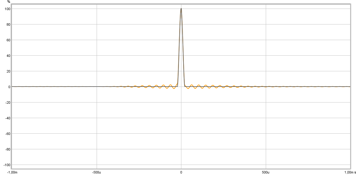

I use an RME FireFace 800 which provides an ASIO driver or you can choose how many WDM devices it exposes (up to a max 14 which gives you access to the 28 output channels). The RME device is set with a buffer size of 64 samples. The JRiver output device screen has a 50ms buffer set + "use large hardware buffers" checked + "device only uses most significant 24 bits" (as the RME driver is really 24 bit in a 32 bit wrapper so this makes jriver dither correctly)Thank you BRYTT and 3ll3d00d (wow, that's a mouthful!) for your comments. Sample rate switching could have something to do with it. The attached impulse at 44.1 kHz is pretty impressive. Can you describe more the settings in REW, JRiver and Windows to get that impulse?
I use either jriver wdm or asio depending on what I'm doing and just pick some unused output channels for REW. For example using ASIO;
REW
- output: ASIO Channel 7
JRiver
- ASIO Line In: 2 channels, channel offset 6 (i.e. is reading the RME asio channels 7 & 8 as its input channels)
- output format set to "no change" (i.e. no resampling, no jrss) and no dsp blocks turned on
RME TotalMixFX
- output channel 10 configured to output input channel 1 & loopback on (i.e. is routing the "L" channel output from jriver to output channel 10 and then looping that back to input channel 10)
REW
- input: ASIO Channel 10 (i.e. reading that looped back input)
You can use this approach with an actual mic & measurement to provide a timing reference btw.
When using jriver wdm, it is basically the same setup except for which devices are chosen. In that case REW is set to Java mode and to output to the JRiver WDM device, I have the WDM device configured as a 5.1 device so, with no signal processing applied in jriver, I get output down channels 1-6 (as REW sends the signal to all output channels). I set output channel 10 in totalmix to pick up any 1 of those channels and turn loopback on. The REW input device is set as the corresponding RME WDM device.
In the ASIO case, the sample rate is chosen by REW and everything switches automatically. In the WDM case, I have to make sure I pick the sample rate the RME device is configured as otherwise the windows resampler kicks in.
which behringer device is it? IIRC some of them have crosstalk issues when using loopback.As I described earlier, the best setup I was seeing was piping the output of the EMU physically into an intermediate card's input (Behringer USB I/O device) and then listening to that device using ASIO loopback in JRiver. I'd have to isolate the loopback through the EMU and then through the Behringer, but not sure what I'd do with that.
I think there is some miscommunication here. There is no scope for feedback in my loop. I was using the EMU card in REW and also setting the EMU card as the default in Windows (what you guys are calling the "unused" card). That's how the loopback in JRiver picks up the signal. The final playback is on an entirely different card. So, there is no chance of a second pulse.
Ahh ok that makes sense. I still find it odd that you're getting strange results with the loopback.
I'll have to do a dac/adc loopback with my interface run thru MC's loopback and see what I get. It's been quite a while but iirc it was fine. Either way if you have a method that works that's all that matters.
3ll3d00d thanks sharing details for setup, regarding what ra7 call pretty impressive IR wonder if is because analog I/O amps is bypassed so the loop is clean digital without a physical wire between analog I/O amps, something ala you have a switch in your "RME TotalMixFX" controlpanel that do the loopback.
What i mean is same as below that is M-Audio AP192 SPDIF I/O physical wired verse its analog I/O physical wired, clean digital is textbook IR as was its bandwidth DC to light-speed and calibrated analog I/O loop show bandpass.
yeah I would have thought that is the case as going through a AD/DA loop will naturally limit the bandwidth of the signalregarding what ra7 call pretty impressive IR wonder if is because analog I/O amps is bypassed so the loop is clean digital without a physical wire between analog I/O amps

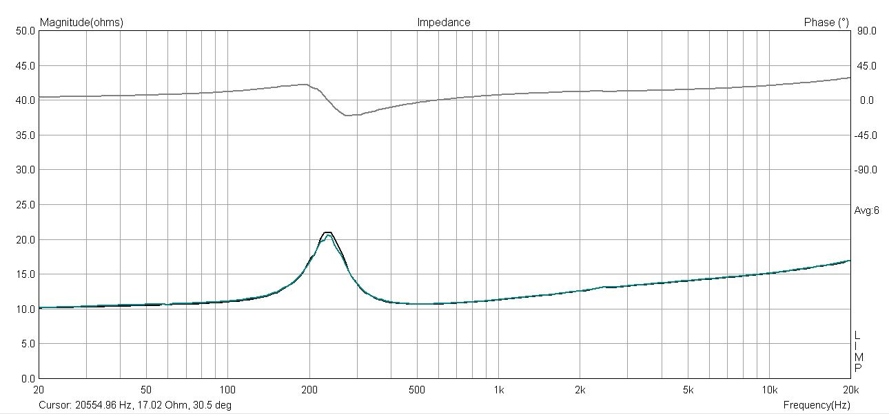

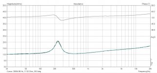

Impedance Measurements
Nothing much to see, except a high resonant frequency. Doesn't matter much coz the drivers are barely moving at 100 Hz. And they drop off like a cliff below 90 Hz. No other squiggles that might indicate cabinet vibrations or internal standing waves. And the impedances are well matched. Carpenter did an awesome job with the build. And Vifa did a good job with manufacturing tolerances. I am doing a great job listening to them right now 😀
Happy new year, everybody!

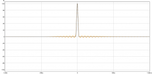

REW
JRiver
RME TotalMixFX
REW
Wow, that looks more complicated than my setup. It probably isn't. I tried again with using the JRiver WDM driver as output in REW and getting input from the EMU 0204 line in using JAVA drivers in REW. Output format is set to do nothing for 44.1 kHz and no JRSS. Convolution was off but the parametric EQ is on to map channels. I still get a funky impulse. I'm going to stick with my convoluted ASIO setup when measuring with convolution. To get measurements for EQ though, I am going straight from the EMU card to the amp.

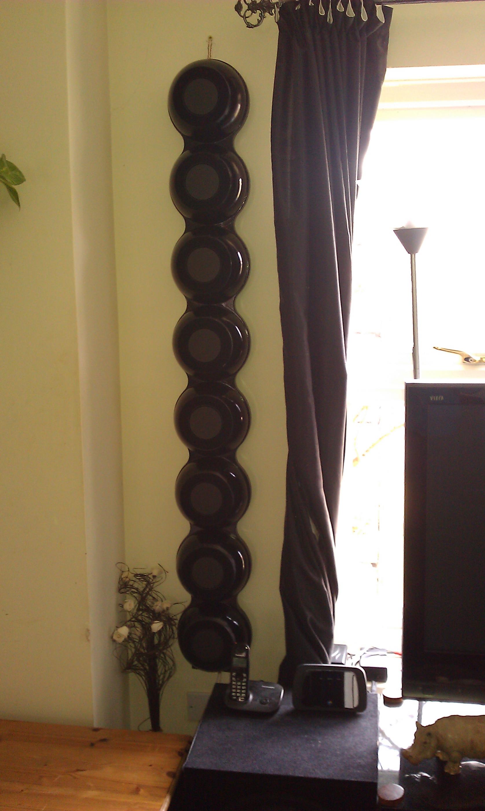

Despite your unwillingness to speculate (or mine ��😉 I do believe there is an important difference between planar/ribbon and array. BUT....I also believe it is entirely dependant on the specific design of the ribbon/planar.
From a purely speculative POV I note a number of things:
1/ If a floor to ceiling ribbon of comparable FR is operating perfectly under the control of the motor (pure theoretical case) then the physical displacement antinode is at the centre. This is of course before mass/motor control prevents this, and breakup occurs.
2/ Above the breakup corner, the ribbon radiation breaks into harmonic operation, like that of a simple string. Multiple antinodes distributed evenly across the length.
However, comparatively the ribbon mass is miniscule, so this mass limitation is also comparatively lesser than that of a cone radiator. I believe the more relevant factor for ribbons is the BL and getting flux high enough to maintain a (not pistonic but fundamental string type movement)
However
Isn't the goal for both ribbon and array, the same? Of course they are.
In a perfect line source consisting of a single driver, no break up should exist, and max displacement is at 1/2 line length and at all frequencies. The ribbon moves in unison at all frequencies, and the node of displacement exist at each end, where z=0.
In striving for a perfect line source, then it seems amplitude shading is an integral part of the goal
In the equivalent perfect line array of multiple point sources, then also no breakup should occur. Destructive interference still exists, on a fashion this emulates the harmonic string diaphragm type radiation antinodes and nodes of displacement.
I draw the conclusion that an perfect array will always display this combing, where as a planar/ribbon will not (or rather, the perfect ribbon will not)
However, its a little moot. Neither planar /ribbon or array of drivers will move all the diaphragm area in unison, at all frequencies of interest.
This is my biggest issue with arrays. To be as close to a single vertically large transducer, shading should be employed. (after all a perfect array is attempting to emulate a perfect ribbon).
It is also my biggest issue with convolution. I'm sure with work, a good dirac can be obtained in many cases. And by no means does that belittle the efforts some put in. But I question: Why bother? Why not shade instead. The end result is the same....and nearer to the theoretical ideal....it just seems like using a sledgehammer to crack the proverbial walnut.
However, I like the ingenuity, and this is exactly how iwould attempt such an array. (except id use shading...)
The horizontal directivity of the array is the directivity of the individual unit itself. With the B&G line transducer, its width is still comparable to the TC9 and I would fully expect it to go into beaming or breakup at a similar frequency. I don't want to speculate what happens to it in the vertical direction because I'm not familiar with the operation of the drivers. Does it still exhibit pistonic behavior? Or does it breakup into individual sources just like a cone or dome?

ra, good to hear about the percussion and such. Would it be fair to say you're noticing the corners giving you a consistency in the lower midrange where the 'baffle step' would normally be?
Mondo, if I may, picture a floor to ceiling array of full range drivers without any shading.
Next step, imagine what the floor and ceiling reflections do to the above image of the array.
Now picture that same floor to ceiling array with shading applied top and bottom.
Can you see how adding the floor and ceiling reflection of that one (with bigger movements of the cones in the centre) could be viewed as a problem?
At least in my head it works that way 😀. I picture the top one as one big continuous array with some shading due to attenuated floor and ceiling reflections.
The second proposal would form a wavy shaped array, again, all in my head.
Does that make sense? That's how I view the difference and why I chose not to shade my arrays. Well that, and some other reasons.
