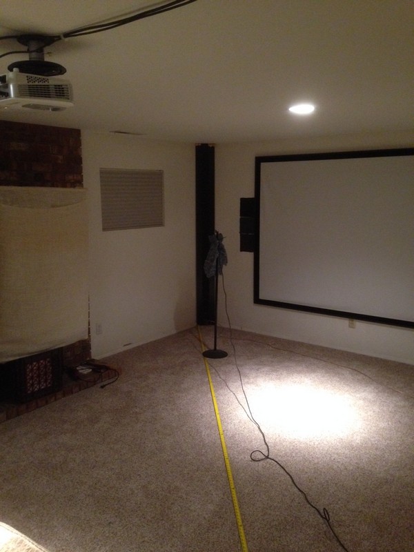

Line Array Height and Distance Measurements
So far, there have been a few questions in this thread about:
a. Comb-filtering. A line array with real drivers of small but finite size will always have comb-filtering. And this comb-filtering is audible.
b. The array response changes too much with listening height.
c. Shading is needed to extend the constancy of the beamwidth over a wider frequency range.
I made some measurements of the array in my listening room using REW. The files are in REW format and you can access them here:
https://drive.google.com/open?id=0By_atVLWB0a6TmVGTWNqMVl1ZFE
Just unzip the file and open it using REW. Individual measurements are named using distance, then height off the ground (example: 12 ft, 36 in.). Picture below shows the measurement setup. The way I did it was to setup the mic for a height and then measure along the distance, then set it for the next height and measure along the distance, and so on. The 0 in., 12 in., and 24 in. measurements at 12 ft are not super accurate in terms of distance because my mic does not go below 36 in. and I had to lay it flat along the ground to make these measurements.

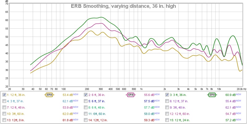

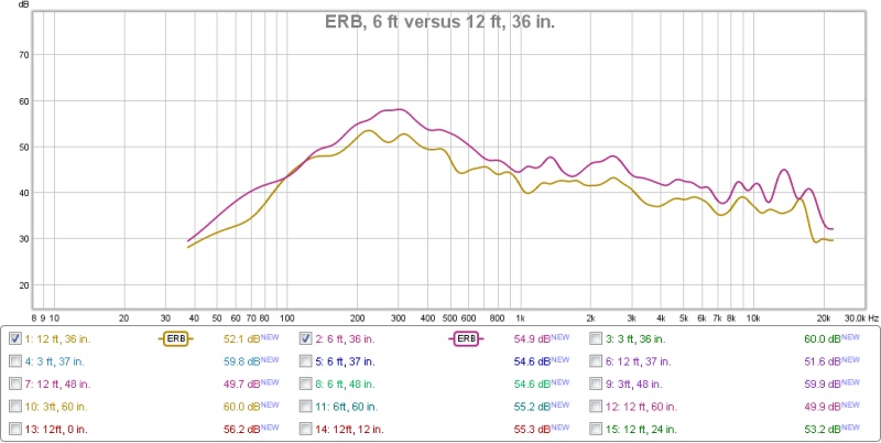

A. Comb-filtering
Let's look at the issues one by one starting with comb-filtering. The measurement below shows the raw (uncorrected) response of the array at 3 ft, 6 ft, and 12 ft and 36 in. above ground. The distances 3 ft, 6 ft and 12 ft represent doubling of distance. The measurement is 1/12th octave smoothed. At 3ft away, the "comb-filtering" begins just above 4 kHz. But by 6 ft, it has already smoothed out the response to about 8 kHz, and by 12 ft, there is no ripple at all up to about 16 kHz.
How audible is comb-filtering? REW has an ERB smoothing feature. Equivalent rectangular bandwidth is concept that helps us understand the frequency resolution of the ear. Thus a frequency response smoothed using ERBs is essentially what we will hear. The measurement below is the same as the one earlier, except ERB smoothing has been applied:
Again, a similar result is observed. Now, if you believe that what you are seeing is what you will hear then by 12 ft, the response has smoothed out quite a bit and lends itself nicely to correction.
How can we explain these measurements? Well, in Dave Smith's paper (linked earlier) he explains how in the nearfield (most home listening happens in the near-field of the array) the total response at a given distance is simply the vector sum of the magnitude and phase contribution of each unit. At smaller distances away from the array (3 ft in our case), the interunit spacing is comparable to the measurement distance. As we move away from the array, the interunit spacing becomes smaller as seen from the measurement point, and this pushes up the frequency where comb-filtering begins to appear. By 12 ft, the interunit spacing is negligible compared to the distance away from the array. At that distance, only the very high frequencies (with very small wavelengths) have appreciable phase shift from unit to unit to cause the peaks and dips. At lower frequencies, it is basically adding in phase.

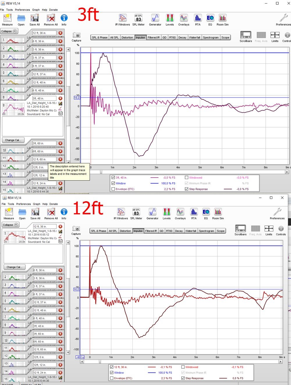

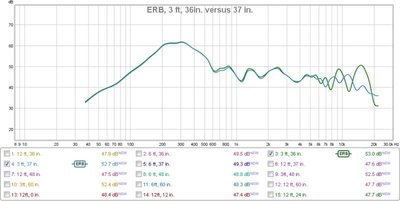

Ah, but you say that comb-filtering changes from one point to another. I made a measurement at 12 ft and 37 inches, just to compare to the one at 12 ft and 36 inches. They are basically the same! What that means is that the array response is pretty uniform along the vertical axis. More on this later. But if we look at the same measurement at 3 ft, then it's a different story. Key take-away: don't sit too close to your array.
12 ft:
3 ft:
12 ft:
3 ft:

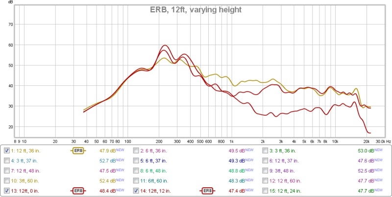

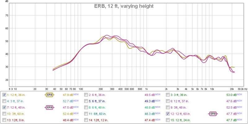

B. Response Variation With Height

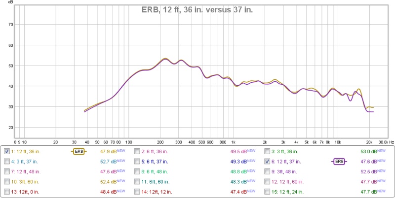

This one is simple. The measurement compares the response at 12 ft, for 36 in., 48 in. and 60 in. Note that 60 in. is the same as 24 in. off the ground due to symmetry. The response is very uniform at typical listening heights.
I did two more measurements at 12 in. and maybe 2 in. off the ground (labeled as 0 in.). I wanted to see if there was a deep cancellation near the ground and there was. The measurement compares the response at 12 ft for 36 in. (normal listening height) and 12 in. and 0 in. off the ground. Obviously, near the room boundary, the measurement gets wonky at low frequencies. But it still shows a very obvious reduction in response. This means the array is directional.
In the impulse response, there is no reflection from the ceiling or the ground. I have measured other corner speakers in the room, and there is a distinct reflection from the ceiling that is totally missing from the array measurements.

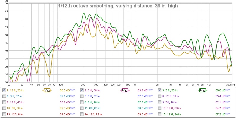

C. Shading
In the home environment, all we really care about is a smooth response near the listening position and vertical directivity to avoid floor and ceiling reflections. Keele's CBT array uses delay and shading to improve the constancy of the beamwidth and to improve the smoothness of the response. Keele describes clearly how his curved arrays use the ground reflection to improve directivity and smooth out the response. The previous measurements already show that the response is nearly identical at 36 in, 48 in. and 60 in. at 12 ft, which means we have a pretty uniform response within the central beam. The response is also quite smooth at 12 ft. The last measurement in the post above also shows the cancellation achieved near the ground.
The measurement below compares the response at 6 ft and at 12 ft for 36 in. The typical line array behavior of 3 db fall per double distance can be seen to extend down to almost 200 Hz. In fact, it extends well below 100 Hz, but not before some broadening at 120 Hz. I am not sure how valid the measurements are at these low frequencies, but above 200 Hz at least, there is a constant 3 db reduction with double distance. While this does not confirm the beamwidth, I am contending that because this is "typical" line array behavior, there is vertical directivity control down to at least 200 Hz. If we had seen a more rapid fall at lower frequencies, it would mean that the array has become a point source and so the radiation is omnidirectional.
Good work! Very thorough. The measurements at different heights tell us a lot about lobbing, or not. It looks much better than I expected from an array.
The overall response is a little surprising, but that's a different topic. 🙂

Thanks Pano! The variation with height is minimal. And it sounds like that too. There is no change in tone if I am standing up or sitting down. Though most of the listening happens sitting down.

Yes, very nice detailed measurments - thanks for taking them. I know the TC9 so well and so I am very puzzled by why there is a -15dB falloff from 300Hz to the HF's? That driver is flat with the usual baffle step falloff which would make it go up at HF but you are in a corner so no baffle step here. Is it corner loaded V "horn gain" that is giving you the 300Hz boost? Must be. I guess a simple V horn model in Akabak with an array would probably show this.
No, that is typical line array response. There is a boost in the low frequencies where the summing is 6 db per doubling of area, and higher up, it sums more like 3 db per doubling of area. I think the driver's inherent response has something to do with it also. A 3.5 inch driver becomes more and more directional in the HF (see Art's measurement of the TC9 a page or two ago). There is some corner again too, probably the reason for the 300 Hz peak.
Clearly, the overall response is troubling for people. This is of course not the final response. The final response is corrected by DRC. I could correct it manually in rePhase or in JRiver. But DRC does a much better job.
EDIT: My cabinet size also results in an underdamped response, so there is a small boost below 200 Hz, I think.
