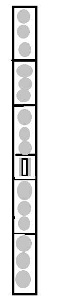

My corner line arrays might be 2-ways, multiple 4" cones and a single Fountek Neo 5i or 3.5H at ear height... Array enclosure divided in cells of 3-4 stacked woofers. Products_Fountek Electronics Co.,Ltd

Juhazi, I see what you're doing, I get what you're planning on doing, but still I wouldn't (didn't actually) do it.
Your proposed array here has certainly been tried before many times. maybe not in a corner but in my humble view you would miss out on a large part that makes this floor to ceiling array work.
But if you do decide to do it, I know many viewing a thread like this, or my thread for that matter, might start thinking about building floor to ceiling arrays and I can't blame them. I'd even encourage that. Know this before you start: pick the right driver for the job.
That may work very well if the XO is 5k then all the comb stuff in the sims won't be there. However you will have sound integration issues with the different locations of the mids at the extremities vs where the tweeter is.
Juhazi, something like that has been tried before. I tried an expanding array myself:
http://www.diyaudio.com/forums/multi-way/258246-corner-expanding-line-array-kef-q100.html
Your problem will be C-to-C distance at the crossover. You could try to roll off each outer element progressively lower in frequency. That would be similar to the expanding array. In fact, that is exactly an expanding array. If you don't roll off the outer elements, the C-to-C distance between the outer elements and your tweeter will be too large at the crossover point. I tried to get around the C-to-C problem by using a coaxial driver.
All these problems just go away with an array composed of identical elements radiating the entire frequency range. You don't want these elements to be too big. If your element was 7 inches instead of 3.5 inches, I'd guess that comb filtering would start one octave lower. Also, you'd get tremendous beaming. If you keep the element size relatively small, it all works out. That is where the TC9 driver really shines. It has a smooth response to begin with, a well-designed motor, uniform off-axis response (see Art's measurement earlier) and is cheap to boot. What else can you ask for?

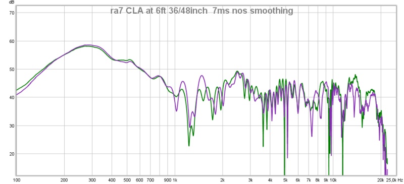

I am puzzled why everyone is so worried about ...WWWWWTWWWWWW.... lobing but not FFFFFFFFFFFFFFFFFFFFFFFFFFFFFFFF... lobing!

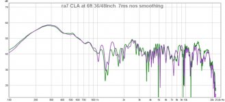

I´d like to see some real world measurements of the first like ra7 showed of his CLA.
And here is his line at 6ft unsmoothed 7ms IRgate (like we look at 2/3ways integration/lobing) I am puzzled about that 1,3kHz dip, that should be pretty audible and it lies at a very sensitive range...

Now why would you look at plots of a raw measurement of an array at 6 feet if the proposed listening distance is double that and EQ is part of what makes them work?
You'd miss all the integration that the line array has to offer at the right listening distance and to judge it I wouldn't run it without the needed EQ.
This isn't a 2/3 way in any sense and generally speaking you don't measure them up close. Forget about that multi way view for a moment. This is an entirely different animal. With that difference there also comes in a different set of rules on how you should deal with that animal. You can't compare it to that 2 or 3 way and measure up close to decide on certain things. That's heading for a disaster.
Just to be save I just viewed an unsmoothed but corrected frequency response IRgated 7 ms at the proposed listening distance and this shows me no such dips at all.
Now if I were building a 2 or 3 way with the experience I have building the arrays I'd do it a bit different than what you propose as standard practice. But that's an entirely different discussion that I won't start here.
I looked at my left and right speakers and neither of them show any such dips. I'm sure by the time ra7 finishes his processing we could come back to this point and prove it. But for obvious reasons at the listening distance.

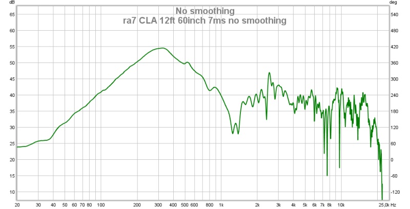

My listening distance would be around 9ft..
Here is ra7's CLA at 12ft 60inch height. The 1,3kHz dip is hard to eq...
So, we must have different assessment criteria for LAs and conventional speakers? Just trust ears?
No, I wouldn't trust my ears. I do trust my plots, many of them. But like I said, different discussion. Now why do you think you should be away from the array at certain distance to fully enjoy what they do well? I bet you could answer that question yourself.
While floor and ceiling reflections are absent, other reflecting surfaces still count. There are all sorts of reflecting surfaces in my room. At 12 ft, I'm reasonably close to the opposite side wall, so that could be a reflection from the sidewall. The point of the measurements was not to look at gated HF frequency response, but to understand the vertical performance and the change in response with distance. The measurements should be looked at in that context. I can show you the corrected absolute response at the listening position. It is quite smooth. But I'll also tell you that I am trying to find sources of certain reflections and eliminate them with Wesayso's help.
