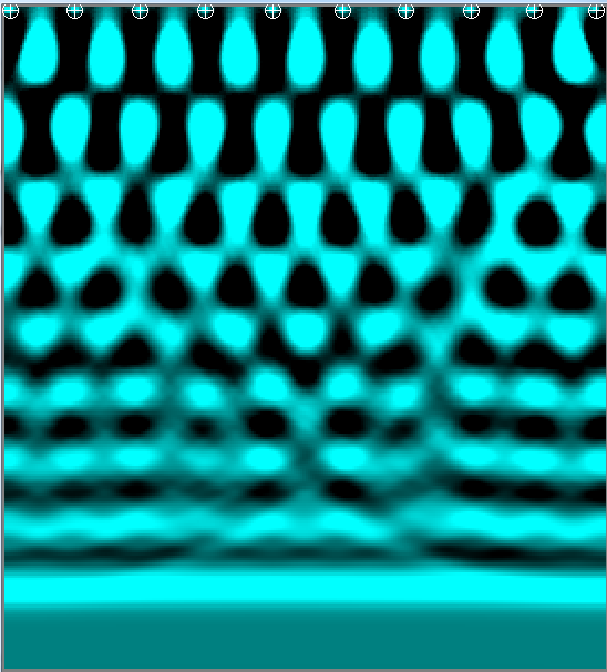

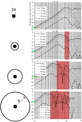

Have you thought about what is the source of the null? It is a question of sound sources adding according to their magnitude and phase shift. When the phase shift is 180, you get a null. Now, how might this look for 25 sources summing at a point more than 12 feet away? Can you get a null at 1.3 kHz from such a scenario? I don't think so.
In Speaker Dave's paper on line array theory, he examines the situation at 90 degrees from the array's main listening axis, i.e., imagine looking at the array from the top. From that angle, the interunit spacing is the highest. Depending on this interunit spacing you can get a perfect cancellation at a frequency where the interunit spacing is exactly half wavelength. You will get a perfect sum at a frequency where the interunit spacing is exactly one wavelength, i.e., phase goes through one cycle and then the second units adds in full with the one ahead. This is the worst case scenario. At normal listening distances and normal listening axis, the interunit spacing becomes negligible and because there are 24 drivers and you are sitting away from the drivers, the phase shifts are completely random and you get less than perfect summing, but summing nevertheless.
So, no, I don't believe it is a null because of finite dimensions of the speaker. At least, I don't see any relationship yet. Again, I appreciate you putting forth a question, but let's not get ahead of what we know at this point.
Maybe you have a lot of experience with nulling in OB speakers. Yes, it is a big problem that must be overcome in that design. But I just don't see how it can apply here.

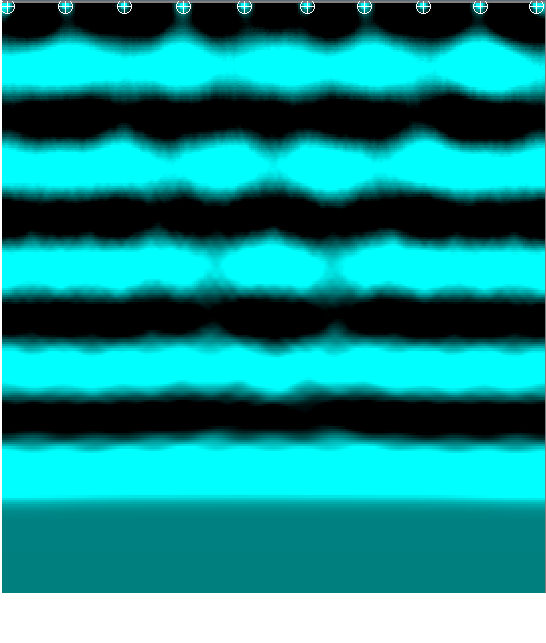

A continuity of pressure regions, ie that which defines the wavefront shape, can be seen to be appropriate where this shape fits geometrically with the physical (wall) constraints that are present, otherwise it may be seen to be in conflict with the walls.
No differently though, any virtual plane (or asymptote thereof) normal to the wavefront and located somewhere between the physical walls should also conform this way, or the wavefront fails to maintain the support which keeps it running true, and higher order modes will result.
These two sims are identical except for a slight difference in frequency.

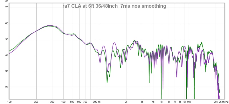

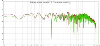

I´d like to see some real world measurements of the first like ra7 showed of his CLA.
And here is his line at 6ft unsmoothed 7ms IRgate (like we look at 2/3ways integration/lobing) I am puzzled about that 1,3kHz dip, that should be pretty audible and it lies at a very sensitive range...

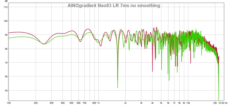

For comparison my AINOgradient speakers at listening position in my room, same 7ms gating and no smoothing to show nulls of interferences. The dip at 250Hz is ceiling reflection i guess. 1,7kHz dip is frontwall hitting back.
Your AINO gradient:
vs things to come for ra7 (my line arrays, left and right 7 ms gate, unsmoothed)
Now where did that pesky dip go... 😉

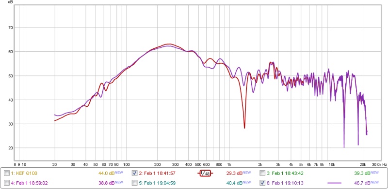

By the way 7ms does not work well for me as I do have a reflection before that. This is a listening position measurement and my back wall behind the mic is simply too close.

After being away for a while, I finally got a chance to investigate the cause of the dip pointed out by Juhazi. It is coming from the projector screen edge that is on the front wall. Here is a measurement with the projector screen on the wall, and then off the wall (placed to the side; it is so big that it is not easy to move it around).
So, there we have it. The dip is not a function of the line array, or the size of the driver, or interference between units or any such thing. Hope that answers Juhazi's question. As shown by Wesayso, it is not present in his array either. This, and the fact that the dip goes away once the projector edge is moved away should be enough to show that the dip is not a feature of the design.
I do need to find a way to mitigate it. Maybe with some foam on the edge or something similar. The projector screen is certainly not going anywhere.
EDIT: The earlier reflection in the second plot could very well be the screen edge that has been moved further away but along the wall.

Frank,
I am still in the processing of removing the reflection mentioned above and maybe it is best not to rely on the current correction supplied by DRC. Though, I have to say it sounds pretty damn good. I will post the correction when I get to the next stage. Thanks!
Thank you ra7, damn these room measurements!
I find it strange that a projector screen makes such a strong reflection, obviously it has a solid frame. Perhaps you can construct a fake wall panel (flap) that covers that part of front wall and prevents sound waves hitting the frame?
It's such a narrow sharp dip - do you actual hear it with your ears? Maybe add some foam on the edge and do your best and call it a day.
