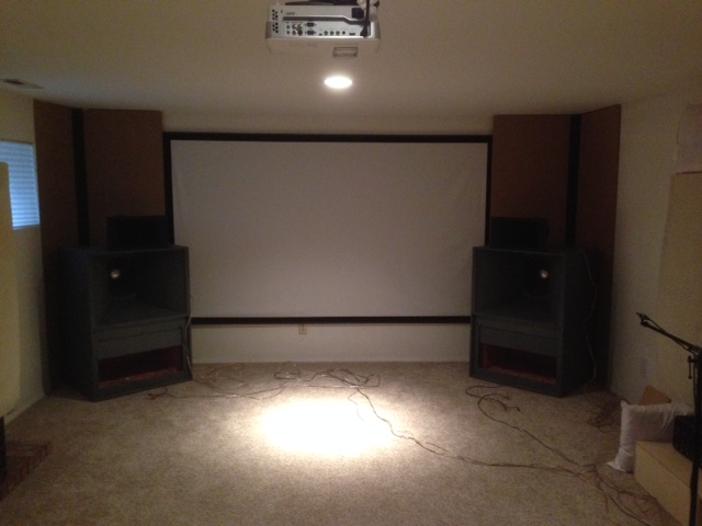

Two flavors of Paradise
I recently met a guy from work who is also interested in horns and he is going to take my VOTT cabs and the drivers in them. He is not that familiar with crossovers and such, and so, in order to help him out I setup the VOTTs with the Altec 421 woofers in them and on top JBL2445Js in 2380 replica horns.
It sounds fantastic! Using the old but trusty miniDSP 2x4 board, I setup a simple LR48 crossover at 750 Hz and a delay for the top horn. It works pretty well, i.e., phase tracking is good and both sections seem to like that crossover point.
Just this crossover and some light EQ in miniDSP to get the tonal balance right already sounds quite good. After adding FIR correction in JRiver, it sounds very similar to the line arrays. It is just a different flavor of paradise.
Some differences between the arrays and the all horn system:
1. Mid-bass: Even after DRC correction, the mid-bass is not as well defined and clear as the arrays. This is where a lot of musical information is located and the arrays just sound better.
2. Instrument sizes: The instrument sizes are smaller compared to the arrays. Some might prefer it, I don't mind it; it's just different.
3. Depth perception: I have to admit, begrudgingly, some recordings have better depth perception on the horns than the arrays. The illusion of depth is easier to believe on the horns.
4. Overall musicality: Here the arrays win hands down. The tone colors, as Lynn Olson would say, are so much more vivid on the arrays. The horns are sort of an overexposed photograph -- some of the subtle details are blanched out. I feel this is a combination of the uber low distortion and the superior mid-bass of the arrays. The meaning of the music, the groove, and the connection is deeper on the arrays.
So, there's my unsolicited review. I could easily live with the horns. The arrays occupy much less space though.
I am sad to see the VOTTs go. It's the end of an era. But I am happy that someone else will get to enjoy them rather than them sitting in my basement unused.

Nice review ra7 - and good thing the VOTTs found a home where they are going to get enjoyed. 🙂
Also, very good point you make on the importance of mid-bass in the overall listening experience - "musical" systems usually have better mid-bass articulation among other qualities.
I have been pondering the question about depth myself. What is different between the arrays and the horns? Vertical dispersion of the arrays is better controlled in the mid-bass. And the horizontal dispersion of the 2380 replica does not narrow with increasing frequency unlike the Vifa TC9, which will start beaming at some frequency. How does that result in better depth perception? I don't know. What I do know is depth perception is very much linked to dispersion and reflections and their relative timing and strength. My gut tells me delayed strong reflections produce impression of depth.
