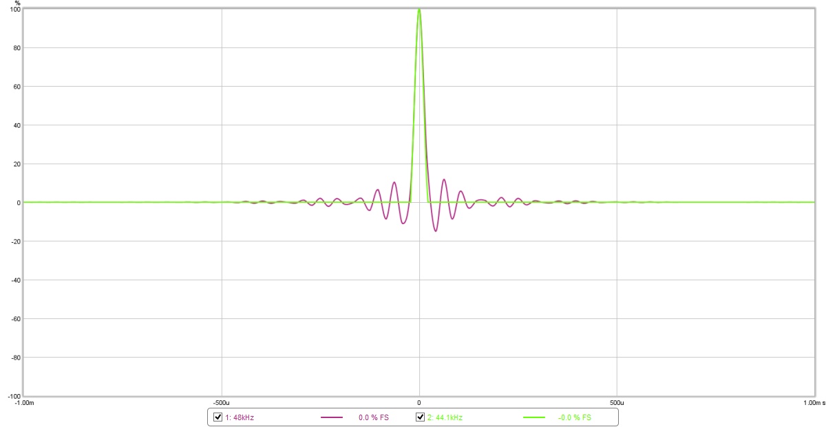

Had also been exercising with the setups as natehansen66 and wesayso talk about, and what helped for my setup to give best IR precision from sweep to sweep and most staple low distortion from sweep to sweep was manual setting all involved hardware/virtual sound devices to same samplerate in Windows sound controlpanel for I/O devices. Know Windows can do SRC that works, but if at first before a measurement i set up involved hardware and JRiver virtual device to lock to same 48kHz and ensure REW Java is also set to 48kHz plus ensure JRivers SRC container plugin is not converting anything setup gets staple. Also in miniDSP USB controlpanel from THESYCON can imagine the USB Streaming mode setting could be worth try some tweaking.
I think that's a good call, to illustrate a loopback from my system (using jriver wdm) if there is sample rate disagreement. Completely clean impulse vs the ripple from the resamplerHad also been exercising with the setups as natehansen66 and wesayso talk about, and what helped for my setup to give best IR precision from sweep to sweep and most staple low distortion from sweep to sweep was manual setting all involved hardware/virtual sound devices to same samplerate in Windows sound controlpanel for I/O devices. Know Windows can do SRC that works, but if at first before a measurement i set up involved hardware and JRiver virtual device to lock to same 48kHz and ensure REW Java is also set to 48kHz plus ensure JRivers SRC container plugin is not converting anything setup gets staple. Also in miniDSP USB controlpanel from THESYCON can imagine the USB Streaming mode setting could be worth try some tweaking.
Using ASIO should be the simple way to avoid this though (as then the windows sample rate conversion is not in play). Mind you yours looks sharp enough but is surrounded by some other fuzz/noise, have you looped back the device alone to isolate the device vs jriver?

Thanks that IR plot.
.....Using ASIO should be the simple way to avoid this though (as then the windows sample rate conversion is not in play).....
Also as with ASIO WASAPI is much more simple and audiophile with its exclusive hardware access and seems not bad, but for the measurement situation the two programs to at same time have exclusive access ASIO/WASAPI is problem.
Own experience so far is if a interface has ASIO driver that work okay it also performs better in loopback distortion measurements than WASAPI and Windows sound system.
yeah it's handy to have a multiclient capable asio driver or you can try the steinberg multiclient proxy (https://www.steinberg.net/forums/viewtopic.php?f=34&t=48). IME these things (especially jriver) are also be quite sensitive to the various buffer sizes that you can set & some are also sensitive to the particular interface (port) you use.Also as with ASIO WASAPI is much more simple and audiophile with its exclusive hardware access and seems not bad, but for the measurement situation the two programs to at same time have exclusive access ASIO/WASAPI is problem.

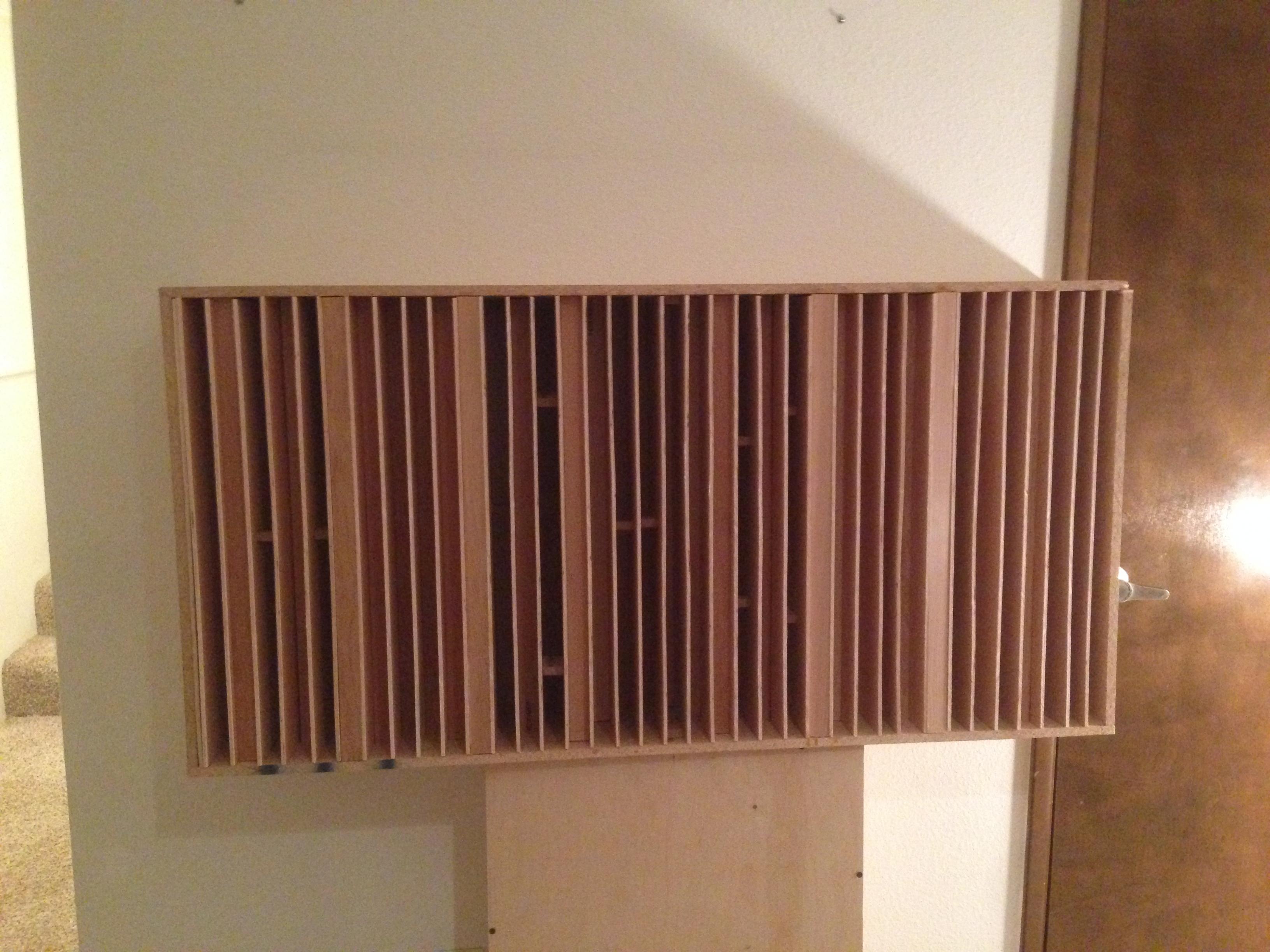

So. You have 24 drivers per side? All butted up tight against each other on the flat flange? That should come out to 7ft long. If the cones are so close to each other, I wonder what effect that has on comb filtering. At longer wavelengths it shouldn't be bad, as the cones are almost touching each other.
Yeah, the soundcard is flatter, but I don't think it is a trivial matter to get the loopback through JRiver to work flawlessly.
Yes, 24 drivers per side, 7 ft long. Where the cones are omnidirectional, it acts like a single driver and a cylindrical wavefront. When they become directional, it will result in lobing, just like a woofer and dome near the crossover. But with so many drivers combining and cancelling, I think you should still get some gain. If you sit far away from the array, and are not doing situps while listening, the comb filtering should not be audible. The comb width is very fine because there are so many drivers and their floor/ceiling reflections and the ear cannot distinguish the finely spread high Q comb (Toole says as much in his book). There are many folks here who have a similar long array and only one of them so far has complained about comb filtering, though in my opinion the complaint is because he or she failed to do proper EQ on the arrays.

Yes, the front wall reflection kind of ruins the depth perception. You could try putting some absorbers, or better yet diffusers to improve the depth. See attached pic of a diffuser I built, which is currently sitting right behind the listening position.
The best depth perception I've heard is on Pano's all horn system. The arrays come very close to that. Depth and precision of instrument positions is very good, especially on orchestral recordings. Church choir recordings sound like you are in a church with the organ far away.
Width of wall is 13 ft. Yes, the side walls of the cabinet are of the same width. Basically, it fits right into the corner. So, they are firing 45 degrees inwards. I just measured my listening distance and it is 16 feet from each corner. I'm still experimenting with the setup, including the absorption panels.
Thank you BRYTT and 3ll3d00d (wow, that's a mouthful!) for your comments. Sample rate switching could have something to do with it. The attached impulse at 44.1 kHz is pretty impressive. Can you describe more the settings in REW, JRiver and Windows to get that impulse?
As I described earlier, the best setup I was seeing was piping the output of the EMU physically into an intermediate card's input (Behringer USB I/O device) and then listening to that device using ASIO loopback in JRiver. I'd have to isolate the loopback through the EMU and then through the Behringer, but not sure what I'd do with that.
