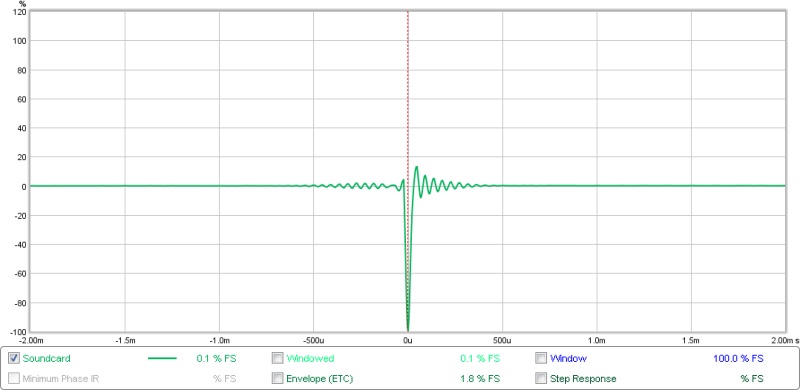

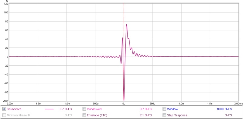

I did not calibrate my DAC. I did do a loopback of the chain and optimised (Asio) buffers for the best result. Loopback was a physical cable from DAC to Mic in.
Impulse and STEP response

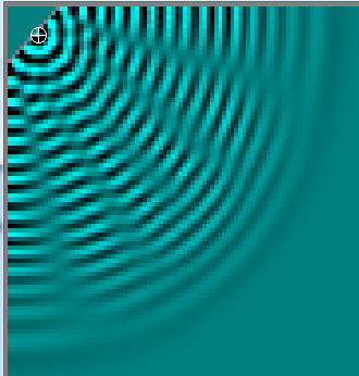

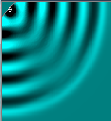

I guess I'm looking at it from the perspective that what you've created is a large conical horn. When we build a horn we don't make the horn entrance much larger than the driver exit/cone diameter. Doing so would cause rapid expansion then it would narrow again and cause a reflection. I would think that there would be reflections below where the piston diameter is controlling the pattern in your case. The driver is radiating omni-directionally and thus the baffle and finally the wall is controlling the pattern. The change in direction at the wall, to my way of thinking, will cause a reflection. I might do a model in AxiDriver and see what it shows. AD will make my model a true conical horn but looking at the field plot would be interesting I think.
Perhaps I'm overthinking it..........I've been wrong a time or two (or two dozen).
We do have a place for that: http://www.diyaudio.com/forums/everything-else/284131-how-listen.html
Created to get us off of your thread, Nate 😉
Lol, it was?
Interesting sims. Thanks Allen.

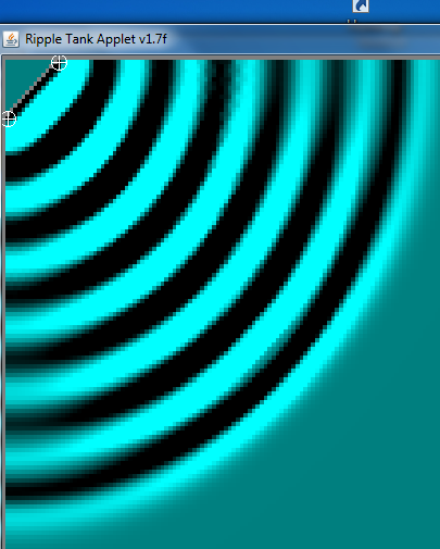

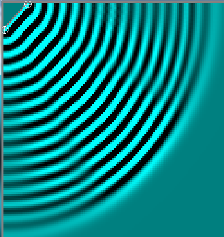

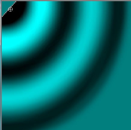

What are we looking at here? When you say line source, do you a mean horizontal line source in the sim? Or the line array? Are the different images showing different frequencies?
You're third image in post 52 is what I'm talking about. When the wavelength is larger than the baffle dimension, you can think of the entire baffle as a radiating diaphragm, kind of like a compression driver diaphragm in the throat of a horn.
That's right. A cylindrical wavefront calls for a line source. In this case this means a large vertical height (as you have now).
Looking purely in the horizontal it would come down to a point, which you have at lower frequencies.
The obvious problem is that it's not simple to mount the drivers outside the corner. Another concern is whether you trust the highest frequencies to be riding the room walls anyway, but the directivity of your full range drivers will benefit there.
By a line source in the horizontal I was referring to an overall plane array. A cylindrical waveguide is another version.
If you appropriately delay each driver, then you are essentially doing the curved line array, so it's a cheat. 🙂
I would think that the proof of good design in a line array is the impulse and step responses. As the theory goes, if you don't have a cylindrical waveform, but a series of point sources you should see a very lazy impulse and step responses even if you measure in an ideal location, with a small time window.
On the other hand, if these two signals are clean looking, you have proof of your line array functioning as a single driver. That's why I was so impressed by the impulse response if this design. Good job. 🙂

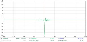

Attached is a new set of measurements that I made just now (extract the zip. The REW format was 13 MB after being zipped, so, the measurements are exported as text files). The first couple of measurements are those with loopback and calibration of the DAC/ADC loop. Below, I will explain each measurement in order:
1. Soundcard Loopback. REW Settings: JAVA drivers. EMU USB card selected for both input and output. In Windows, EMU is the default sound card. In JRiver, WASAPI loopback. Output of DAC from JRiver physically connected to mic input of EMU card.
attachment.php
2. Soundcard Loopback. REW Settings: ASIO drivers. EMU USB card selected for both input and output. Output from EMU is physically connected to input of Behringer I/O USB DAC. In JRiver, use ASIO loopback and "listen" to input of Behringer. Output of DAC from JRiver physically connected to mic input of EMU card.
attachment.php
Clearly, the second option is much better. I used this to calibrate the loop in REW. Then did the following measurements.

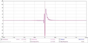

3. Line array only (no sub) left uncorrected.
4. Line array only (no sub) right uncorrected.
5. Line array only (no sub) left corrected.
6. Line array only (no sub) right corrected.
These measurements look much better. The impulse is clean for both channels.
