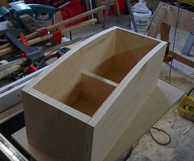

I have also started the centre speaker that will match these (in style anyway). I have studied Tony Gee's USB and ran a few simulations in Unibox to come up with a high performance design.
I will treat the interior in the same way as the midrange chambers are done on the mains. This seems to work very well.
Here's the body, put together with glue and airgun nails. Front curve was layed out with a thin wood strip bent around a centre pivot. Only one brace as this box is small and the panels don't have wide spans.
Material is 3/4" cabinet grade plywood.
Material is 3/4" cabinet grade plywood. [/B]

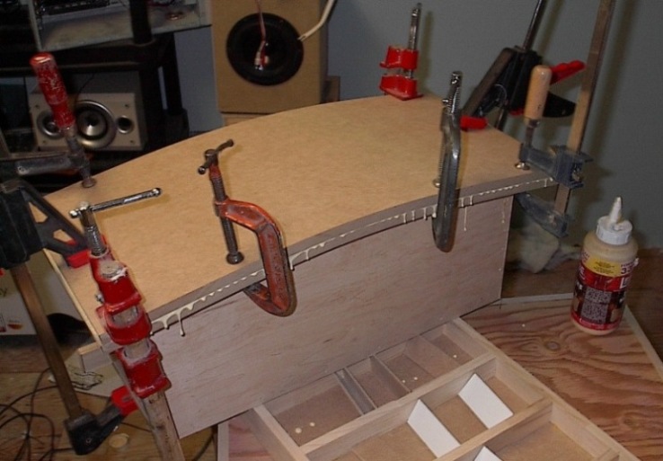

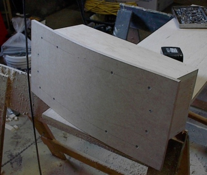

I have started to put the baffle on. It'll be three layers of 1/2" MDF, which will make it a bit thicker than the baffles on the mains.
I should have cut and glued in the styrofoam wedges before I put the front on, but I didn't want to wait. Besides, the front will need to dry over night before I can finish it with the final layer of MDF. In the meantime I'll cut the wedges, ready to glue in when I cut out the speaker hole.
Here it is with the first layer glued and screwed on. I used #8 x 2" screws and LOTS of yellow carpenters glue.

I added the second layer of MDF to the baffle. Just glue holds it. Lots of glue. Notice in the pic the squeeze out.
I have cut these pieces bigger to trim down to the final size. I should be able to put the third layer on later tonight.

I just finished gluing the last layer of MDF. Now it has time to dry overnight and I can work on it tomorrow.
