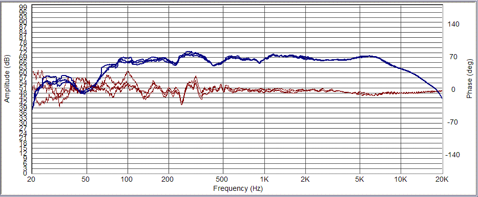

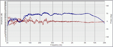

I was able to get some measurements. These are not the most accurate, as nothing is calibrated up here, but they do show some things fairly consistently. There is a peak at about 750hz and another peak at 1600hz and, I was wrong, there is a dip at 1K. I guess it's the combination of the three that's the problem.
There were 2 sets of measurements taken. The first at about 1 metre on axis and the second, at a lower volume, at about 20cm on axis. This was done with the signal going just to the midrange under test, the slide pots for the other drivers were at zero.
The graphs below are the results. There are 3 consecutive tests superimposed on each other. Blue is frequency response and red is phase response.
Charts are 1/6 octave smoothed.
Ouchie. 16dB peaks ?
Hang the driver on a string in your garden far from any reflective surfaces (includes the floor) and make another plot. A small baffle may help... This way you can know if it's a resonance in your box (not likely) or if it's the driver.
peufeu said:Ouchie. 16dB peaks ?
Yeah, there's two ways of seeing it: peaks at 750 and 1600 or one big dip at 1K. I can't see that being attributable to the box.

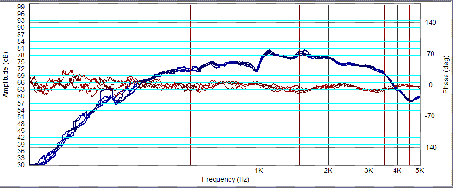

Today, I set up my Speaker Workshop test gear properly and ran a few tests. The results from last night were too rough, and I'm not happy with only half of the information.
I did a series of near field tests. First on the midrange. The test was taken with the driver still in the cabinet and the mic 1/2" from the tip of the phase plug. The tests were repeated several times. I increased the sample size in SW to 132K and set the repeat count to 3. Sample rate is 48K.
Here is how it looks. This is the results of 4 consecutive tests, superimposed on top of each other. This is not as bad as last night, but still, it's quite evident there's a problem with this driver in the 1k to 1.2k area of response.
Nice wiggle 😉
f = 1000 Hz => wavelength is about 34 cm in air... could this be the roundtrip between the driver and the rear of the box ?
But I guess trying a better driver is the way... you have active crossover, that makes it easier.
Wish you luck !

peufeu said:Nice wiggle 😉

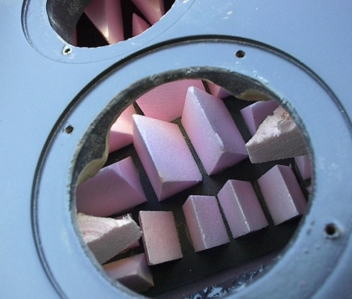

The back of the box in that area is less than 20cm, and is covered with the styrofoam wedges to break up standing waves.
I don't think it's a box resonance, but I'll find out for sure when I take out those drivers.

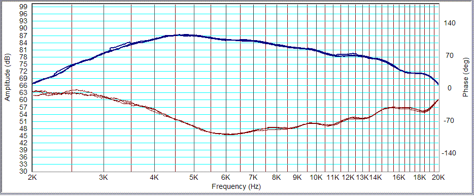

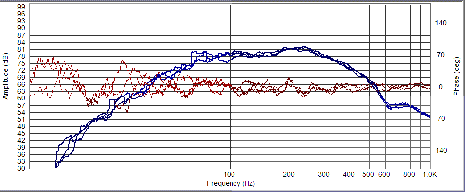

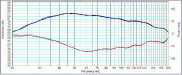

The last test is with the mic 1 metre from the speaker, aimed between the midrange and woofer. All three drivers are active and I adjusted the slide pots to get a fairly flat response (this was unexpected - I "tuned" these by ear before and that was putting the midrange and tweeter output about 4db higher than the woofer).
Power output is something like this: 100% to the woofer, 50% to the midrange and 55% to the tweeter. With differences in the sensitivity of each driver and the impedance of each one having a big effect.

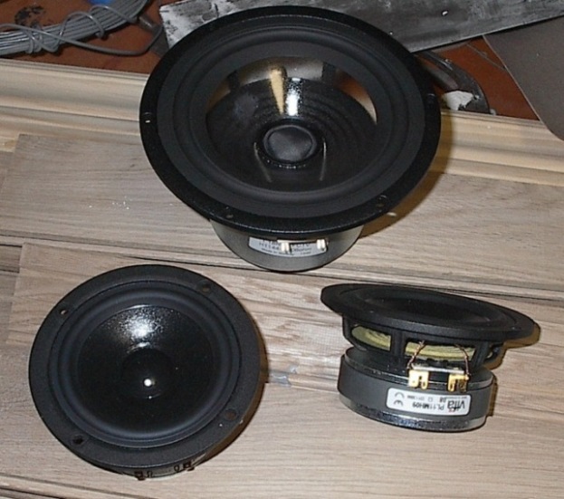

I got my new mids today and I'm getting ready to put them in. The mounting flange is a bit thicker on the new ones, so I'll need to cut out the recess a little deeper - some delicate work with the utility knife.
Also, the magnet on the new ones is quite a bit bigger, so some more sculpting of the chamber divider is called for.
Also got the Seas coax for my new centre speaker. I'll be starting the box for that tomorrow and building it in the same style as these. Curved baffle, piano black finish with a stained veneer body.
