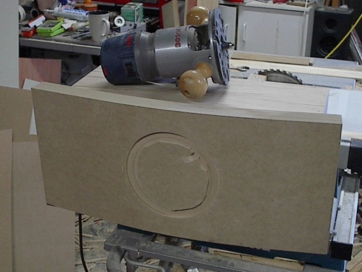

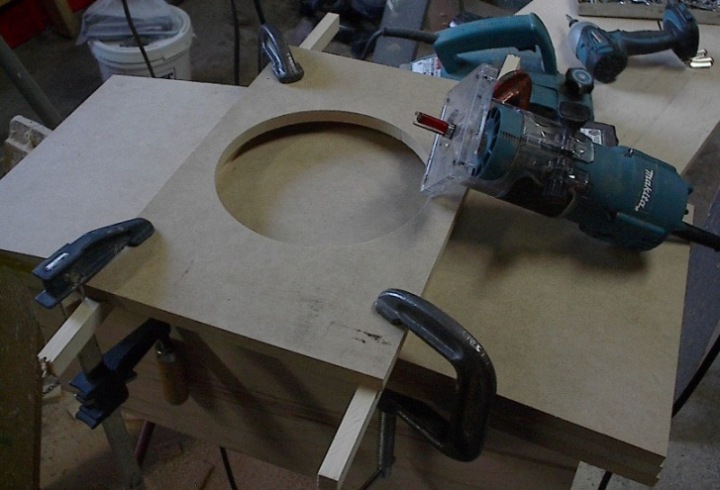

I took the clamps off the baffle and lined up my template for cutting the driver recess. I made this template yesterday with my circle cutting jig and a scrap of 1/2" MDF. This is necessary to cut the recess flat in the curved baffle. The wood strips underneath let the template sit flat and give some space for the router bit, with fine adjustments on the tool itself.
A bearing follower bit in the trim router is guided by the template. A couple of passes to cut the recess to the right depth.
All goes well with the driver recess. I cut the hole itself with the jigsaw. Many builders use the router for this but I prefer to use the jigsaw as it's quicker and creates a lot less dust.
Besides, I don't need to burn out my expensive router bits.

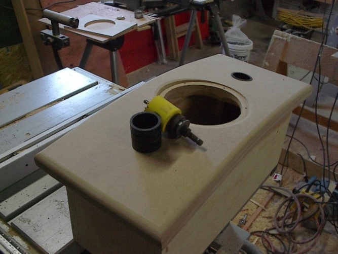

Round over the edges, and some basic rough sanding with the random orbit sander. Time to put in the ports.
The outside diameter of the 1 1/2" drain pipe is about 1 7/8". I use that size hole saw and the pipe will almost go. A small amount of sanding inside each hole with the drill mounted drum sander and it's a snug fit.
To glue in the ports, I cut two shallow grooves around each pipe. These are spaced 1/2" and 1" from the end that will be in the baffle. These groves will fill with epoxy and help anchor the ports in place. I also run a bead of polyurethane caulking around the outside of the port where it meets the back of the baffle.

When the epoxy sets up on the ports, I route the mouth with a round over cutter. Looks very good!

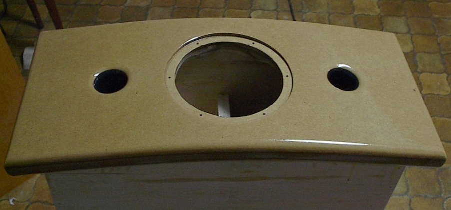

Sanding the entire baffle is critical to a smooth finish. I sanded with a fine (320 grit) disk on the random orbit sander, paying special attention to the edges. The face gets sanded too - even though it feels smooth, it can be improved.
When you think it's smooth enough and you've sanded it enough, sand again, just to be sure. 🙂
The baffle will get 2 coats of solvent based clear polyurethane. This is to seal the MDF. The black paint that will be used to finish the baffle is waterbased urethane paint (seen earlier in this thread). I am going to try a different approach this time - apply multiple layers with a foam roller, instead of spraying.
There are a couple good reasons to try it this way: 1 - It's winter and my workshop is not heated, so spraying is not an option. 2 - This baffle is small and I want to know if I can end up with the same polished result doing it this way.
Here it is before the first coat of urethane.

I have put the second coat of urethane sealer on. Time to dry overnight and I'll sand it smooth tomorrow,then it will be ready for paint.

I've been trying to show some of the construction details that I didn't include in the first of this thread. Here's a shot of the baffle just after the recess was routed. Notice the pencil line drawn for the driver cutout. I used my compass set to the width of the flange to mark it.
Router on top with 1/2" roundover bit installed, ready to shape the edge.

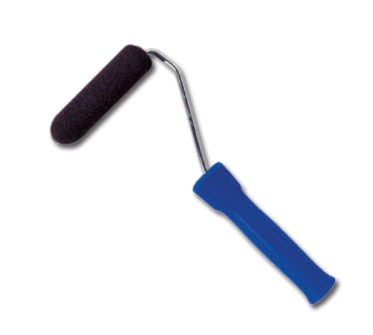

Ray Collins said:Is it a sponge roller or a low nap or ???
It's a foam (sponge) roller. I would never use a nap roller for anything other than to paint a wall. They give off too much lint, no matter how broke in they are.
Normally I use a foam roller with a velvet cover for polyurethane, but I'd just bought a 4-pack of the regular ones, so I used that. These are small 4" rollers.
Look like this, except the refill is white:

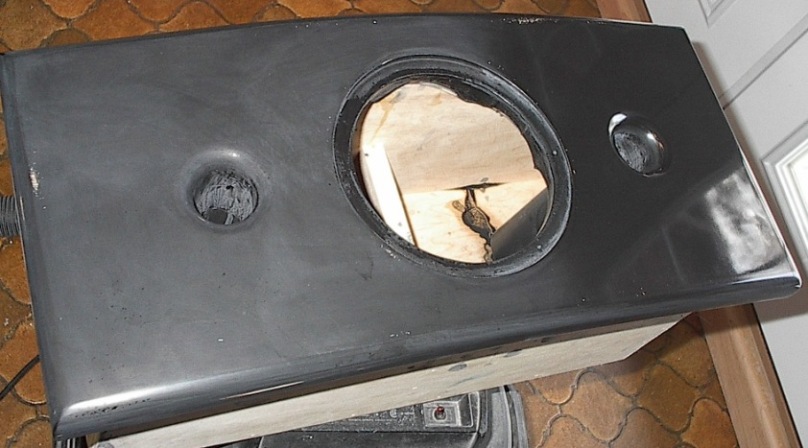

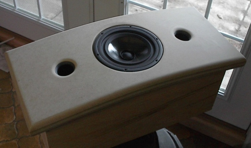

I have 5 rolled coats of paint on the baffle now. This stuff dries so fast - 30 minutes between coats. It looks pretty rough, but that was to be expected. It should sand flat without any problem, I'll just need to let it dry completely, probably overnight.

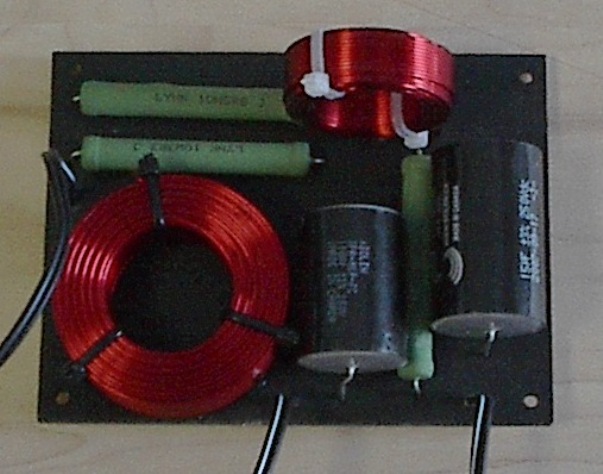

Spent some time building the crossover. Using Speaker Workshop to measure, I unwound that coil to get it at .47mH. This is straight from Tony Gee's USB project, so I don't anticipate any problems.
Made it all neat and tidy on a piece of 1/8" hardboard painted black. Wiring is 20 gauge stranded, which will be fine for the short lengths involved.

Well, I won't be proving you wrong this time Ant. The roller idea is a bust.
A few good reasons: By the time you pile on enough layers of paint (without letting it completely dry between coats) the surface is so rough it takes an enormous amount of sanding to get it flat. By then, you have sanded off 90-100% of the paint - nothing left to work with. Also, the film build is not as homogeneous, there are visible layers once it's been sanded. Finally, it takes too long to roll on each coat, wait a while and roll on the next, and the next, and the next, etc.
I will wait for warmer weather (another month and a half) and spray it. Who know, I might have another project to paint by then also.😀
In the meantime, I'll give it a quick coat of black from a spray can to make it look OK, finish the body, mount the driver and use it.
Here's how it looked after I sanded it and gave one side a quick polish. Wasted effort. Another lesson learned. 🙂

Ah well, never mind John. If you'd come back and said it worked, well I'd have been tempted to have a go myself as I have the some problem as you - poor weather this time of year. I'm still waiting to finish up the spray job on the last LGT.
At least we can lecture folks on "good things come to those who wait" 😀
