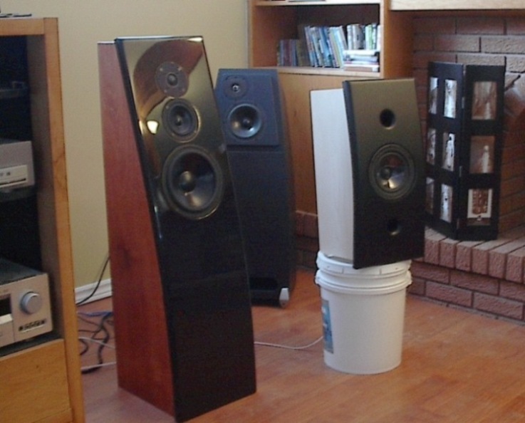

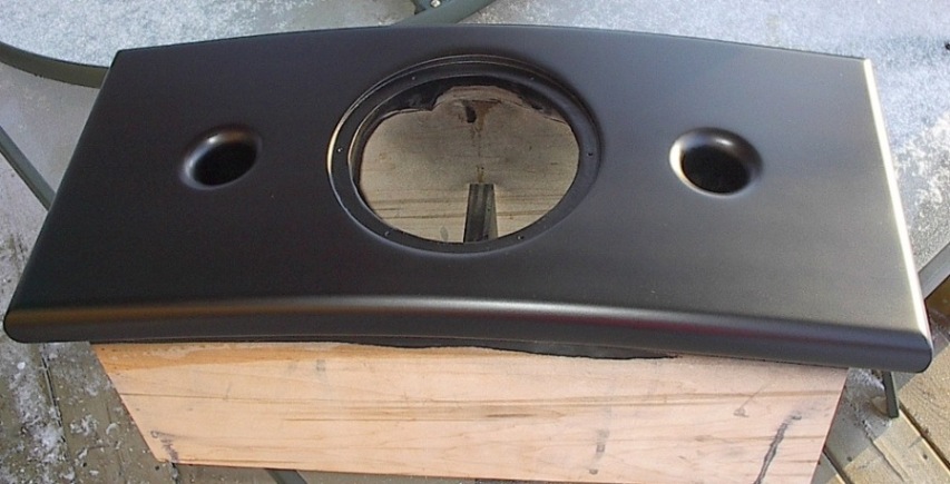

I painted the baffle with two coats of black eggshell spray enamel. Looks presentable anyway.
I'll start on the finish layer for the body next.

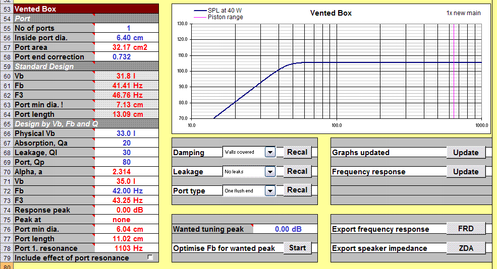

MJL21193 said:
Box for woofer is 33 litres, tuning freq. 59hz, F3 is 63, Qtc is .628.
Getting back to the original speakers, the above is quoted from my post #39.

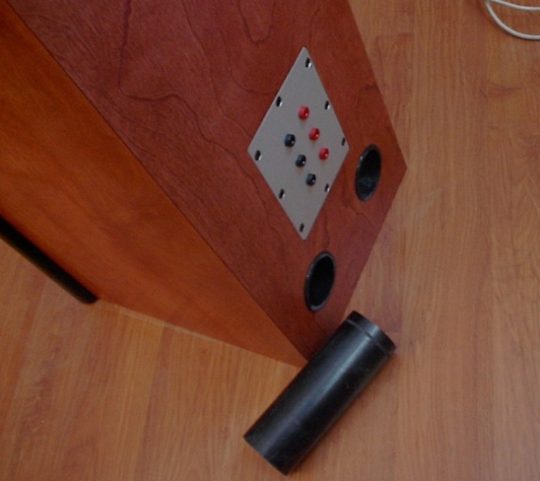

More listening and I think I should make these vented. I have ran the calculations through Unibox and I think I'll be more satisfied with the bass response if I add a port.
The unibox sim shows the Fb at 42hz and the F3 at 43hz with a 2.5" x 4.5" port. The best place for one is at the back, below the connection plate.
I think I'll give it a shot. If I don't like it, I can always block it.

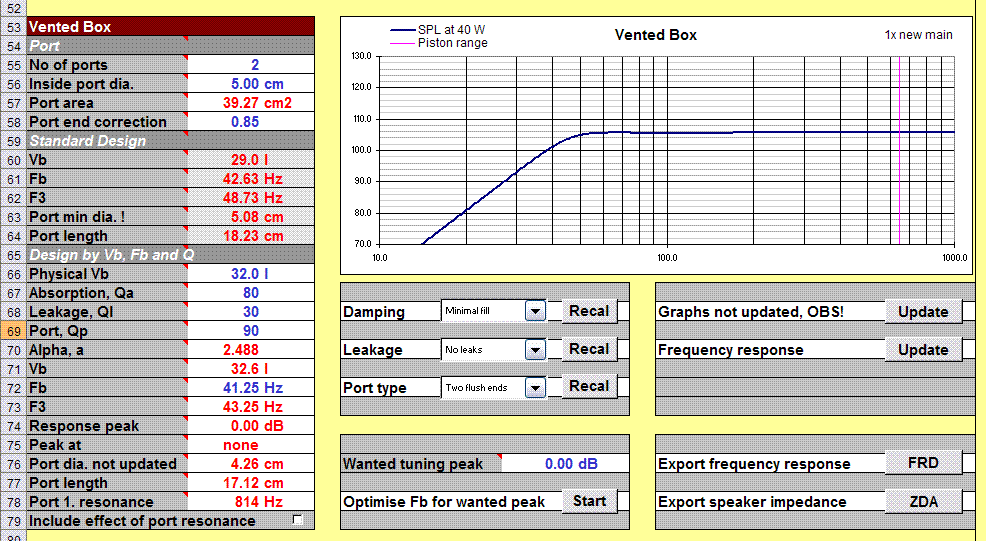

Besides, Unibox shows the driver exceeding xmax with the sealed enclosure below 90hz at 40 watts. Now, that's about 104db for this driver, but that doesn't leave room for transients.
Vented performance looks better for this driver.
I went ahead and put the vents in. I couldn't find a pipe with a 6.4cm inside diameter, so I used two 2" ABS pipes. These have a 5cm inside diameter. A little more work with Unibox to determine the right length plus I subtracted 1 litre of volume for the vents (these are 17cm long with about 15cm inside the cab - close enough to 1 litre).
I also left the rockwool stuffing inside, I just made sure it wasn't around the mouth of the ports.

They sound better. The bass goes much deeper. I would say this is a big improvement.
I have never been a big fan of bass reflex, but using an 8" woofer limits the low end. Luckily I selected a driver that is suitable for vented alignment as well as ported.
If the time comes when I build the subs for this pair that I want to change them back to sealed, that's possible. I'd just glue in the correct plug available for this pipe.
Here's how it looks. Nice and tidy, you'd say it was always there. I glued them in in the same way I glued the centre channels port in - cut a groove for the epoxy to help anchor it.

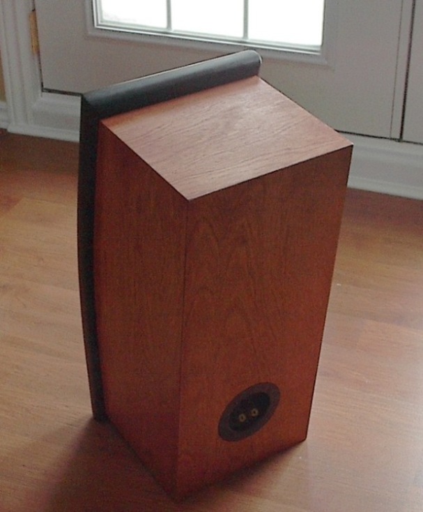

I put the second coat of stain on the new centre speaker today. It'll be ready for the first coat of urethane tomorrow.
Here's how it looks. I sold out and used a plastic terminal cup for this one. I did cut a recess for it to sit flush though.

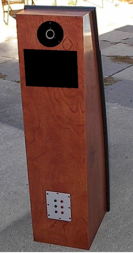

Talking to Andy Graddon here about the mids used here. I'm considering opening the back of the cabinet, as I believe it will improve the midrange. I need to do some more listening before I take this step.
As for opening the back, here's the plan: cut a hole the nearly covers the rear of the midrange/tweeter chamber. Cut a recess around it to receive a grill frame with ordinary black speaker fabric on it.
Another thought I had was to put a rear firing tweeter in. I have a pair of Pioneer 1" metal domes that I'd be willing to experiment with. I haven't heard a speaker with a rear firing tweeter before, but I've heard good things about the results. Thoughts? Comments?
Here's a quick paste on an existing photo of roughly how it would look. I think I could manage to make it look neater. 🙂
