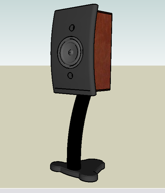

I have been thinking about a stand for the centre speaker. I want the centre oriented the same way as the mains, upright.
Basic idea:
