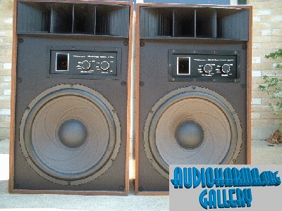

The famous Mach 1? I think they were $199 each in the 1980 RS catalogue. I didn't have a real amp to drive them, but they sounded great anyway.
