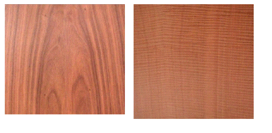

I did consider rosewood (below left). Beautiful colour. Also see next to it the quarter cut makore.

I'm going to get both the ribbon and the pommeled to do some comparison. I normally don't go in for the highly figured veneer, preferring the straight, clear grain but the sapele knocked my eye out! Obsessed with this now, so I won't be satisfied until I have it.
Brett said:I like the ribbon better.

One of my favourite woods is maple, and I especially appreciate tiger strip maple. It's a natural figure that I like. This is my attraction to the ribbon sapele, along with the outstanding colour.
As I mentioned above, I will get both veneers and look at them both.

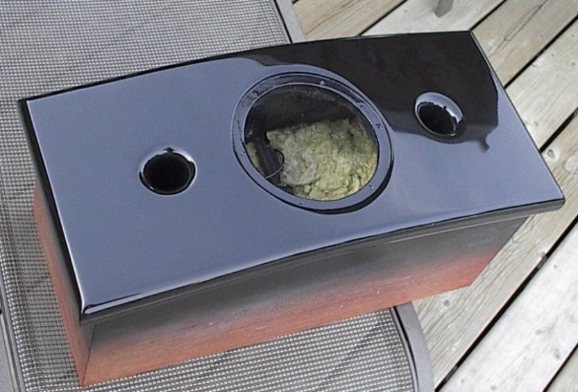

As I mentioned previously, I sprayed the baffles with the last of my gallon of black Armorseal. I did this before the paint booth, outdoors. A warm spring day and there was pollen (I guess) in the air, and this landed in the paint - tiny white specks. No big deal as I intended to paint these again anyway.
Well, in a rush to try out my new paint booth, I sanded one of these and sprayed on about 10 coats of clear polyurethane. This was an experiment to see how well the Armorseal looks with a clear.
I let this cure for about a week and colour sanded this clearcoat and polished it. I like the results - the white specks are visible, but they look intentional, as if I meant for them to be there. It gives more depth.
As for the final results - I think I'll be doing it this way for now. The polyurethane polished flawlessly and I'm left with the most reflective surface I've ever achieved. Straight on refection is perfect, no cloudiness or distortion. For speakers, I think this finish is as durable as it needs to be, no need for a 2 part clear.
To this end, I have sprayed the clear on the other baffle and I'm now waiting for it to cure enough to sand and polish. Once the baffles are perfect, I'll order the veneer for the rest of the cab.
Pics soon.

I finished polishing the first speaker and have started putting the drivers back in. The second one has not been sanded and polished yet.
I sprayed the centre channel speaker, the one I built over last winter (details earlier in this thread). I couldn't paint it last winter due to cold temp in my garage, so I left it alone till now.
This time around, I used some of my old black solvent based urethane paint for the base. I sprayed on about three coats and the went straight away to the clear urethane.
Turned out nice - sanded and polished. I didn't bother to mask the veneer body, as I will re-veneer these to match the mains (eventually).

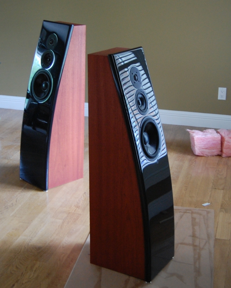

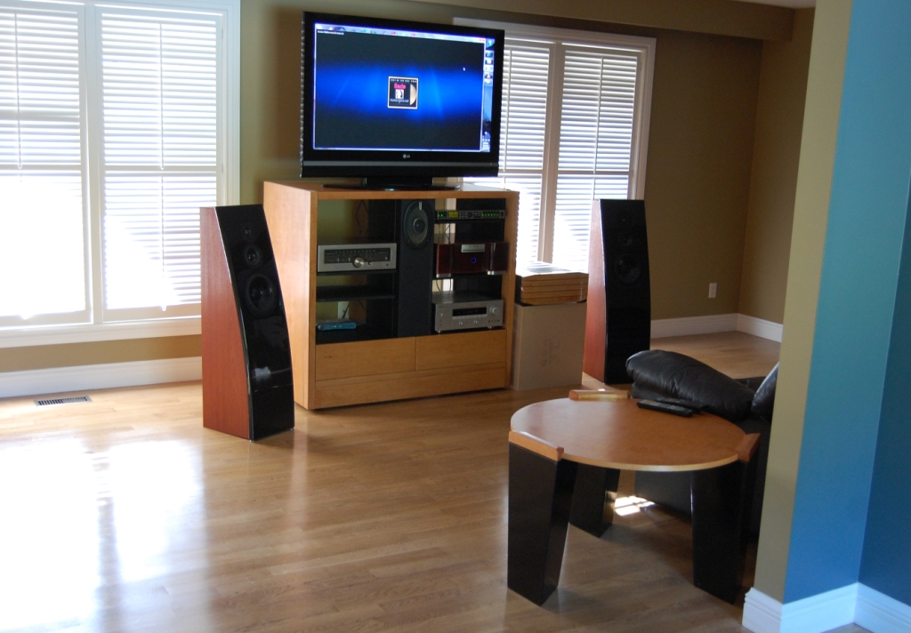

I found the time over the summer (about 5 months ago) to finally finish these speakers, mainly the veneer and bits and pieces.
They have been my main speakers for the past 3+ years. I can honestly say that I don't believe I would trade them for anything else.

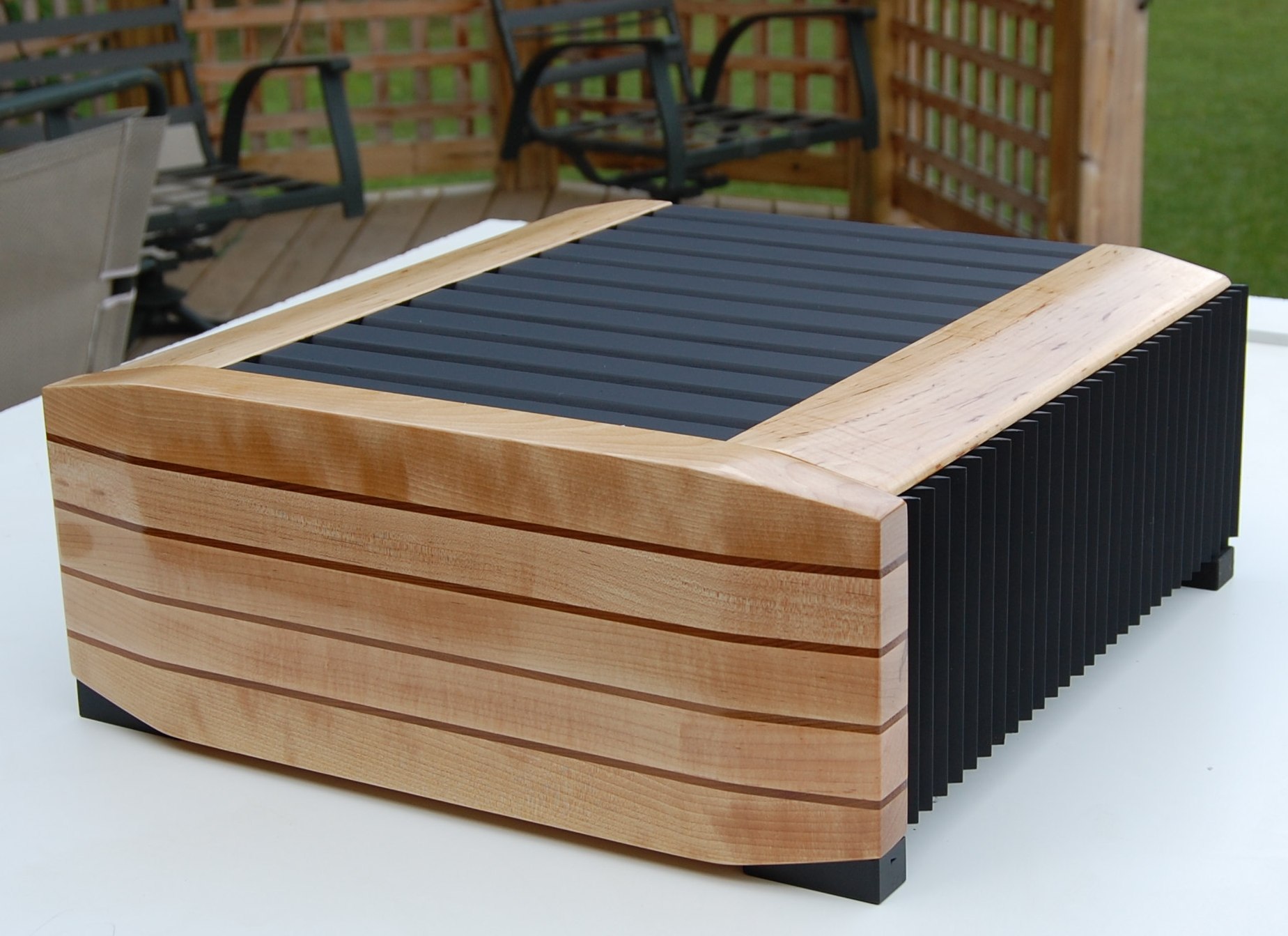

They are actively driven, using my 6 channel Patchwork amp:
My computer is the ONLY source and I use a stock DCX2496 as the crossover.
I settled on Jatoba for the veneer:
and finished it with 4 wiped on coats of an oil/varnish mix. I'm pleased with both the colour and the finish, the texture of the open grain contrasts the ultra smooth black of the baffle.

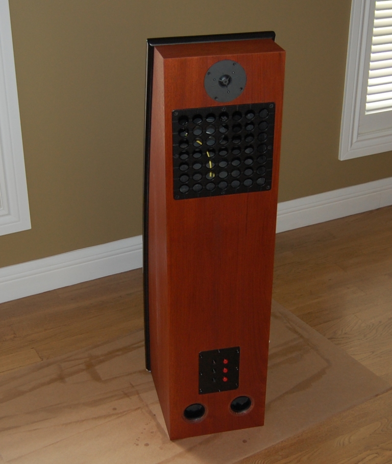

A shot of the back:
showing the ports, input jacks, rear facing tweeter (this turned out to be an excellent move BTW, it makes quite a noticeable difference) and the 'grill' I fashioned to cover the opened up midrange chamber (another move that worked out well).

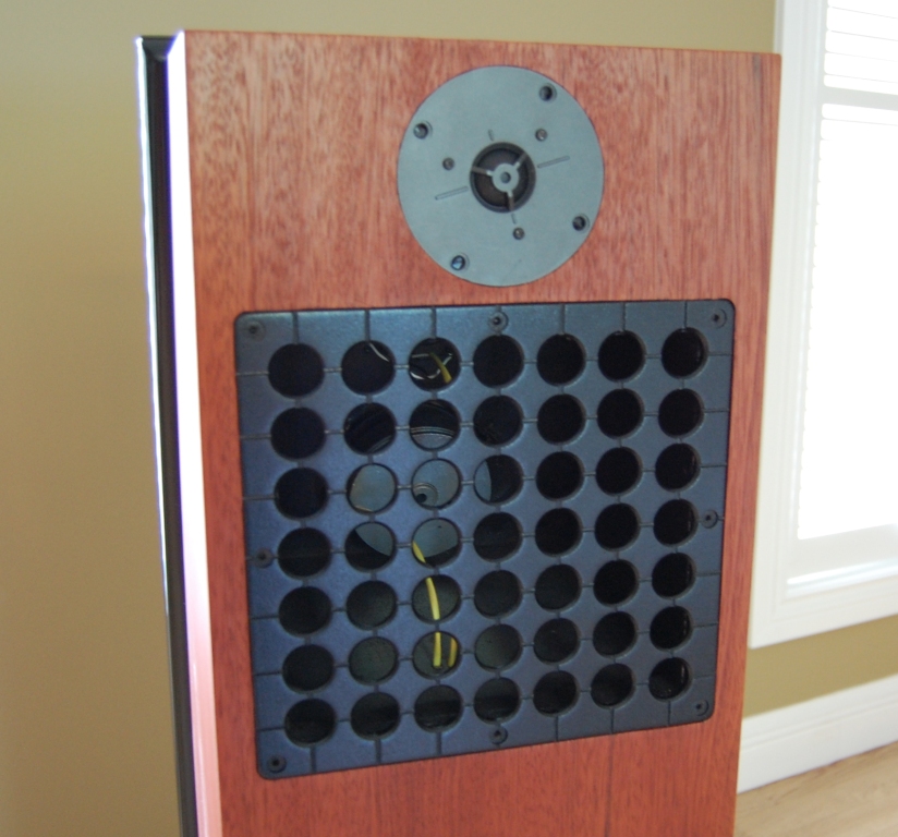

A close-up of the grill:
It is 1/4" hardboard, a grid of 3/4" holes and painted with textured black. Not seen in this photo is the black speaker cloth that I glued to the inside of this grill to hide the fiberglass stuffing of the midrange chamber (those 2 hunks of pink in pic #2).

Excellent work, they're beautiful.
I really like the amp chassis too: it's given me a 'lightbulb' moment for something similar I want to do for the amp for my bedroom speakers.
They look very professional build great craftsman ship.

I tend to put up with ugly things, as my main loudspeakers are always a work in progress. I have settled on a design I think I'm going to stick with and these I will finish.
