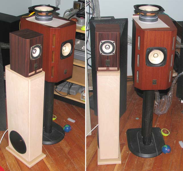

planet10 said:... and this
Do you have enough speakers there? 😎
I have a similar scene, but mine are all real speakers and in various stages of completion/metamorphosis.
Latest transmutation is the pigment change to the body of these 3-ways. They have gone from stained wood veneer to smooth black matte paint.😱
Bodies are black, baffles are...maroon! Pics later. 🙂

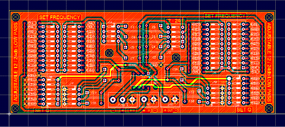

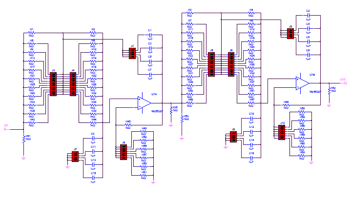

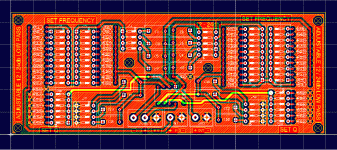

I have done a very nice board layout for the active crossover. Low pass is done and I'm now working on the high pass. These will have nearly all of the same adjustably as the original MOX, the only difference is mine will be 12db or 24db only.
These use dip switches instead of jumpers and each board has one dual opamp. There will be a single input buffer for each stereo channel and 3 output buffers with trimpots to set the level.
I will build this into it's own separate chassis.
Here's how the low pass board looks. I'll need 4 of these.

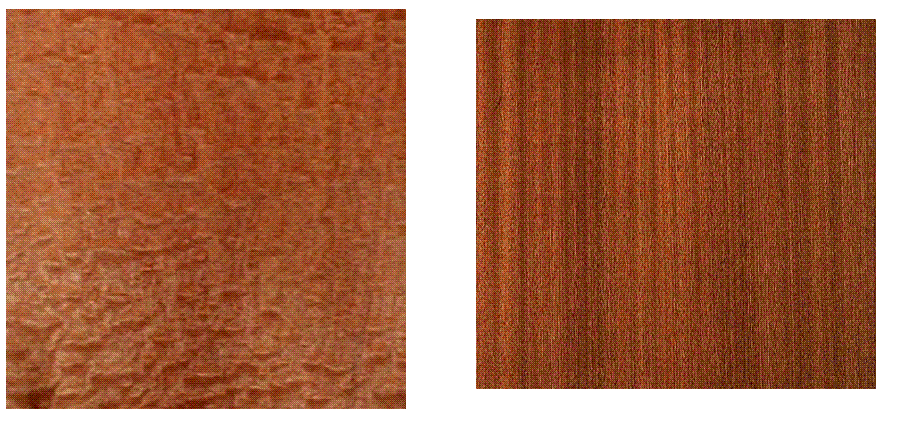

For the body, I want veneer again. I want something different this time though, not the original maple (getting a bit tired of that grain now).
In particular, I want a veneer that I don't have to stain, but will naturally be a dark reddish colour. With this in mind, I have been looking at several from my supplier. I considered jatoba, makore, African mahogany, and sapele.
I have narrowed that down to sapele, either ribbon or pommeled. Below are the two, first is the pommeled. This is rather expensive at $316.00 for a 4' x 8' sheet of paper backed. The one next to it is the ribbon sapele, that's only $68.00 per 4' x 8' sheet.
I'm leaning toward the pommeled, as it really has a fantastic look.
Thoughts? Opinions?
Thoughts? Opinions?

The sapele is being used on quite a few guitars and looks quite nice, close in looks and sound to mahogany. The pommeled stuff is beautiful and can look 3-D when finished. I just bought an all sapele guitar (top, sides and back), but in the ribbon variety. I guess it depends upon your wallet and how much the top and sides will be visible in your room. The pommele could be a real standout!
Steve.
