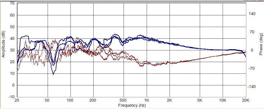

I will be re-doing the active amp at some point (soon), and will be using a pair of the Patchwork amps for the bass. Your thoughts on BSC would be greatly appreciated. I didn't bother with BSC as I didn't think it would be needed at the time.
I know how to implement it for a passive xover, but I'm in the dark for active. Any links to point the way?
Here's a recent on axis frequency response taken at ~2 metres out, mic aimed between the tweeter and midrange. Gives an idea of in room response. Three consecutive tests superimposed.
This straight, not thru the EQ, I set the outputs to what sounded good to me.

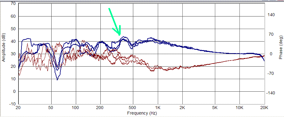

The baffle being 30cm (~12") give BS at 383Hz. This is interesting, and I'm not sure if this could be reliably pointed out, but there is a dip in the response at that frequency, as shown on the chart above.
Am I seeing the room there, or the baffle step?

Hi John,
The orange line here is my visual average of your in room response: http://baselaudiolabs.googlepages.com/3wayff.gif
Seems to me that some tilt is needed in both the woofer and mid pass bands. There are several passive line level circuits on the web, I offer one here, it was a very casual experiment, post number 39 there is the one. Links to a specific post don't seem to work there:
http://www.classicspeakerpages.net/IP.Board/index.php?showtopic=2692&st=40
I believe that there are also several OP amps based circuits also on the web. I don't know of one off hand, there is Google of course.
In room response measurements are not usually reliable at mid bass and lower frequencies, however your measurement does tend to show the trend. Dips there are usually destructive interference with boundaries such as the floor or walls if close to them.

Hi Pete,
I want to do a complete redesign of the circuit, making the active filter separate from the amps - giving me more flexibility. The one filter/one amp on one board seemed like a good idea at the time, and would be great for a lesser pair of speakers, but it's too limited here.
I would like to make the active filter with independently changeable crossover frequencies and the ability to change slopes. In the original thread, AndrewT recommended SIP sockets to make for easy component swapping.
I would like to incorporate variable BSC giving 0db to 6db adjustment, either to the overall signal (like Rod Elliot does here ), or actively boost to the bass section only.

F1 FAN said:
Hi John,here is an excellent link for implementing BSC actively. http://www.t-linespeakers.org/tech/bafflestep/bstepcompo.html
I added 3 db of BSC to my speaks but my baffle is only 8.25" wide.
With your baffle being 12" you may not need any.
Hi F1,
That circuit looks like the ticket. I would need to make it adjustable, so I would use a socket for C and change R1 to R1 plus a 10K pot. Fix values for R1 and R2 at 2K.
Thanks.
