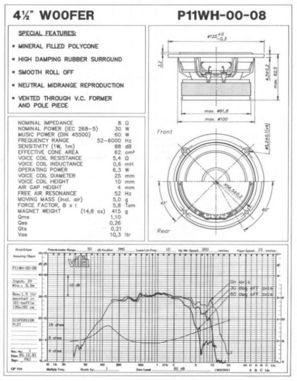

I have had almost 2 weeks to listen to these speakers. I am not happy with the midrange. It's too "in your face" and something's not quite right. At first, I thought it was that these drivers are too efficient and that reducing the output to them from the active amp would tame them a bit. This just reduced their volume, not their "forwardness". They have the cheap transistor radio quality about them that's ruining my satisfaction with these speakers.
I first thought that it might be my special interior treatment of the chamber was not doing enough, but removing the drivers and adding stuffing did nothing. I also, for lack of anything else to try, reversed the polarity. This didn't help at all.
Followers of this thread will remember that I had no solid info on these drivers and only had my Speaker Workshop measurements to go by. I think the frequency response is peaked, and that's what I'm hearing.
I was looking around at Solen for a possible replacement and see the Vifa P11WH008 is on sale. I used the P13WH008 on a previous project and found the results to be very good.
The P11 would be a direct fit in the existing driver hole and recess (125mm diameter).
I attach the spec sheet for this driver. Frequency response is perfect for this speaker.

What is the midrange distortion like ?
I mean : with a microphone and a soundcard, you can get a harmonic spectrum from it.
peufeu said:What is the midrange distortion like ?
I am in the process of rebuilding my Speaker Workshop test gear, and don't have the facility to test yet.
I do know the midrange doesn't sound right, and I thought that going with a driver that I know about (and have the specs for) will be an improvement.
These mids (the MAX's) cost me next to nothing. They were used, and I'm no sure that they weren't abused (although they don't sound like it).
I have used an equalizer to cut some frequencies and it made a definite improvement to how the midrange sounds. This is the basis for my belief the response is peaked (maybe around 1K).
I'm paying now for not properly trying these drivers before I committed to using them. Luckily, the P11 is only $33 each and I believe they are well worth that.
