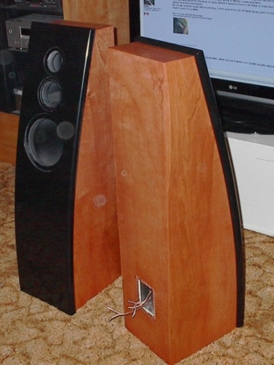

I managed a well deserved break from work today, so I devoted most of the day to this project.
With the stain completely dry, it's ready for clear finish. It's my goal from now on to use only water based products, mainly for health concerns and ease of cleanup. Water based finishes have really improved over the past few years to the point where they outperform their solvent based counterparts.
My first coat of urethane goes on with a brush. This will raise the grain so that it can be sanded smooth. The rest of the coats will be sprayed on, with no sanding between coats.
I want to do the same polishing on the body as on the baffle, so the finish has to be thick enough not to sand through. This winds up being around 10 coats. Spraying outdoors, with a slight breeze and the temperature here today around 25 C, the layers dry quick. How quick? Well, with solvent based urethane flash time would be about 20 to 25 minutes. It would be tacky. After ten minutes, the water based urethane is dry to touch!

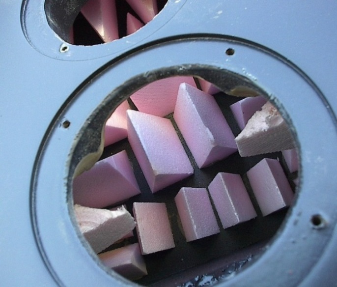

With the incredibly fast dry times for the urethane, I had some time on my hands. I decided I'd spend some time working on the midrange chamber treatment.
As mentioned earlier, I will be using triangular prisms cut from styrofoam to simulate an anechoic like enclosure.
Once cut (with my table saw), I have 30 wedges to work with. They are 3 inches long and 2 x 1 1/2 at the base. As the chamber is small, the wedges need to strategically placed. I have calculated the volume of 15 of these wedges to be about 1 litre.
I manage to get 14 glued in place - with none directly behind the midrange driver. There is an audible difference when I snap my fingers near the opening of the treated one as opposed to the untreated one. That's encouraging. As I have not done this type of damping before, I can't predict the results. Just hope for the best.
As for the wedges, I think I'll leave them without putting the rubberized asphalt coating. When I spray the baffles, some paint will get on the wedges, making some stiffer than others. Could make a slight difference in their effectiveness, either positive or negative.
Here's a picture of the results. It doesn't look like much in the photo (hard to see into the small holes). Four of the wedges are glued to the top, eight on the back and one on each side.

I like the idea of trying to absorb the backwave of the mid driver, presumably to prevent sound leaking back out through the cone? Let us know how it works.
My initial reaction (not that I know anything!) is that styrofoam would not be the best absorber??? I suppose the proof is in the hearing tho...
terry j said:I like the idea of trying to absorb the backwave of the mid driver, presumably to prevent sound leaking back out through the cone? Let us know how it works.
I don't think the goal is to absorb it but to cause highly chaotic reflection so as to decorrelate it.
dave
Exactly my thoughts. The back wave "gets busy" among the wedges bouncing back and forth, losing energy. I think of an empty room as opposed to a room full of furniture.
It may well be that wool or fiberglass stuffing could do a more efficient job of dissipating the back wave and that I am wasting my time. I do know that this kind of stuffing is more effective at some frequencies than others and seems to rob some of the midrange dynamics (or is that just my imagination?).
The proof will be in the listening - if it sounds good, it is good.
I will cut some wedges that are about half the size of these and glue those in place wherever they will fit, mostly behind the driver.

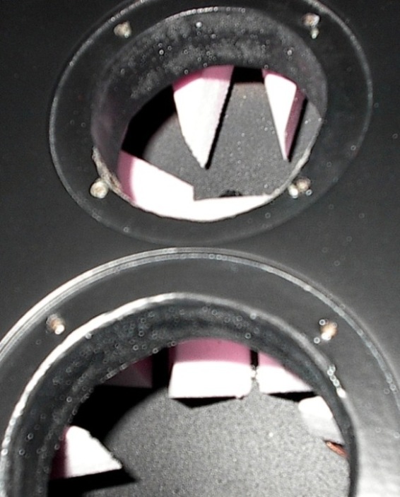

I have chamfered the inside edge of the opening to give more "breathing" room. The basket on these drivers is short - less than an inch from flange to magnet. Also the magnet is almost the same diameter as the mounting hole, so it will be tight.
Luckily the baffle is only 1 1/4" thick.
Cut and glued in the smaller wedges. 14 of these in each box, just like the big ones. I put them behind and beside the driver. Also managed to squeeze one in on the top.
Inside of the chamber is starting to resemble a sharks smile. 😎
Accomplished a rare feat - a decent photo! Good view of the interior.

If the baffle looks dull, that's because it got a few layers of urethane yesterday while I sprayed the body. I was going to mask it, but decided to sand them and spray the whole unit.
Gives a good base for the black water based urethane paint which will be the finished coat.
