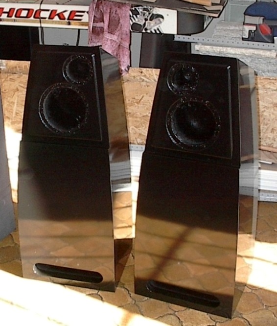

Picture from 3 years ago taken shortly after painting:

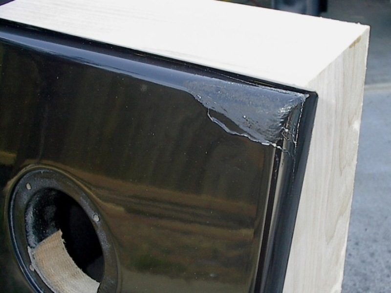

Disaster strikes.
While gluing on a back panel, the speaker shifted on the (apparently inadequate) support, and fell on the concrete floor.
After I finish stomping around slapping myself on the head, calling myself stupid and saying every foul word I know, I assess the damage.
All in all, it's not that bad. Obviously any damage to the baffle means a re-paint. The paint is scuffed near the bottom and the top corner is crushed. I was lucky as it fell almost straight down onto its face. Closer examination reveals no other damage, in particular I thought the seam between layers on the baffle might have opened up. Not so.
What can I say? Live and learn. You can never be too careful.

MJL21193 said:A Bela Fleck tune has bass? 🙂
Generally a 36Hz low note, but quite powerful. Some say it's 32Hz. My wave analysers aren't designed for looking for such things (more for making pretty pictures).
Victor usually plays 4 strings, which gives a low E circa 41Hz. His five is BEADG, low B 31Hz. Doesn't means he actually plays that low.Cloth Ears said:

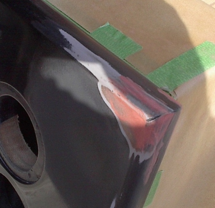

Bela Fleck aside, repairs to the fractured corner happen. A quick sanding, then a coat of clear urethane (spray can) for primer. Let that dry for a couple hours then use automotive spot putty to fill the cracks and dent.
Spot putty is good for this kind of repair where it doesn't have to be thick. It dries fast and is easy to sand. When primed, it absorbs the primer and becomes harder.
Pic shows finished repair before priming. I then gave it a coat of black spray paint to make it look presentable, since I probably won't do the final re-paint for a while.
That yellow carpenter's glue must be hellish strong as there look to be no cracks after the fall. Mind you, any fall on a finish like that will look ugly. I'm glad it's "simply" a sand/touch-up/repaint fi8x, rather than a rebuild.
Cloth Ears said:I'm glad it's "simply" a sand/touch-up/repaint fi8x, rather than a rebuild.
A second on that.
dave
Cloth Ears said:That yellow carpenter's glue must be hellish strong as there look to be no cracks after the fall. Mind you, any fall on a finish like that will look ugly. I'm glad it's "simply" a sand/touch-up/repaint fi8x, rather than a rebuild.
There is a thread that I've been contributing to where the question of this glues strength came up. This little "test" that I did here should dispel any doubts.
The problem with repainting is that with the thickness of the final paint layer - I'm running out of room in the driver recesses. I lack the painting skill to just paint the affected area and feather it out.
I'm thinking that I'm going to be forced to carefully route out the recesses again, to make enough room for the new paint.
Also I am eager to try a new waterbased urethane paint. This could be my opportunity to use it.
I'm lucky that the damage wasn't worse. With the addition of the outside layer of particleboard, they are quite heavy. It's a setback but not a major one.
MJL21193 said:The problem with repainting is that with the thickness of the final paint layer - I'm running out of room in the driver recesses. I lack the painting skill to just paint the affected area and feather it out.
Quick tip for you John. Get a sharp stanley knife and carefully run it around the inside the recess. It works best if you hold the blade at an angle and make many light passes shaving the paint off, once that's done go back and tidy up sand paper if need be. I've stripped a few paint jobs in the last couple of months and it works everytime.
Good idea. I'd use a cabinet scraper personally, (less likely to dig in), but then I do like my scrapers. 😉
