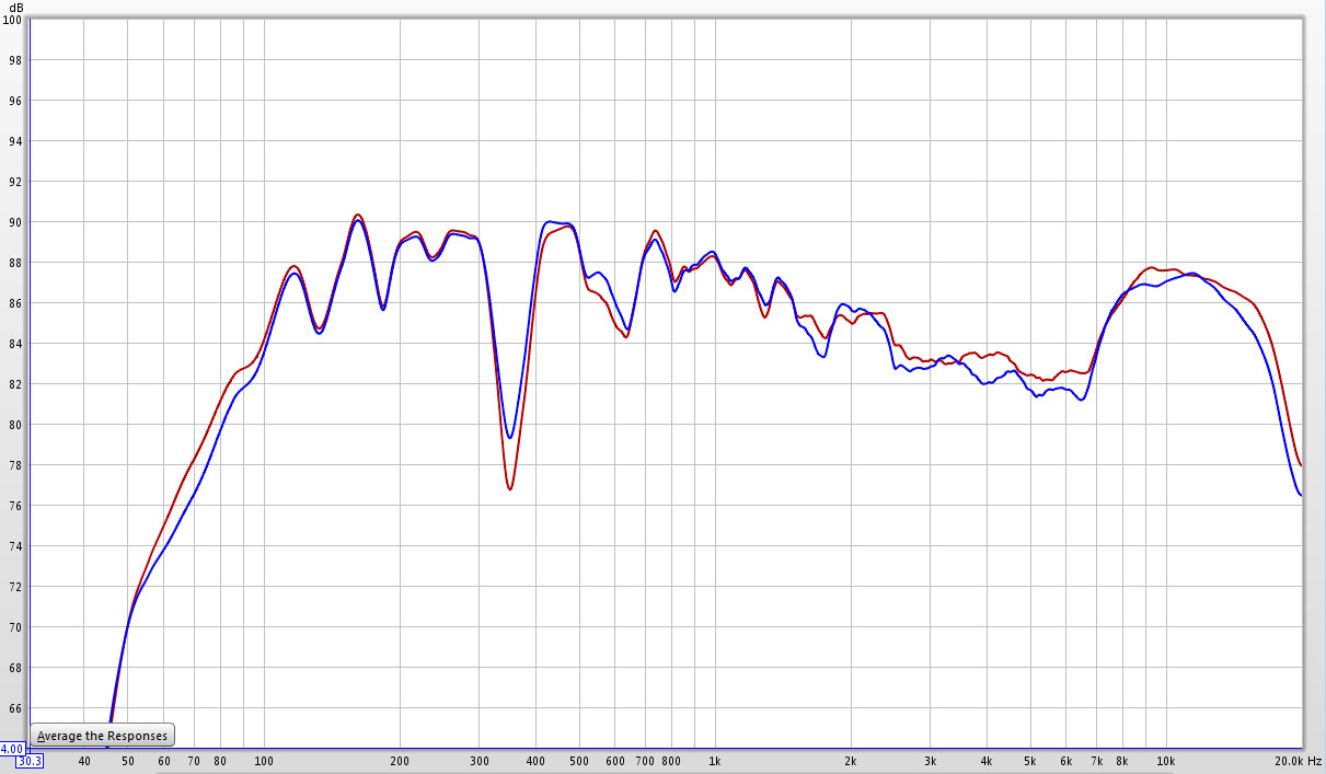

I've been waiting for this thread to pop back up as I couldn't remember which thread it was where we were discussing grills.
Anyway, I stumbled upon this post awhile ago which indicates I may have been wrong about the grill effect. His link doesn't show exactly what type of grill it was or how much percentage was open but I will concede that this is enough proof to say I was wrong to say the effect would be dramatic.
http://www.diyaudio.com/forums/subwoofers/190635-th-18-flat-35hz-xoc1s-design-211.html#post4445173
In the past the examples I've seen had a much larger effect, although some or all of it might have been measurement errors or artifacts. Stuff like this -
And many more. And all of these were just cloth grills which you would expect to have not much influence at all below 100 hz.
I don't want to rehash anything else that was discussed here, just wanted to say I found proof that indicates that metal grills have little effect at low frequencies.
Some of those graphs definitely look a bit odd. Like the one for the jBL Loft speakers showing a 10dB increase at 40Hz? WTF?
I'd put it down to measurement conditions (the jbl one seems to have been done @1M, which is bound to introduce artifacts at bass frequencies if done in-room (unless it's a very large room, LOL).
For in-room testing for response changes at bass frequencies, I measure much closer to the DUT and use a high test level to near the peak capabilities of my input device (to reduce the impact of background noise). Seems to work pretty well, though it does annoy my family at times 🙂.
Yes, clearly everything below 50 hz on that one measurement is garbage. Maybe somebody dropped book or something and was too lazy to measure again because they were only interested in the tweeter range? It can't be a room artifact or it would be in both measurements. Pics 1 and 3 look competent enough, although that doesn't mean anything and differences could come down to errors or artifacts. But I've seen quite a few of these comparisons and never seen a match like the one I linked to. But it only takes one known good measurement to prove a point. I can't guarantee it's a known good measurement and I have no idea what kind of grill he used but it is enough for me to admit I might have been wrong.
The one way I can think of the grill affecting the response is when it serves to properly brace the mouth of the horn, reducing the tendency of the sides of the mouth to flex. In a properly-braced horn, the impact will be very minor, but if it's not braced properly in the first place...
If I was measuring the impact of a grill, I'd be piling sandbags or something else heavy on top the horn to eliminate any flexing (or lack thereof) from impacting the measurements. But that's just me...

Just a guy: have you tried to simulate mass loaded horns and stuff? Then you will see how much the grill affects it
Yes I'm aware of the effect of mass loading and I thought a 50 percent closed grill would have some type of mass loading effect. But the link I provided shows basically no effect at all. It's the first measurement I've seen that shows no effect but this measurement does exist so it's enough in itself to admit I might have been wrong about how much effect a grill has. Note that it's unclear what type of grill was actually used except that it was metal as per the provided link in that post that just links to an order sheet, there's no picture.
