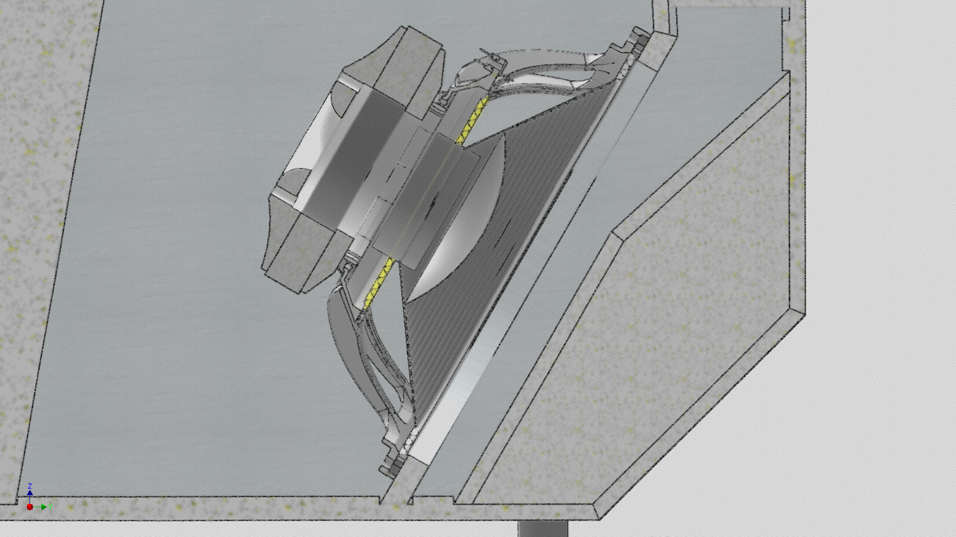

Context -
This is from a much earlier conversation where Brian was trying to figure out why the 118 measurement did not match his quick and dirty sim. The sim was incredibly inaccurate and didn't account for a lot of things. The discrepancy between sim and measurement was just a few hz and I mentioned that the large driver and the "ledge" rounding the last bend were fairly significant factors when you are looking for a few hz discrepancy.
That driver and that "ledge" are pretty significant.
IIRC when he refused to accept that these blockages would provide any significant impact, I mentioned there was also a grill that may or may not have been in place when the sub was measured.
As far as I'm concerned, the whole grill debate isn't even that important although I'm certain it has at least some effect. The driver and the "ledge" were the elements I was trying to get him to simulate accurately, as it wasn't clear whether the grill was actually on or not during the measurement.
At this point, since I have no measurements of my own and couldn't find any reliably reputable measurements in a quick search (although there were a few that clearly show LF grill effects I'm not sure I trust them any more than the measurement that started this thread), I am going to back off (not concede) for now on the grill issue even though MTX seems to agree with me.
If we were to place a grill over the vent, the tuning of the vent would change ...
https://www.mtx.com/t/enclosure_construction
I am still adamant that the driver and "ledge" are significant if an accurate sim is desired.

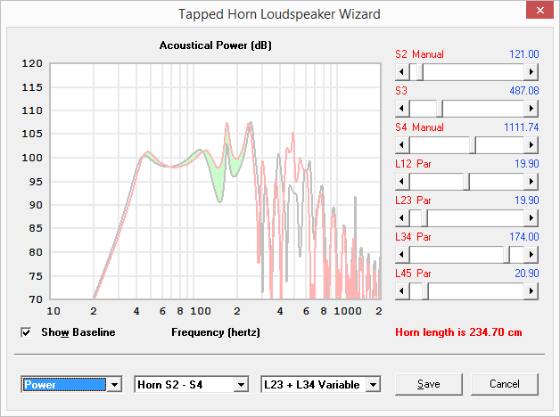

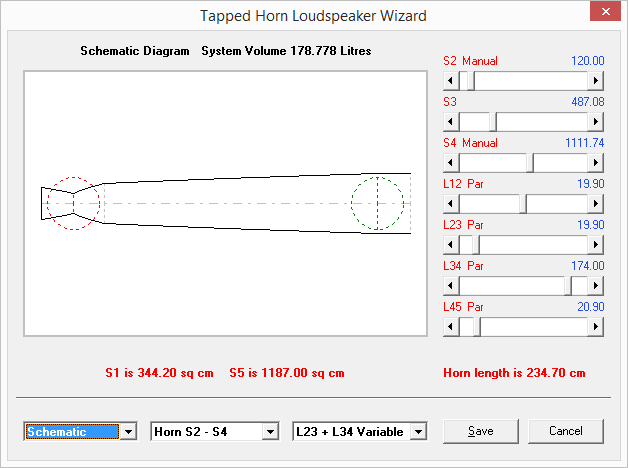

The layout of the TH115/8 suggests however that there's a lot more than "cone compensation" going on. The amount of "compensation" seems to be 2 to 3 times the amount actually required. This suggests that there's another purpose to it.
Circling back to this statement I made, I think it's possible that the Danley designs go way past what seems to be needed for cone compensation, in order to improve the response at the upper end of the response curve and perhaps widen the horn's usable bandwidth. Basically taking the benefits of cone compensation and pushing them even further.
The results of a HornResp sim I did today suggest that you can accomplish this by significantly pinching in the CSA @ S2 ("The Infinia Pinch"? 🙂). In the FR graph pictured below, I've highlighted the major change in performance that was achieved by adding the "pinch" to the sim.
The sim is a single-expansion TH rather than the dual-expansion one, but I don't see why the same approach should not work in the latter, the only issue being that it cannot be sim'd in HornResp.
There's a possible disadvantage to this method however - the compression @S2 may be way over what's considered to be safe. If compression @S2 is a factor, there are other methods of accomplishing the same thing that are safer (including my DFD which sadly also cannot be sim'd in HornResp). However, if you are trying to keep the size of the TH down and also extend its response, and if you think your driver can handle the higher compression, it might be worth exploring. It's interesting enough for me to be tempted to try it out on my POC1 to see what the measured results would be like, but unfortunately my DFD is permanently installed in it already.
If any of you have a THAM12 or THAM15 build, the pinch might work well in that to reduce the notch at the upper end of the THAM's passband.
For clarification purposes, the example I provided is NOT a sim of the TH115 or TH118! It's just a quick sample sim that I put together to show what the impact of the pinch could be on a TH's response.

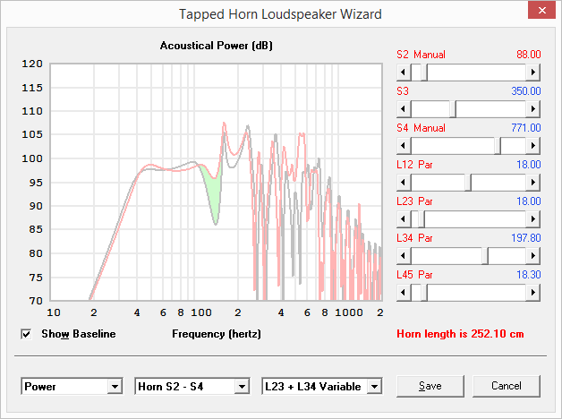

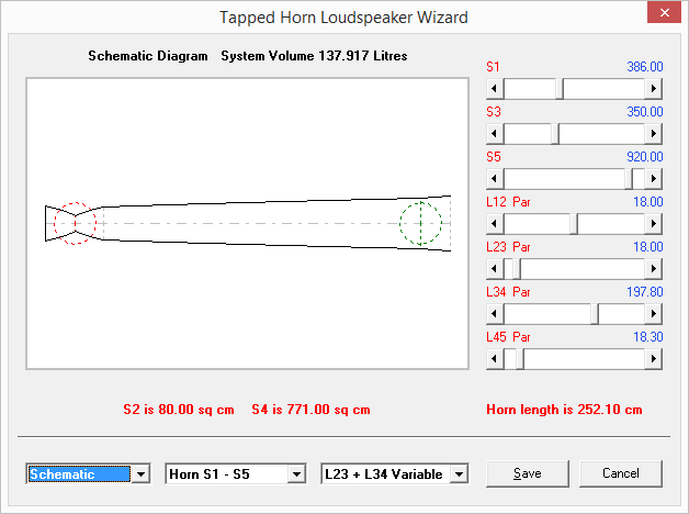

I took the original HornResp parameters you provided, corrected them (by changing the expansion to Par and adding in a value in Vtc that's an approximate value for the volume of air sitting in front of the cone and in the driver cutout). I then converted the model to an S1-S5 version, and then pinched the CSA at S2 in that model down to 121 cm^2. The results look promising - see attached image.
This goes beyond "cone compensation" though, which IMO is just ensuring that the TH layout takes into consideration the volume of air contained in front of the driver's cone. We're actually significantly pinching in the CSA at S2 - see second image - quite a bit more than what would be required for cone compensation. The change in layout will look similar, but it's not the same.
