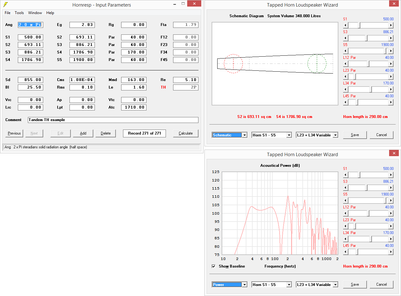

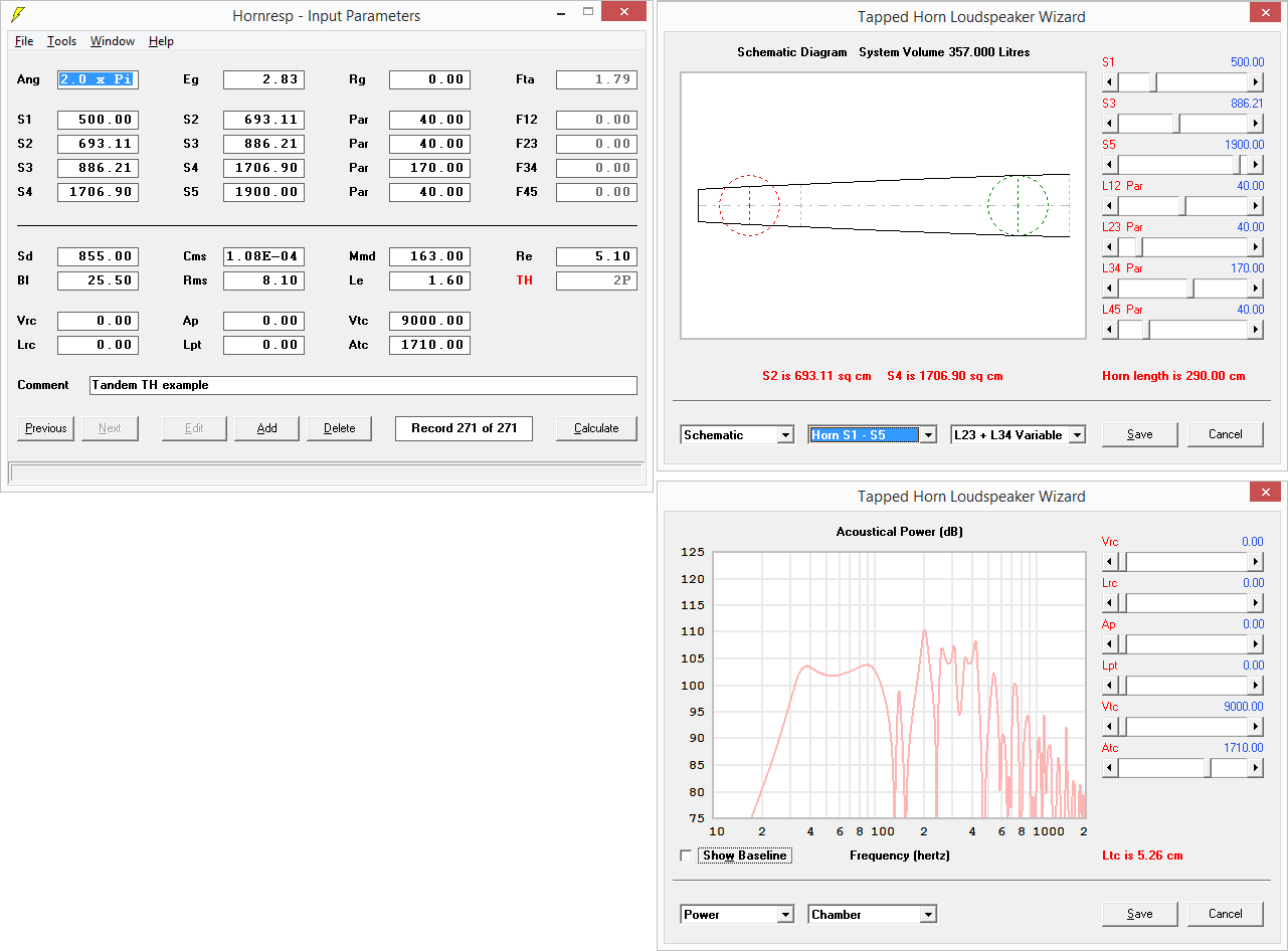

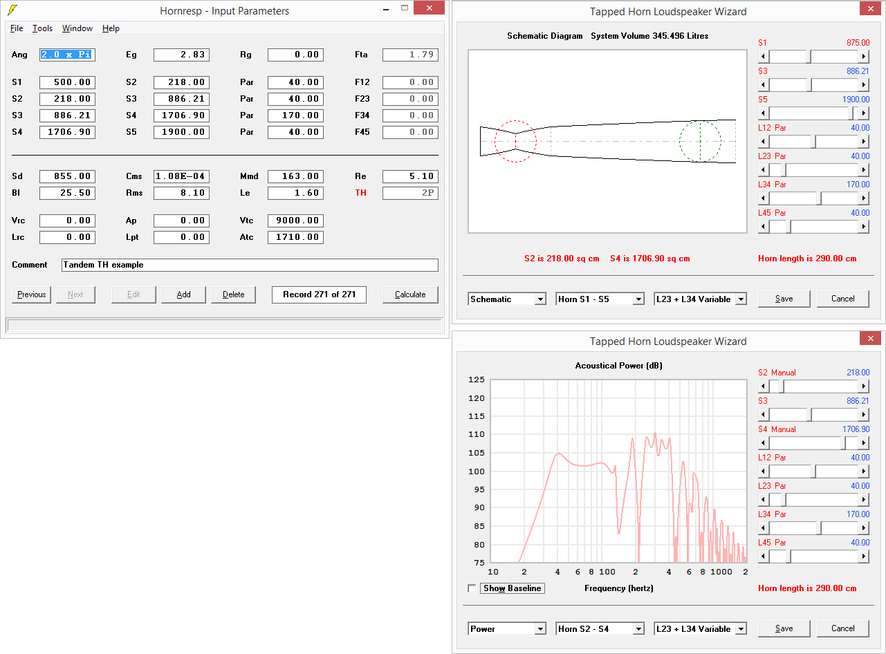

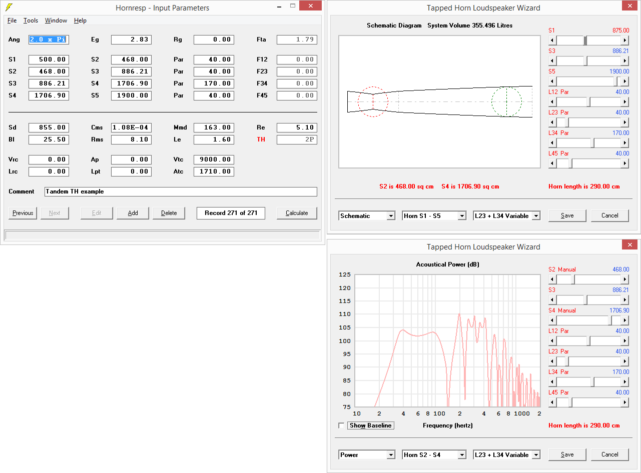

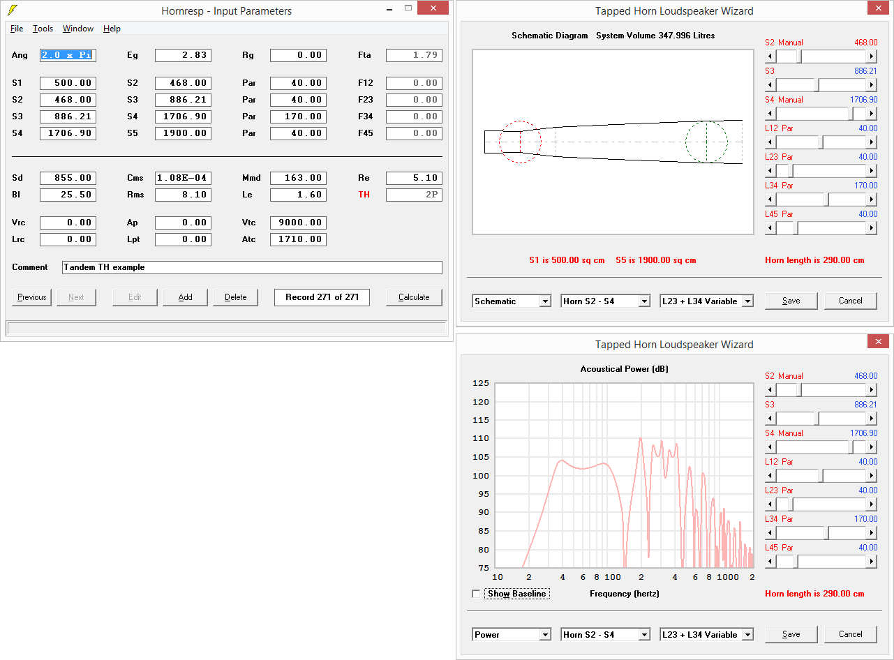

So, here's a little mental exercise to try with your example:
1. Flip the bottom driver and adjust the volume between S1 and S2 to compensate.
2. Increase S2 to negate any pinch that may have been implemented there for cone correction.
What do you end up with?
I see you didn't bother to try out my exercise, so let me give a worked example.
The 1st image is a HornResp model of a two-driver TH, including its schematic and its frequency response. What's missing from the sim? There's no figure for Vtc, so the impact of the volume of air contained in the cones is not being taken into consideration.
Now, let's consider that this is two 15" drivers facing into the baffle. That adds up to about 9L of volume at Vtc that's not being taken into consideration. If we adjust the model to include this, we end up with what's shown in the 2nd image.
Now, we want to implement "cone compensation", i.e. to adjust the TH's layout to bring it back to the response shown in the first image. How can we do this? Well, the results of the HornResp model suggests we can do that by simply pinching in S2 a bit, bringing the TOTAL volume in the schematic back to 348 L. Check the FR of the sim in the 3rd diagram. It is basically identical to the one in the first figure. The conclusion is an obvious one - if you agree with me that HornResp is good enough for modelling a tandem-driver TH, then it's clear from the sim that pinching CSA at S2 (rather than adding pinches in front of each driver) can be used for "cone compensation".
Now, finally, let's consider the case of where one of the drivers is reversed, so its basket actually sits in S1. See the 4th diagram. For 15" drivers, the volume this is likely to displace can about 7.5L. So we need to ADD 7.5L to the horn at that location to ensure that the FR remains the same as shown in the model. How do we do this? Well, if it's the driver closest to S1 that we're switching, we can simply increase S1 until the model's TOTAL volume reflected in the model goes up by 7.5L. In this case, S1 needs to be increased from 500 cm^2 to 875 cm^2. REMEMBER, if we want to see what the FR is going to look like, we will have to decrease S1 back to 500 cm^2 in the model, as HornResp does not provide a means of actually modelling the effect of a driver's basket in the S1-S2 section - we're just using HornResp here to help figure out how much we have to increase S1 in the build to compensate for it.
Is that schematic beginning to look familiar to anyone?
Now, let's try a "pinch" at S2 to see what happens. See the 5th image. Basically I've (1) returned S1 to 500 cm^2 for modelling purposes, (2) reduced S2 to give a somewhat better response around the notch, and finally (3) increased S1 to what it would have to be IN THE BUILD to reflect the additional 7.5L that's required between S1 and S2 to compensate for the driver's basket, and bring the results more in line with the model.

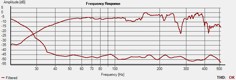

I decided to take the frequency response of my POC#3 with "cone compensation" and no DSP filtering to see what the raw response looks like. The results are as expected - the two "notches" in the FR, one around 129 Hz and the other around 280 Hz have filled up a bit, compared to the response without cone compensation. Another thing that's noticeable is that the "out of band noise" between 150 Hz and 200 Hz seems to be less peaky in nature.
In fact, the results are encouraging enough that I'm tempted to try pinching S2 even further, quite a bit beyond that predicted as required for cone compensation. Now I just have to figure out the best way to do it...
Note - this is a close-miked FR, done at a different level to the previous FR measurements given in this thread. The distortion levels therefore won't be comparable.
