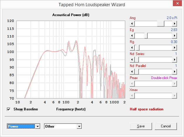

I am well aware of how sound works and what a soundwave is. What i am taking about is that you have different pressures over the cone as long as you don't have exactly the same crosssection over the whole cone..
Your first statement was in reference to my "pinch" sim being inaccurate. I quote: "accurate simulations gets accurate measurements" (a statement which is factually incorrect, btw, as to get accurate measurements does not rely in any form or fashion on simulation - instead it relies on the use of accurate measuring equipment and proper measuring technique). I responded that, at the wavelengths being considered, the simulation method is good enough for bass horn use.
If you're now talking about pressure differences across the cone itself (something that Hornresp does not sim, AFAIK), then there is going to be some variation yes, depending on the cross-section of the horn at that point. As to whether or not that variation actually makes a difference, that's another matter. I haven't seen any studies or measurements to confirm whether or not it makes a difference, and there are plenty of TH builds that seem to work fine without trying to make pressure across the cone constant by adjusting the cross-section area of the horn in that location.
I think you missunderstood me. What i was talking about was that the pressure distribution over the cone will not be equal and what i meant with your quote was that accurate sims equals accurate bulids, and you have done just that.. i was not saying that your sim was inaccurate, merely that the metod is not that good for pressure equalisation.. i do not speak english as a first language so some words might be chosen badly.

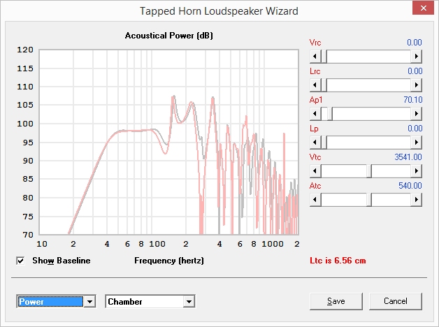

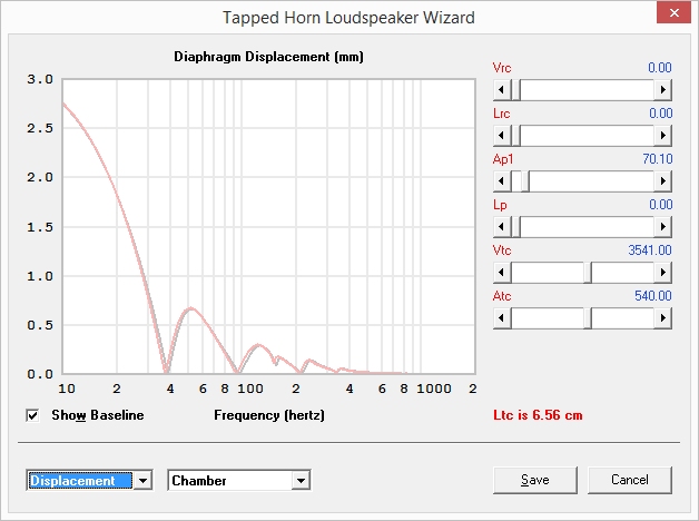

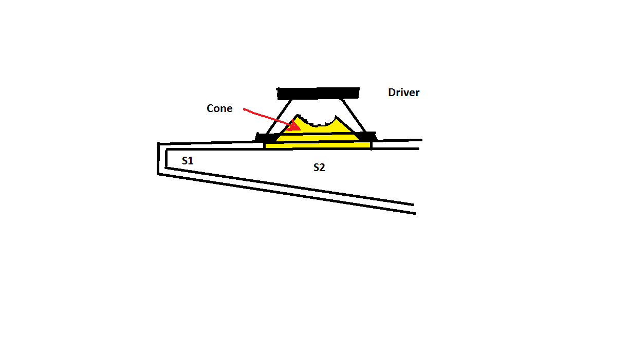

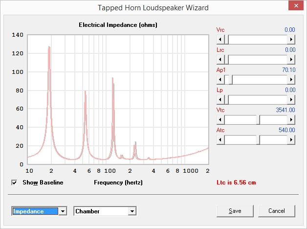

Look at the WAE simulation inputs for tham12, they're very good, also note the small "expansion" at S2.
I assume this expansion is to take cone volume (AND CUTOUT -Don't forget that) into account, will it sim much differently using "Vtc" like Brian Steele suggests?

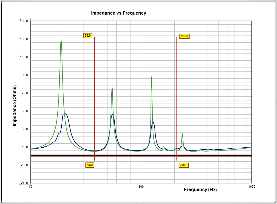

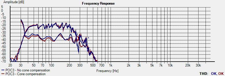

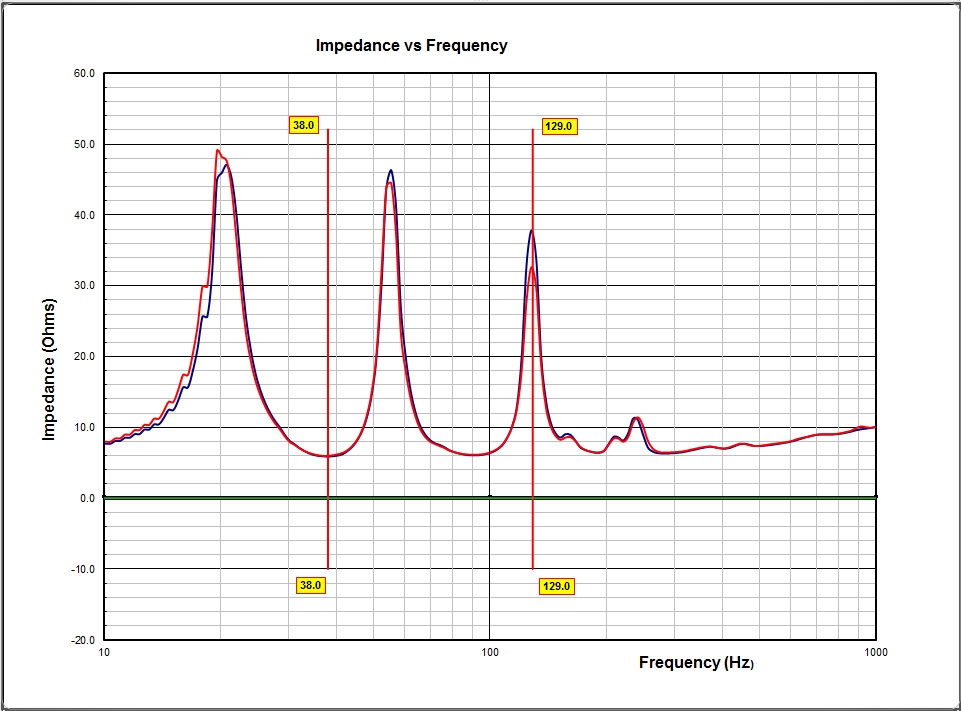

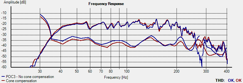

Hey we tested this with ears & microphone in a single fold 12" tapped kick horn
It sounded much better & more tight!
It measured worse!
We have an extremely high sensivity at the "third bump" from approx 120-240hz, sim says the same.
I mean a REALLY high sensivity, I was thinking about playing around with using this band more, but subwoofers would get bigger than big!

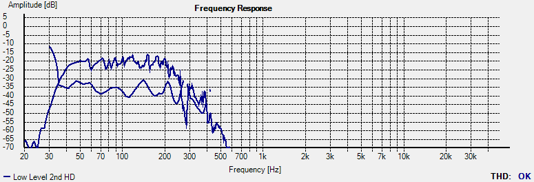

In the past the examples I've seen had a much larger effect, although some or all of it might have been measurement errors or artifacts. Stuff like this -
image_preview
And many more. And all of these were just cloth grills which you would expect to have not much influence at all below 100 hz.
I don't want to rehash anything else that was discussed here, just wanted to say I found proof that indicates that metal grills have little effect at low frequencies.
Some of those graphs definitely look a bit odd. Like the one for the jBL Loft speakers showing a 10dB increase at 40Hz? WTF?
I'd put it down to measurement conditions (the jbl one seems to have been done @1M, which is bound to introduce artifacts at bass frequencies if done in-room (unless it's a very large room, LOL).
For in-room testing for response changes at bass frequencies, I measure much closer to the DUT and use a high test level to near the peak capabilities of my input device (to reduce the impact of background noise). Seems to work pretty well, though it does annoy my family at times 🙂.
Yes, clearly everything below 50 hz on that one measurement is garbage. Maybe somebody dropped book or something and was too lazy to measure again because they were only interested in the tweeter range? It can't be a room artifact or it would be in both measurements. Pics 1 and 3 look competent enough, although that doesn't mean anything and differences could come down to errors or artifacts. But I've seen quite a few of these comparisons and never seen a match like the one I linked to. But it only takes one known good measurement to prove a point. I can't guarantee it's a known good measurement and I have no idea what kind of grill he used but it is enough for me to admit I might have been wrong.

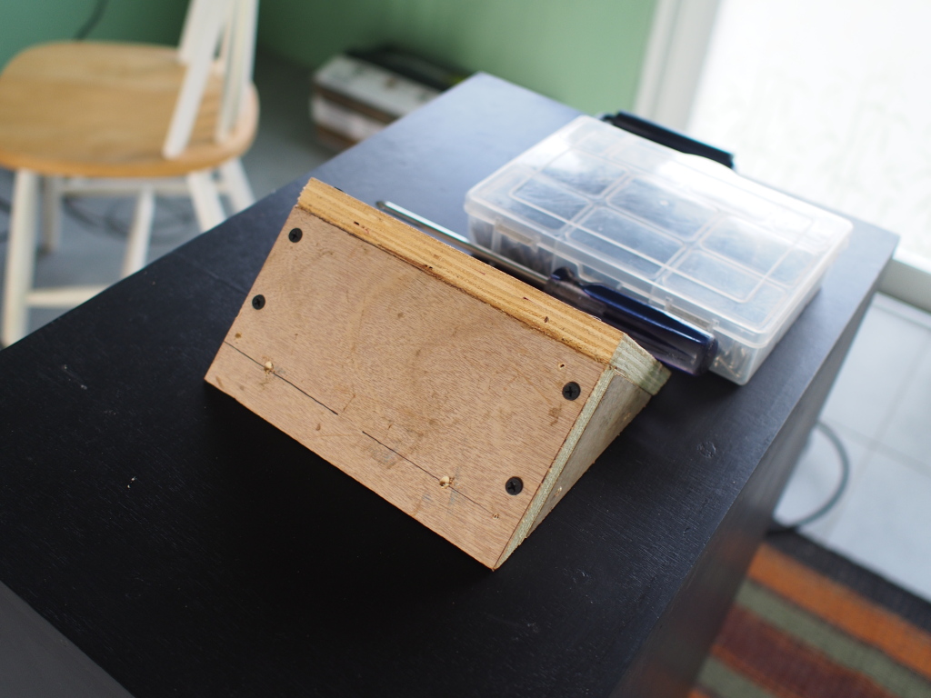

The one way I can think of the grill affecting the response is when it serves to properly brace the mouth of the horn, reducing the tendency of the sides of the mouth to flex. In a properly-braced horn, the impact will be very minor, but if it's not braced properly in the first place...
If I was measuring the impact of a grill, I'd be piling sandbags or something else heavy on top the horn to eliminate any flexing (or lack thereof) from impacting the measurements. But that's just me...
It measured worse!

As long as the crosssection in front of the driver is constant then vtc should be correct.
