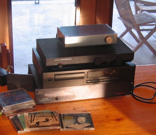

Ok, the preamp is up and running.
I measured the ma with shorted inputs and it was zero or 0.01mv, so given that Russ reckons the -ve rail will behave under load, I closed the case and connected it to the system.
I've had a listen, and I can state categorically that the FreeBird blows my Musical Fidelity amp to the weeds. The sound is both more open and detailed. My MF PreAmp is by no means their best, and it must be nearly 20 years old, but it's not a bad thing to beat either 🙂
Turn on is noisy if the poweramp is already running. anything I can do about that?
I'll try and give a critical opinion after work tonight.
Piccy attached of the FreeBird reigning over the test system...
Michael

FreeBird Construction and Listening impressions.
This preamp was completed this morning at around 8AM. It's been running continuously since. I don't know if these units will break-in, but it certainly isn't sounding worse each time I enter the room it's in!
Component selections and construction.
The parts used were basic items purchased mostly at Jaycar and futurlec. I've discovered Altronics locally, who seem to stock a greater variety of electronic stuff in some areas than Jaycar, and some parts came from them, including the case.
I used normal hookup wire for signal wiring, most of it Jaycar 13x0.12 cat# WH3000. I am sure there is better OFC etc wire to be had, and this stuff is light, and seems to harden and become brittle after soldering, I'd search for something better next time. If anyone has any favorites, I'd be happy to hear about them.
Mains wiring is all 240V or better rated. Not worth mucking around here. The transformer is a Jaycar MT2086 15-0-15v toroid. Fuse is 500ma slowblow. I have not yet installed a front panel led.
Russ kindly supplied the low-esr caps. I sourced the OPA627's via ebay at something like 80% discount off local prices.
If I was doing the construction again, things I'd change would be: Assemble in the box, not the plate. Use better/different signal wire. not much else.
I should mention that many of the tasks carried out over the last week or so to finish this project were shared by my son Hugh, who has high functioning autism. Some people might die of shock to hear that, but experience has taught us to follow his interests, and electronics is one of them. As soon as I open a package with components or PCBs these days, he tries to take over. There is no slacking on my projects, I'm not allowed to!
Listening Impressions:
I inserted the preamp into my 'test' system comprised of bit 'n pieces of cast off or excess gear that any hifi buff will have lying around:
I have a bit of Musical Fidelity gear that I either bought new on close-out, or from ebay, and some of it is in the test setup:
MF The Preamp 3a, MF P170 PowerAmp. The P170 was bought recently on ebay, and arrived in working order, but with a nasty PCB burn that I decided to fix myself. There's a thread in the solid state forum about it. It has upgraded (LM318 to OPA627) opamps, and new capacitors (almost) throughout.
Rotel 965BX CD player, and Tannoy 603 bookshelf speakers. (you may remember these by their 6-sided case construction) All good, dated but not great components.
The test system has been assembled and running for over a month since the arrival of the P170. We're familiar with how it sounds (respectable) there is one last job on the P170 which is replacement of the largish 20,000uf PS Caps.
Room is a large, bright kitchen/dine. No carpet, lots of wood and glass. The system sits on a 6' x 3' pine table. (The Dining table, actually) 😀
Enough rambling about the gear. Once the preamp was tested as behaving, I shut down the 3a, and inserted the new preamp:
Initial impressions: Wow. This is a lot more open and detailed. I swapped a few CD's, couldn't find anything that I could call a downgrade, everything was improved!
So what has changed? I'm hearing a lot more detailed and focussed soundstage. Instruments have been given more life. Bass is more defined and controlled, even though it is certainly lacking in these speakers, it's a lot better than it was. A good example of the difference is on Cohen's 'ten recent songs' Those of you familiar with this recording will know that there is a lot of bass in it, and previously, the CD was enjoyable, but there was a lot of mud down in the bass region that veiled the individual instruments both in their location and detail. No more. Leonard is now placable as is each of the instruments. I should dig out my Christy Moore 'Smoke and Strong Whisky', there is a very bass-heavy and awesome track on there called 'Burning Times' which will probably gain extra punch here. Well recorded female vocals are standout (they were great previously, but the extra soundstaging is welcome) Gillian Welch 'Soul Journey' visits to sing, mostly she stands just to the left of the right speaker. Great voice and delivery, well accompanied, and great recording made better by this terrific little preamp!
So, my first completed DIY Audio project is a success! I'm thrilled with the sound, and very happy with the whole result. I'd like to thank everyone, especially Russ for creating the preamp in the first place, being patient with my newbie questions, and even sending the board off to the other side of the planet in the hope that I would actually get them going. Pre dinner drinks are on, I'm off to do some more listening!
