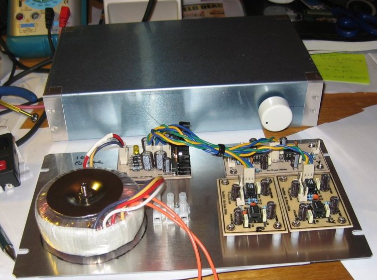

Actually, this case is good.
Next time, I will construct the amp in the box, and fabricate my own heavier top and front rather than fight with constructing it on the base and having to leave enough spare wire to open and close it.
There is a larger size, 305 x 203 x 76mm Hammond cat 1444-24, that will be my next stereo chipamp case. Compared to constructing from scratch like I have with my Mauro, it's a lot cheaper and less hassle.
I guess you have to build a few of these to decide what works and what's the hard way of doing things.
Michael

Powersupply output voltage
Russ, I'm getting -13.5 +12.1 on the PS outputs.
Is that a problem?
At least it didn't blow 😀
Michael

It is probably not a problem, but it could mean that your negative regulator(7912) is shot... It should still work, but I am wondering if you have a short of something... They should be very close, mine is exactly 12.1 and 12.1. Odd...

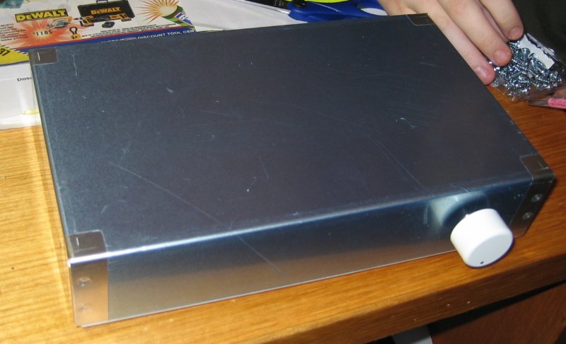

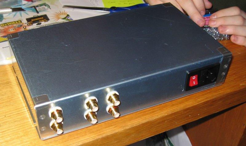

I think it's finished...
Ok. Before I connect it to source/amp, what should I check, and how should I check it?
Should I worry about the longer earth cable here drooping over the tranny when the case closes? (thinking about shorted turn)
Here is the case being closed...

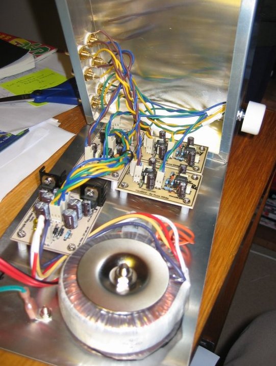

Voltages
V+ to 0 = 11.96v (fluctuates 11.96 to 11.97)
V- to 0 = 14.12v (similar fluctuation range)
I'll pull the board out and look for shorts...

Well V+ looks great, I would concentrate on the V- Side.
Also, if you don't find a short and you have another 7912 on hand I would simply replace it.

Could it be the LED? I just used one that was lying around. It works, but it isn't bright...
Safe to remove it and run without one for the moment?
maf_au said:Could it be the LED? I just used one that was lying around. It works, but it isn't bright...
It should not cause that, but yes you can omit it.
I may have to retire defeated...
I've checked and scored any close tracks, but they all seem clear. Removed the LED, resolderd anything that looks suspect, but no change.
No test I can do on the 7912 itself?

Well, the amps will run fine with the voltages you are getting out, so you could go ahead with your testing, but I would get a new 7912 when you can.
As far of testing the 7912 itself the testing you are doing now is basically the same as you would do in any case. 🙂
