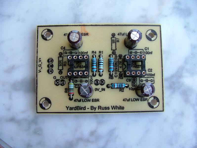

As you can see I'm not very far with the boards. The 100nf cap's I have are all with a pitch of 7,5mm. I ordered them together with some resistors that I also was missing. I hope I will have them before the weekend.
Regards

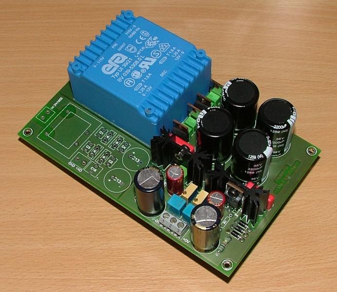

Back to topic: just two more resistors and the power supply is finished.
Regards

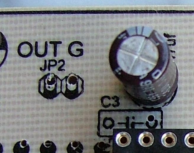

Soldering...
My soldering is not as good on these boards as it is on a production board, and I'm wondering if there is any special technique I should be using. I found I had a lot of problem getting any solder adhesion to the pcb at all. In the end, I gave the solder pads a light rub with 400 grade sandpaper and things improved. Are they coated with something, or could they have corroded in transit or something?
I'll have a look in my dremel kit, maybe there is something finer than sandpaper to hit those pads with...
I'm using a temp controlled, fine-tip (about 1mm) 48 watt iron, set at 300c, and flux-cored 60/40 0.7mm solder. It's usually a breeze.
Michael
Michael
The PCBs will be fairly cheap, I am aiming for $7-$8.00US each(freebird) and probably around $5.00 each ($10.00 a set) for the yardbirds.
I will get a more firm price after I send the gerbers to the manufacturer.
As far as kit prices, I will have to get back to you on that as I have not yet worked up the spreadsheet.
I will likely offer two versions of the kits, one with the opa627s(and buf634s in the case of the yardbird) and one without chips, since the chips are a significant part of the cost, and some folks already have some.
Cheers!
Russ
Cheers!
Russ
The boards were sprayed with laquer to protect the copper from oxydizing.maf_au said:Soldering...
Michael
The laquer actually also forms a sort of a universal solder mask. The trick is to let the iron tip heat the copper pretty well before you apply the solder, because otherwise the solder will flow before the copper is really ready to stick to it. It takes a little practice. Once you get used to it it works really well, and keeps the solder from flowing out of control
Sanding it off won't hurt, but you may want to re-laquer it when you are done to protect the thing from the oxygen.
Cheers!
Russ

Russ White said:I will fix the component side silk screen too...
Yes please 🙂
It's a bit hard to guess which resistor goes where, the resistor numbers and values are printed on top of each other.
Reading left to right, I think I make it:
1K
100K
10 ohm
1 ohm
4.7K
OPA627
20pf
20pf
OPA627
4.7K
1K
10 ohm
100K
1 ohm
Is that right?
R3 and R4 are to be transposed on the board, but which are they?
Thanks,
Michael
maf_au said:
Yes please 🙂
Michael
Hi michael, I screwed up when I first laid out the component side, that is why it turned outlike that. I apologize for the confusion.. The production boards will not have that issue. 😀
Use the following values:
R1 4.7K R-EU_0207/10 0207/10 rcl 1
R2 1K R-EU_0207/10 0207/10 rcl 1
R3 100K R-EU_0207/10 0207/10 rcl 1
R4 1K R-EU_0207/10 0207/10 rcl 1
R5 10R R-EU_0207/10 0207/10 rcl 1
R6 1R R-EU_0207/10 0207/10 rcl 1
R7 1K R-EU_0207/10 0207/10 rcl 1
R8 1K R-EU_0207/10 0207/10 rcl 1
R9 100K R-EU_0207/10 0207/10 rcl 1
R10 10R R-EU_0207/10 0207/10 rcl 1
R11 4.7K R-EU_0207/10 0207/10 rcl 1
R12 1R R-EU_0207/10 0207/10 rcl 1
And use the image from post #3 to guide you. 😀
R3 and R4 are correct on the board(and on the image I refer to) they were just not correct in my initial old BOM.
The BOM on post #101 is correct if you need the cap values.
Cheers!
