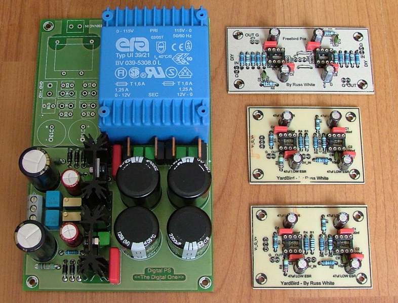

All the boards are finished!🙂
Next step is to give them a decent home. Didn't found anything useful up to now. Is it a wise idea to put some cap's on the outputs to block out any DC? To attenuate the volume I only have a blue 100K Alps stereo pot and two mono cermet 50K Bourns potmeters at hand. I guess the 50K's are preferred here or should I go even to a lower value?

As long as there is no DC on the input there will be none(or next to none) on output. If you think you might have a source with DC, I would put a ~2.2uf cap directly after your 100K alps pot. I have had better success with 10K stero pots, but the 100K should work fine. I really like the little 9mm 10K stereo pots Jaycar sells.
You could put a cap on output if you like, but you should not need to. I would just check for DC on the output when you power it up connected to your source, but not your power amp.
Cheers!
Russ
PS, I hope you get a chance to hear it soon!!! 🙂

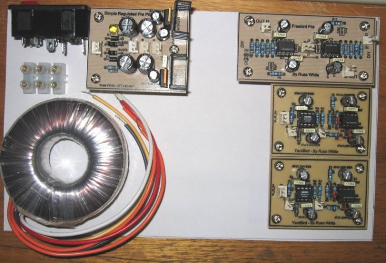

maf_au said:Mine are finished apart from a couple of 10pf ceramics and a couple of 2pin headers.
Here they are overlaid on a piece of paper the size of the box I have selected.
With a bit of wiring and mucking around, should be going in a day or so...

Yardbirds are full house, I thought the 10pf on the freebird sounded like a good idea, already decided to omit the 20pf C5/C11.
With my tranny, I have dual secondaries. How should I connect that to the 3 input pins on the PS? It's a Jaycar MT2086 15-0 0-15v
According to the scpec sheet on Jaycar's site for that trafo, you would join the red and white leads (4 and 5) so that the two secondaries are in series, you then would run a tap wire where you joined those two wires, that is your center tap now, and will be your GND. The two remaining secondary leads (3 and 6, yellow, and purple) are your AC1 and AC2.
That trafo should work out very well.
Cheers!
Russ

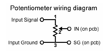

Potentiometer wiring.
My pot is the jaycar 9mm mini device 10k log.
Dealing with these tiny pins... I have some veroboard to make it a bit easier.
According to the BrianGT nigc users guide:
- Incoming Signal (centre pin of RCA) goes to pin 1 on the pot
- Pin 2 on the pot goes to signal in on the PCB.
- Signal in ground goes to pin 3 on the pot and from there to Sig Ground on the PCB.[/list=1]
Assuming pins are numbered left to right when viewing the pot from the knob end with the pins pointing upward...
Diagram from the nigc users guide attached.

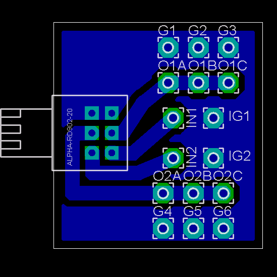

maf_au said:Never mind, I just found Russ's PCB for that pot, which explains everything - I had it backwards...
Jaycar should sell those boards as an accessory...
The illuminating circuit board reveals all:
Hi Michael,
Just remember that the picture you see there is from the top, so the pins are pointed down. 🙂
Cheers!
Russ
Russ White said:
Hi Michael,
Cheers!
Russ
Oh...
So I was right the first time? Bugger!
I think I better buy some of those boards off you next time we do business.. 🙂
Michael
Yep viewing the pot with the pins up and the knob end toward you starting from left to right
pin 1 Signal
pin 2 OUT
pin 3 Signal Ground
Sorry if I answered you too late. Just ate my breakfast a little while ago. 😀
Cheers!
Russ
