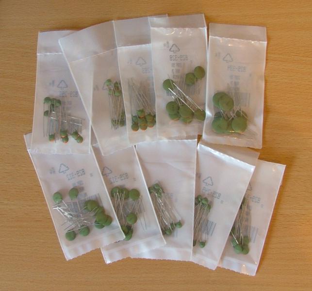

I bought some ceramic disc cap's in different values for RF filtering purposes, think they will do the job. Now I have to search through my resistor department to see what I need to order extra to finish them of.

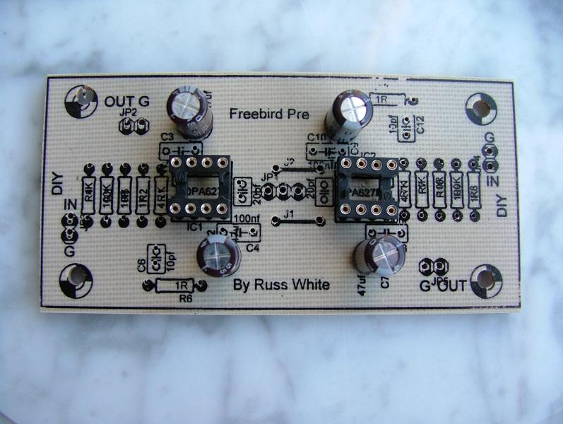

Maybe a dumb question Russ, but I'll ask it anyway. Can I safely use the image in post #3 and the components list in post #23 to populate the board. I'm asking this because the printing on the component side is a bit unclear for some of the parts.
Regards
Regards
Not a dumb question...
Actually it appears I transposed two resistor values..
R3 1K R-EU_0207/10 0207/10 rcl 1
R4 100K R-EU_0207/10 0207/10 rcl 1
Should be
R3 100K R-EU_0207/10 0207/10 rcl 1
R4 1K R-EU_0207/10 0207/10 rcl 1
Otherwise that part list looks correct.
I will submit the corrected partslist when I get home from work.
Thanks for making look at that! 🙂
I will fix the component side silk screen too...
Cheers!
Russ
