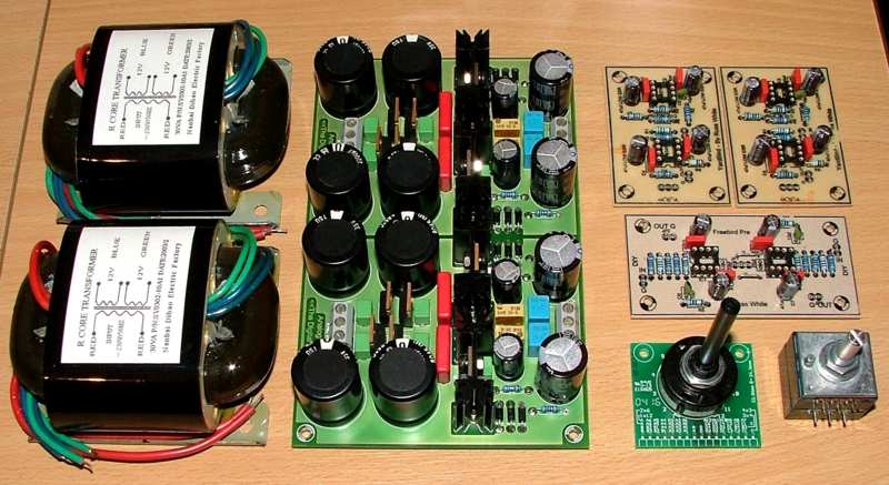

GeWa said:OK, here are the parts so far. Only problem left is to find a deicent housing to put it al in. The power supply is dual so the Freebird and the Yardbirds will have there own separate PS. Maybe a bit over the top but who cares.😀

Hey that is looking very good GeWa! 🙂
I really dig those transformers, what type are they? Who makes them?
Enjoy the belgian beer. 😀

The label says: Nanhai Dibao Electric Factory.
I got them from HiFituning in germany.
http://www.hifituning.com/html/r-core_trafos.html

About to get these made.
OK, I think the freebird is well tested, and ready to rock. So Here is how it looks right now. Let me know if you see anything I should change before I get some of these made for sale. 🙂

Joined 2003
The only problem I found when assembling the Freebird as well as the power supply is that the electolytic capacitors are VERY close together and I had a hard time getting them flush to the board. An extra 0.5mm-1mm clearance is probably all they need.
DcibeL said:The only problem I found when assembling the Freebird as well as the power supply is that the electolytic capacitors are VERY close together
Ah thank you! Exactly the kind of input I was looking for. Are you talking about the PS caps? It is the only board that has electrolytics close to each other.
I didn't have that problem, but some of my caps don't sit flat anyway - I think it was the caps having non-flat bases more than tight spacing. Some small EL Caps seem to have a rubber protusion at the base...

Joined 2003
On the Freebird the EL caps sit very close to the 100nF caps where there is plenty of room to space them out a little more. Looking at the Yardbird there seems to be just a tad more room between these caps which is all you would need. On the Power supply, the 220uF caps as well as C3 have this problem. It would seem as though the lip at the base of the capacitor sticks out just slightly past the diameter of the cap. I used 50V 220uF caps which may be slightly larger than the size you designed the board for, so these caps may not be a problem for other people. I am sure the regulators don't give off any amount of heat (I haven't powered the board up yet), but perhaps they could be moved closer to the edge of the board to give them a little more breathing room?
Yes, the caps do have a rubber base, but if you press them to the board as you solder them in place they will be flush and quite solidly in place. Sorry if I am being picky here, but soldering is my job, until I am done school that is.
Actually you are doing as I asked. Be very picky please. 🙂
I will move things around a bit. 🙂
The regulators on the PS are placed so that a TO220 heatsink can easily be mounted, but no they don't get even close to hot, even with no HS.
