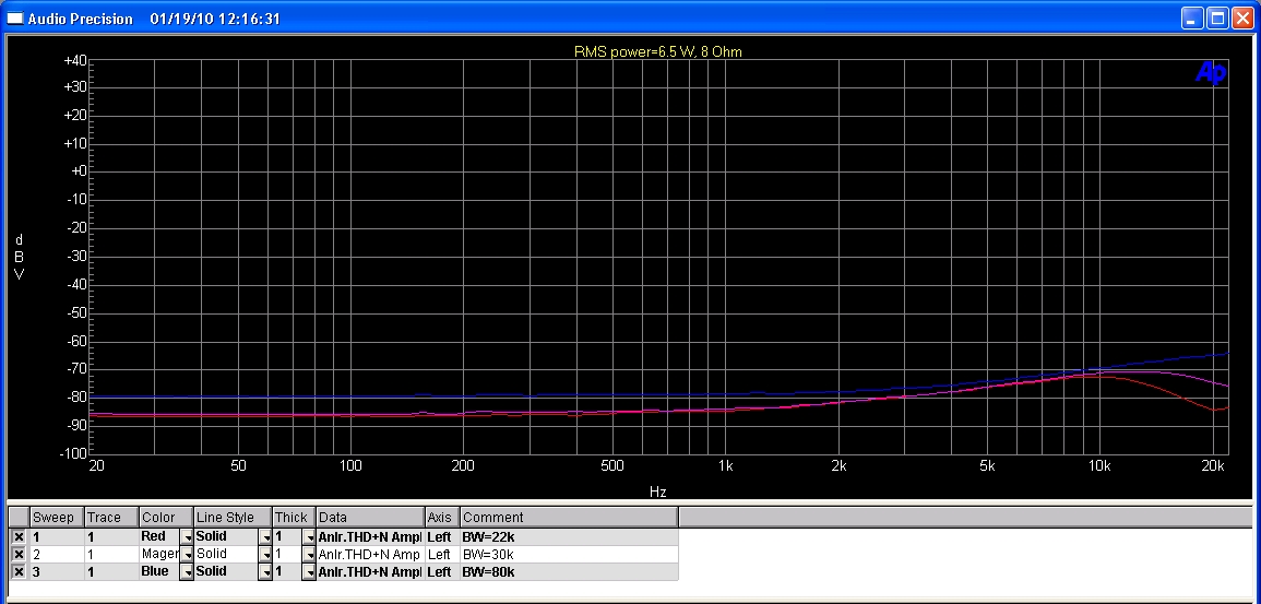

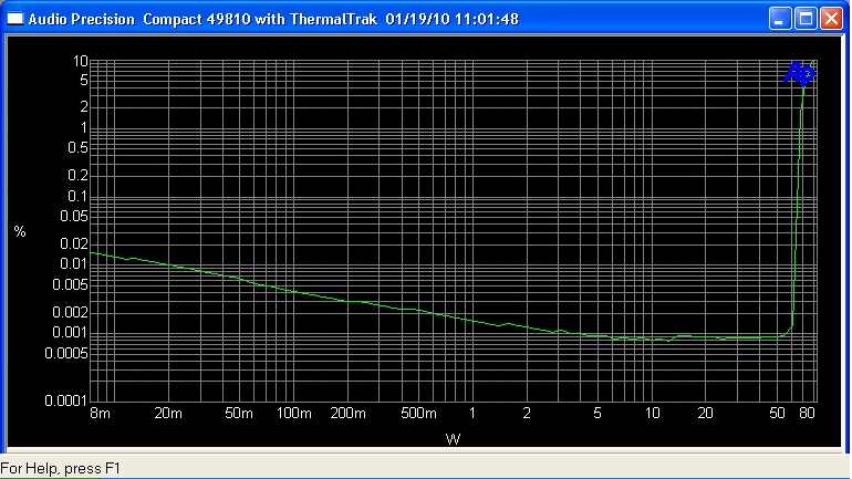

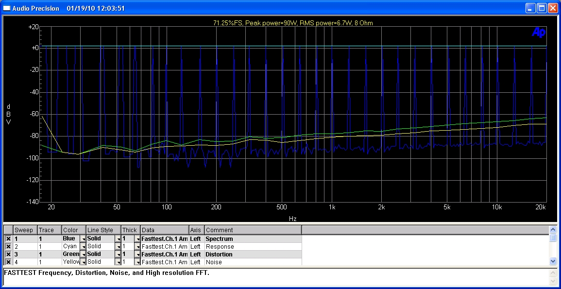

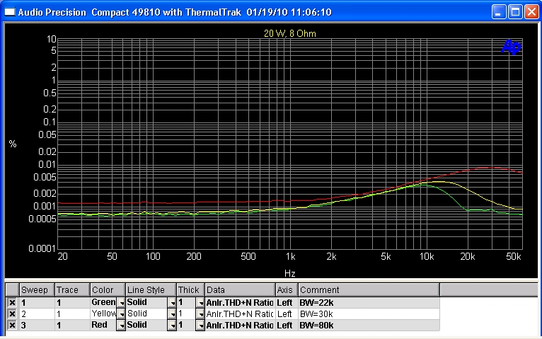

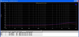

Here are some curves for conventional THD and AP DSP based multitone. The multitone is very fast. It generates all data almost instantly compared to tens of second of sine sweep. I am told that multitone is widely used in production test including the iPods.
Conventional THD vs freq for sine sweep is plotted in dBV scale for ease of comparison with the multitone Distortion measurement.

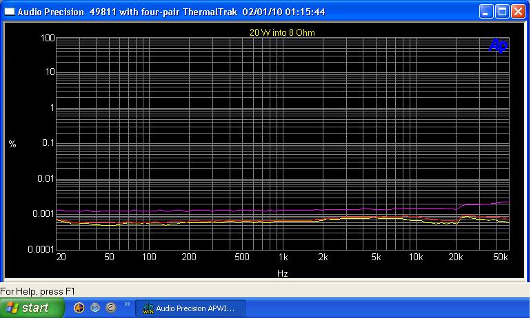

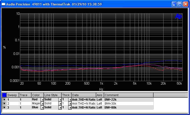

Here is THD vs freq for LME49811 with output stage biased in Class A for 20 W/8 Ohm. THD rise in high freq is almost gone due to vanishing crossover distortion.
The result shown earlier is with two pairs of TT output devices. Here is for four pairs TT. Very promising!!! Better than the earlier result. BW = 22k, 30k 80k from bottom to top.
