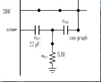

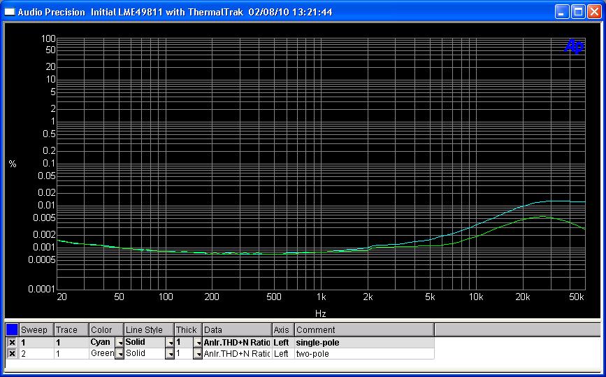

Two-pole compensation
I implemented two-pole compensation to a LME49811 with ThermalTrak amp. The high-frequency distortion is reduced. Here is an example: 123W into 8 Ohm load. The result is very promising.
Cc1 = 22pF (single-pole cap)
Cc2 = 44 pF
Rc1 = 5.6 k
Cc2 = 44 pF
Rc1 = 5.6 k
Yea, that's good result.
Now, if you have time, please try Cc2 100pF, unsolder the Rc1 resistor and solder a 1k8 resistor between capacitors and the output with a wire, just like I have shown in my previous posts. The THD results should be similar but the impulse response should be the same as with the standard miller compensation. With two-pole compensation you have overshoot.

Dear Panson,
Such a distortion rise in the higher frequencies are sometimes suspective. Are you really sure that somewhere high in the MHz. range there isn't any oscillation?
I end up with this scheme, after advice from the National designer on this forum, and it killed the Mhz. range oscillation.
With kind regards,
Bas

The THD diagram looks quite normal to me 😉
And that is not a two pole compensation.
It isn't a two pole. I wanted to point this out, because I experienced myself oscillation's far away, which wasn't visible or noticeable on first sight. This compensation scheme solved it.
Btw. My example shows one error, the cap should be connected to the sink pin instead of the source 😉

Hi Bas,
No sign of oscillation when tested with 8Ohm and 4Ohm resistive load. The output was monitored by a 500 MHz scope. I will make more test including square wave after Chinese New Year.
Panson
