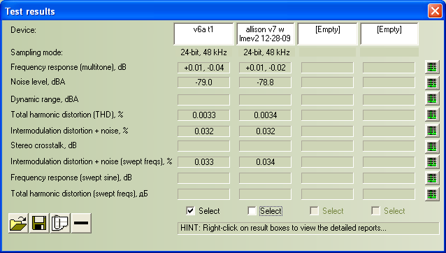

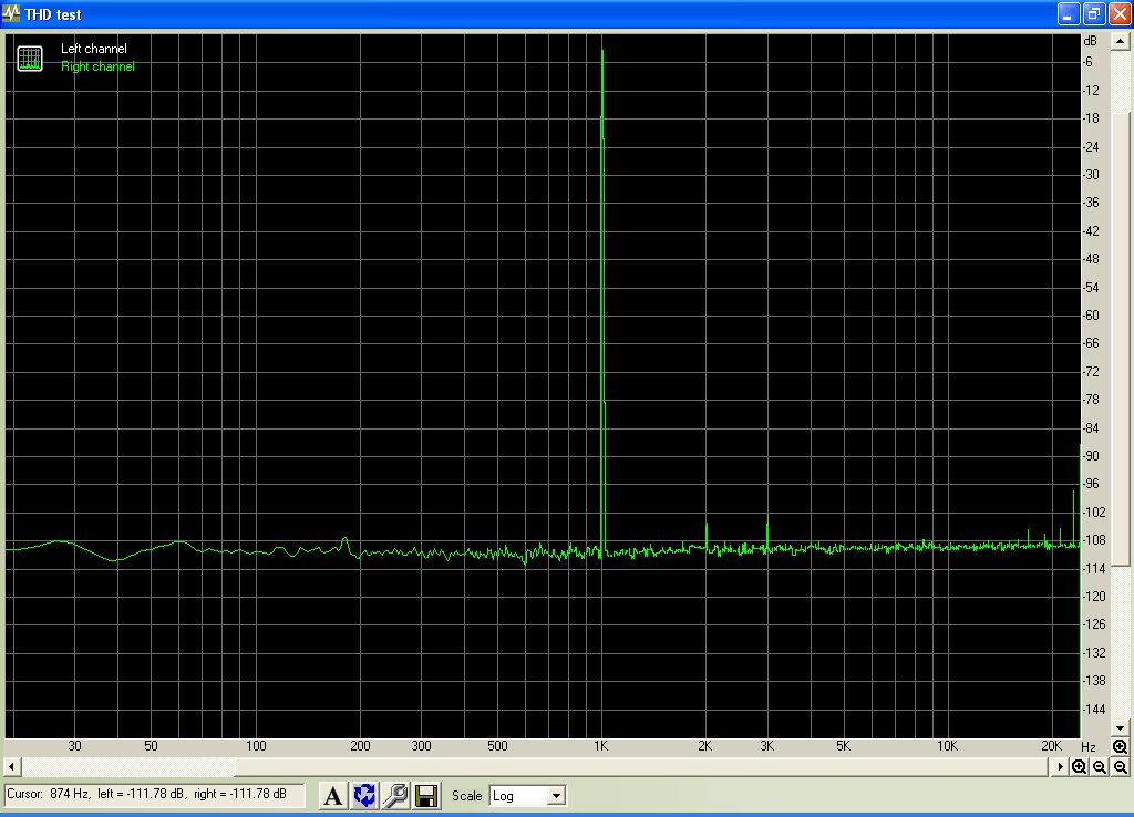

I thought you guys might enjoy my latest LME49811 with Allison class A/B output - the device stays in class A to about 10watts or so. (It's actually adjustable). My LME49811 driver board measures at .0035 Thd. my V6a allison measures .0033. It's driven with the sink/source of the LME, the version V7 combines the sink source and drives between the allison emitters and uses bootstrap current supply. More info can be found in the Simulation of Unique Allison thread in the Solid State Forum.
These are lower power measurements. I'm waiting for a new sound card to preform the high power tests.
Ken L
Ken L
