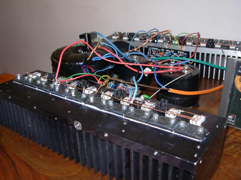

I haven't yet shown here my last lme implementation.
How much power per channel?
I think about 750w/4 capable with 90 volts rails.
Tested at 63 volts for now.
2x 47000uf
High damping factor.
Incredible bass slam.
2x 47000uf

What output devices are you using?
I am using lme49810
5 pairs 2sa1295/2sc3264 driven by 2sa1294/2sc2363 such as in the Rotel RB1090.(+ one pair)
