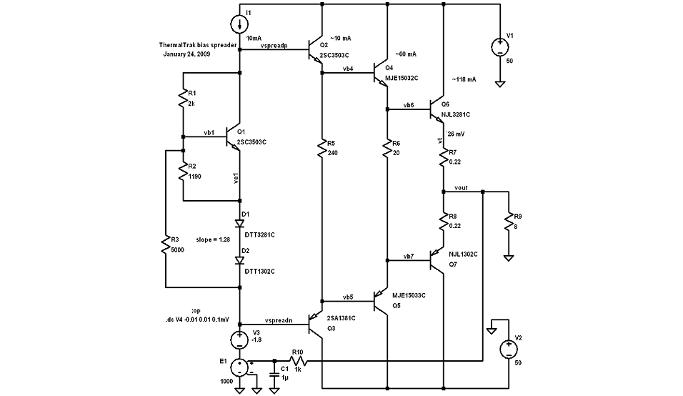

Or you can do this.
D1 and D2 are the Thermal Trak diodes. Adjust R2 and R3 to get correct slope of temp comp. R1 is a pot to adjust bais voltage.
Ken L

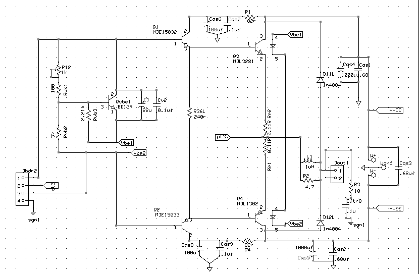

My best results so far. This is using Cordell's bias scheme. I've attached the schematic. I measure the basis with the input signal ground connected, the input open and an 8 ohm load attached. I get 26mv across Re's and 1.226v across the bases of Q3/Q4. I tried running a RMAA test while monitoring the DC voltage across the bases of Q3/Q4 as the signal amplitude went up and down during the test, the voltage declined slightly and then returned within one or two seconds after the amplitude dropped off.

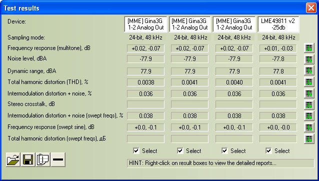

Also attached is the results page. All are measured with an 8 ohm load attached (hopefully I won't make that mistake again) The first three tests from left to right are of the output board as shown in the schematic. They were made in succession each one started soon after the prior finished. The last test is of the LME49811 alone with the source, sink and feed back tied together as shown in the data sheet.

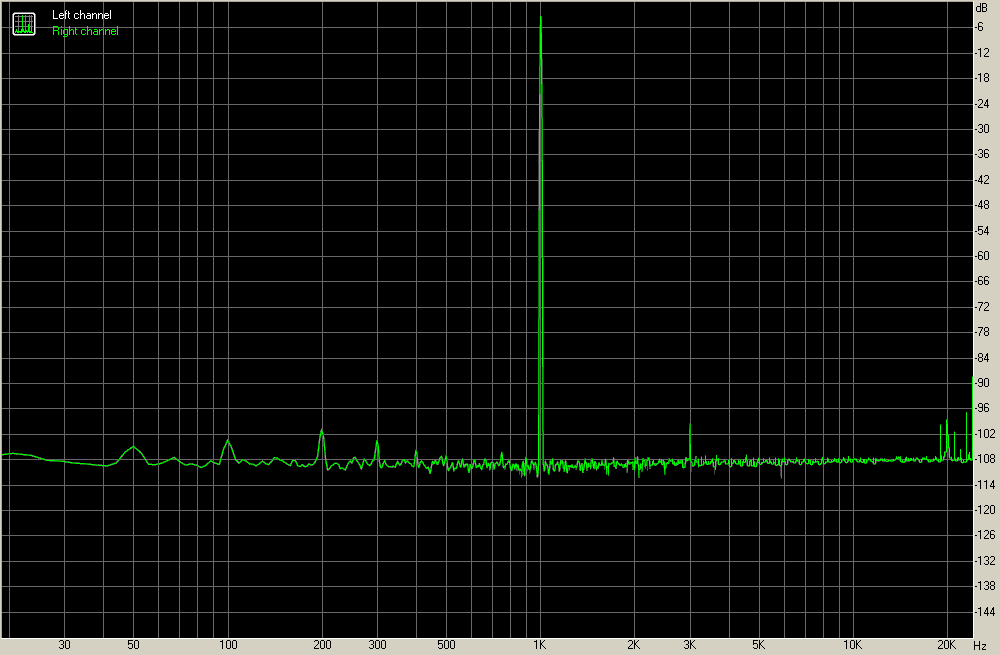

The last image is the THD spectrum from the test on the far left.
Have you looked at the square wave of the LME49811 alone? Mine has some overshoot, not a spike, more of a peaked hump. I tried it with no load and 1k load on the sink and source. Same result.
Ken
Very clean!!!

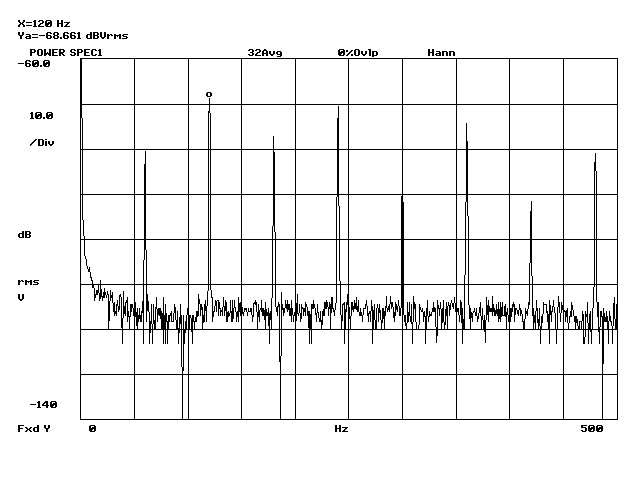

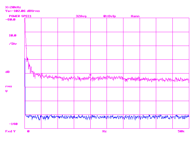

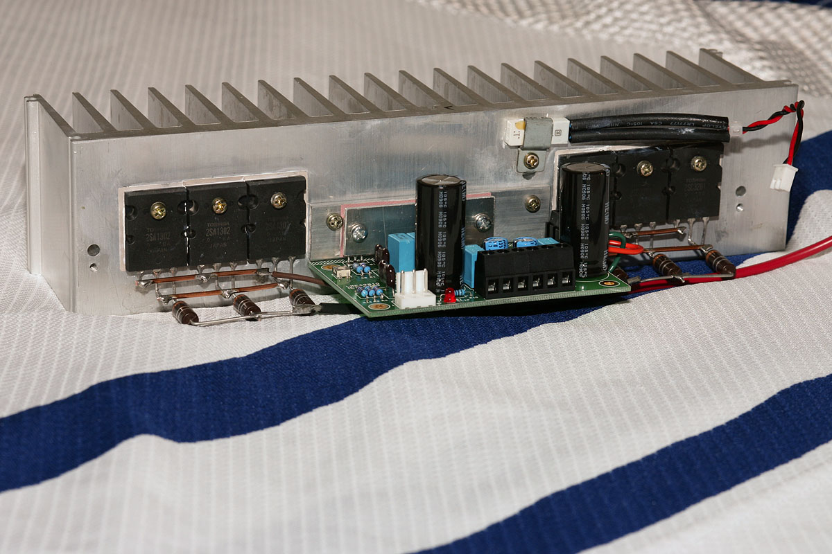

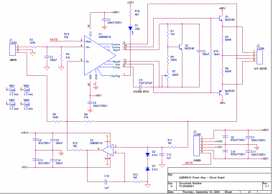

Now for the test results and schematics. On the wide-band noise plot, the magenta trace is the amplifier noise floor in dBV with the amp input terminated in 50 ohm, the blue trace is the noise floor of the analyzer (terminated with 50 ohm). The second noise plot shows 0-500 Hz - notice the ripple. This is with the power for the output stage filtered with a pair of 2SC3281/2SA1302 rigged as capacitance multipliers with 1k, 1000 uF on the base. The cap multipliers had negligible impact on the amount of ripple feed-through.
I have these issues on both channels. I have, of course, tried running one channel only and breaking as many grounds in the un-used channel as I could get away with. Still... No dice.
~Tom

Neurochrome.com
Joined 2009
Oh... Ripple. I have about 100 mVRMS of ripple on the supplies for the LME49810. The supplies for the output stage has had its ripple reduced to 3 mVRMS by the cap multiplier.
One channel has slightly higher ripple than the other due to a difference in the bias current in the output stage. The channel with the highest ripple shows the highest ripple components on the output.
~Tom
The noise floor in above plot is actually that of your AP system 1. The reference is 80 W into 8 ohms (0 dB = 25 VRMS). What I'm after is the noise floor with no input signal and 0 dB = 1 VRMS. Units in V/rt(Hz) if possible, but plain dBV would be just as meaningful.
~Tom
No this is noise floor of the DUT - compact 49810 with thermltrak, though the scale is not dBV.
