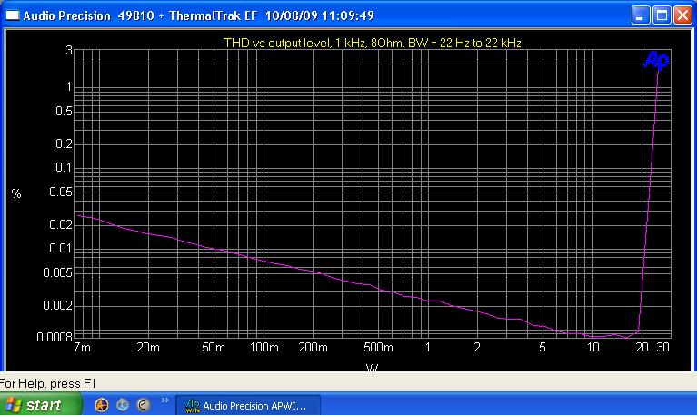

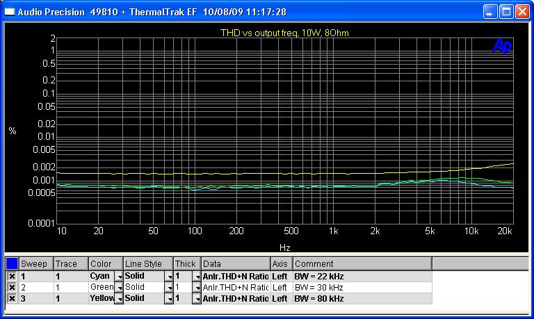

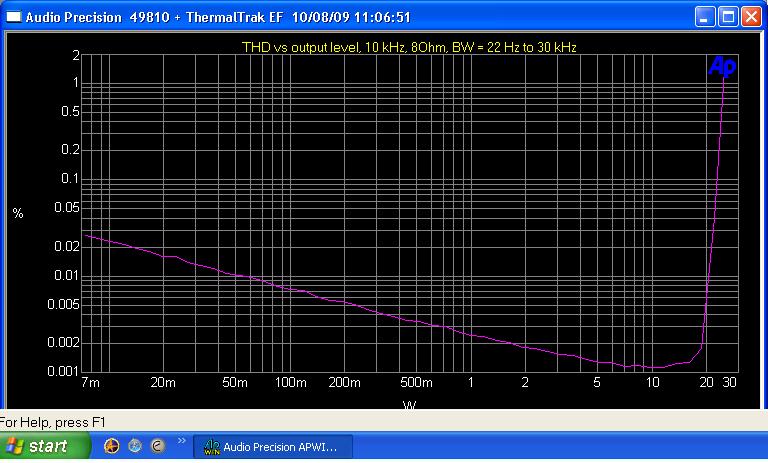

I use bias the EF output stage in Class-A for up to 18 W/8 Ohm (49810+MJE15031/30+ThermalTrak). The DC rail is +/- 24V. The performance is very very good!!! Here are some curves. This is a nice (affordable) 10 W Class-A amp!

20W or 10W
bias to 1.2A @ +-24Vdc giving ~ 60W dissipation results in a 20W into 8ohm ClassA amplifier.
10 W aims for best performance. Another 10 W is the headroom. An over spec design.😀

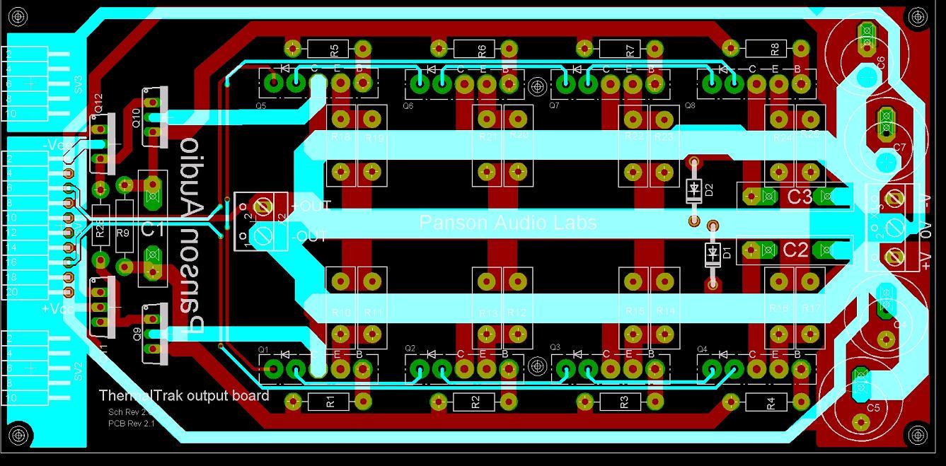

Yes, the new boards will be added to my website. For the ThermalTrak diodes, I will do some tests (for 3-pair, 4-pair) and present the results.
