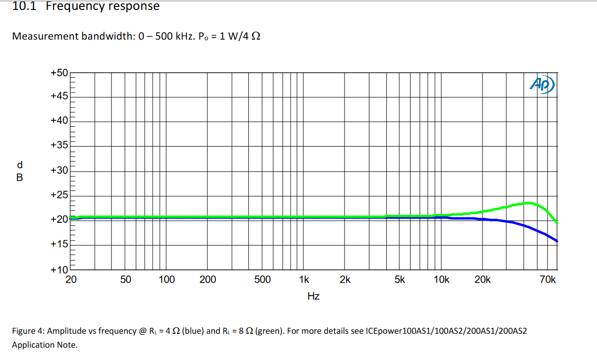

I wonder how the ICEpower amps would react in this situation? The ICEpower 100AS2 is a 2 channel 100W/Ch amp board with built in power supply. It seems ideal for this application, and it is priced at about $140.

From the images in the datasheet for this amplifier, it appears that its low-pass filter (LPF) is not covered by feedback.I wonder how the ICEpower amps would react in this situation? The ICEpower 100AS2 is a 2 channel 100W/Ch amp board with built in power supply. It seems ideal for this application, and it is priced at about $140.
In general, this amplifier is relatively old, and as I understand it, there are many replicas that sometimes have worse characteristics than those stated by the manufacturer. It's necessary to verify the purchased amplifier to ensure it meets the declared specifications. As of today, I consider amplifiers based on the TPA3255 chip to be the most optimal solution. If control over the low-pass filter (LPF) is needed, then it's advisable to look for an amplifier based on TPA3255 where a so-called PFFB (Post Filter Feedback) is implemented. However, this is purely my opinion, and in each specific case, the choice should be made based on the set goals and requirements.
In reality, the rise in the frequency response (HF boost) of a Class D amplifier can be relatively easily addressed by introducing an RC circuit between the amplifier and the speakers. However, I suspect that the issue of poor sound quality you are experiencing is not necessarily due to the amplifier's frequency response boost, but rather in the level of nonlinear distortions at frequencies of 3 kHz and above. This is precisely the key problem with simple low-pass filters (LPFs) at the output of Class D amplifiers. If you were to measure the nonlinear distortions of those amplifiers, I believe you would find answers to why they sound unpleasant in the high frequencies.I find the issue to be so obnoxious that I stopped using those little amps and even recommending them to people. I've shared my own results before and the issue has made some speakers just totally unlistenable, the worst being a 10db rise from 6k to 15k. Id like to get something class ab as I can't afford the good class d like hypex. Audiosource amp100vs looks good but idk if it's class d or not. I've only had the previous non-vs model.
