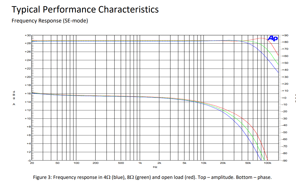

I've been away from my PC and only watched this thread from my phone with out being able to log in and respond. I suspected the low cost class D amplifiers causing the problem. I believe someone already mentioned that the ICE power amps have the same problem, maybe not as severe, not sure if they have some newer models that are more linear or if Parts Express sells them. On the other hand I would be OK if they caused a roll off on the the high end, I would voice my speakers that way anyhow.Thanks for the explanation. It is very helpful.
I wonder how the ICEpower amps would react in this situation? The ICEpower 100AS2 is a 2 channel 100W/Ch amp board with built in power supply. It seems ideal for this application, and it is priced at about $140.

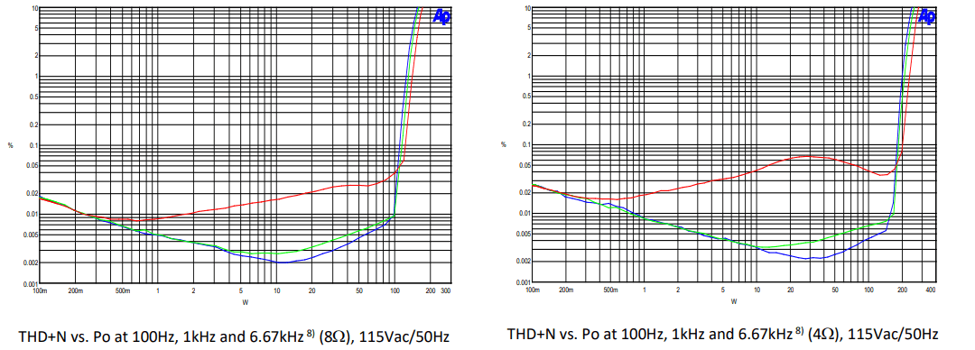

I just checked Parts Express, they do have the new model Ice Power amplifiers and the specs of the ICEpower 250ASX2 looks like it has solved the problem, but it isn't cheap. Distortion looks good if you stay under 100W.
I looked closer and the ICEpower 125ASX2 will save some money if you can stay under 60W @ 8 ohm or 110W at 4 ohm.
I mentioned the class D amps offered by @Erica.C to @hifijim before. Eric just confirmed:
Eric's test data shows about a 0.7 dB rise at 20 kHz (~0.25+ dB @10kHz) at both 4 & 8 ohms. Distortion before clipping is typically well <0.1% -- probably an order of magnitude higher than the Hypex, but I don't perceive the difference. Noise is very low, low enough not to be any issue with either Hypex or Eric's amps. For the $, they are amazingly good. The only feature I'd love to see is an input-sensing power on/off, which is so useful for multi-ch active systems.
I've been using a couple of the FFA001V3 (150w/ch stereo amp module) in my audio lab for a few months wherever needed in various active systems I have going. Not sure that I'd call it "critical listening" but in general I have heard no appreciable difference between these and Hypex NC250MP for bass (up to ~120Hz) and mid (100~1000Hz or 600~6000Hz) amps. Also used as a stereo amp for the passive loudspeakers that come through. Haven't tried it as a treble amp yet.This class D amplifier is a post-filter feedback design, the overall frequency response with minimum independent regarding the load variants.

Given that I have already characterized the frequency response of the amps when connected to my speakers, there is really no reason for me to change amps at this point.
For a person looking to replicate this project, I might recommend a different amp. The @Erica.C amps look like an excellent value. Many people have a collection of older class AB amps laying about, and these are great candidates.
If someone wants to use one of the self-contained class D amps sold on Parts Express (like I did), I would recommend that they confirm they have an acceptable frequency response above 10k. This would be an easy measurement of the final speaker system. They would need a single FR scan on-axis with the tweeter. A simple USB mic would be fine, and the gate window could be as short as 2 ms, which means it could be done in almost any environment. This scan would confirm if any high freqency adjustment is necessary in the DSP filter.
