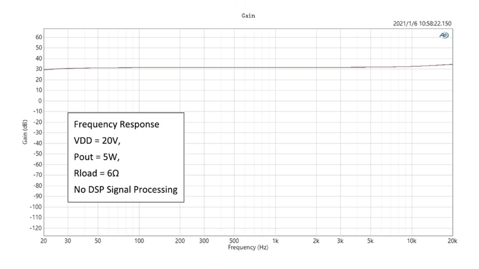

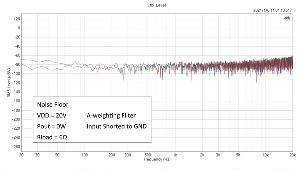

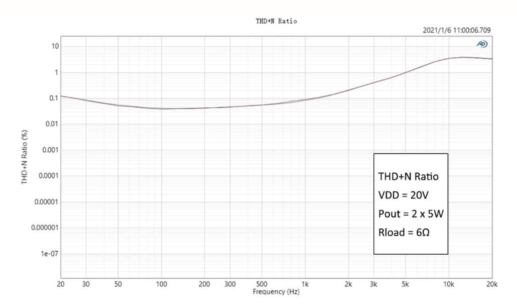

Yesterday I reviewed my Wondom JAB5 equipment. I have two Wondom JAB5 4-ch amp boards with on-board DSP. I have two 36V power supplies. I have two wondom programming boards. I have a variety of connectors and wiring harnesses. All said I have about $210 worth of stuff. Originally I was strongly leaning towards using this as the electronics package for this project. Several factors give me pause.
First is the relatively low performance of the JAB5. Although the distortion is quoted as 0.07% at 1k, it rises rapidly above 1k, and is above 1% at 5k. The noise plot that Sure publishes shows a noise floor of ~ -80 dB at 1k, but rising to -60 dB at 20k. The frequency response is not flat, showing a rise of several dB from 5k to 20k. It is hard to estimate the frequency response because the scale is so compressed.
This low performance means that whatever I learn from working with this Wondom equipment will have little or no value to my future projects. It will have little value to other DIY’ers, who I suspect will prefer electronics with higher performance.

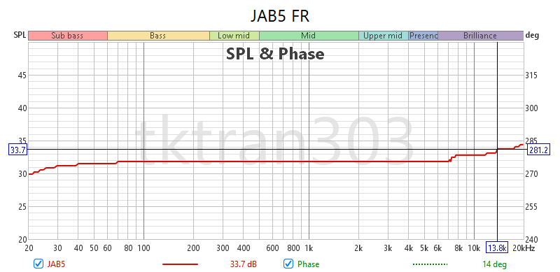

I took the liberty of tracing the FR graph and converting to FRD to analyse it:
Instead of that misleading 190dB vertical scale, I converted it to a 30dB scale, which, as you know, is the difference between 0.1W and 100W:
There's is a 3dB rise at 14KHz. Furthermore, there a 2dB drop at 50Hz.
The 1% THD @5Khz is far higher than what is achievable by current generation commodity Class D amplifier chipsets like the TI TPA3255, which are better by orders of magnitude (<0.03% THD for 5W @5Khz)
Hmph. Yes somewhat underwhelming. It must be using an older generation or lower spec Class D amp. In retrospect the min load impedance of 6 ohm was probably the first clue...

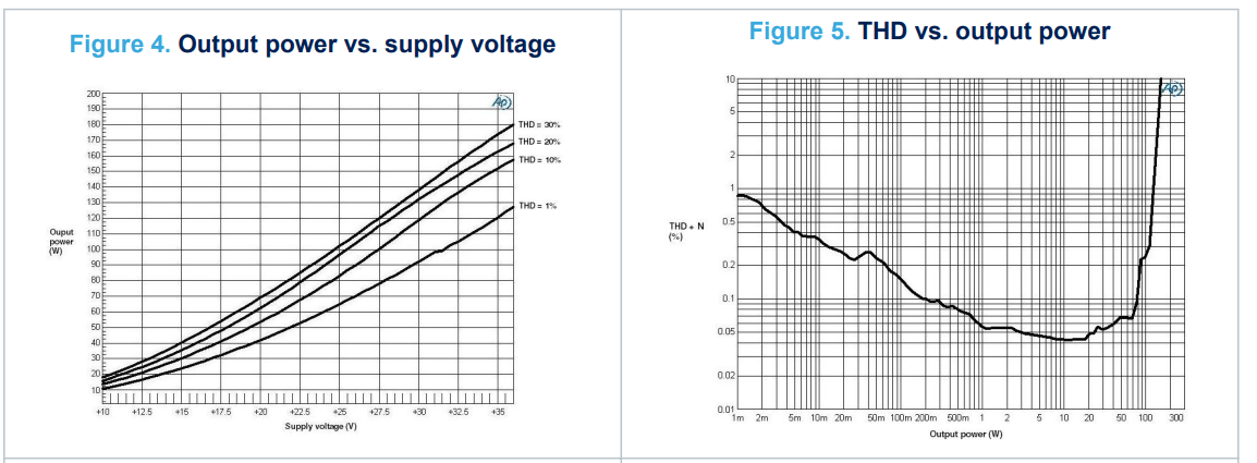

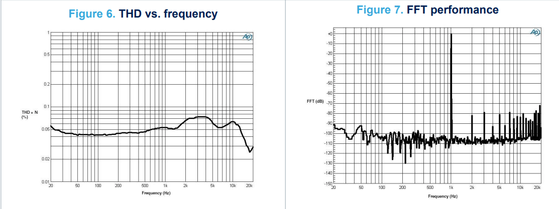

A couple of weeks ago I bought a new amp for testing drivers and speaker prototypes. My old one was rated at 10 W/ch, and when running a large woofer to Xmax it would get hot and sometimes clip.
I bought this new one from Parts Express
https://www.parts-express.com/FX-Au...o-Amplifier-160-WPC-Silver-230-280?quantity=1
It uses the TDA7498E chipset, and is advertised as 160 W/ch. This chipset has good performance:
A more realistic rating would be 120 W/ch into 4 Ohm at 1% THD. Still, $83 for a 120 W/ch amp is very reasonable. I was using it to listen to pair of passive speaker I recently completed, and I thought it sounded really good... by which I mean I could not perceive any difference between it and my reference amp.
So this amp, or one similar, could provide the 2 channels of power I need for each speaker. The amp and its power supply could be mounted on the back of the speaker or located in the speaker stand.
That would put the electronics cost of this project at ~ $520 for the pair.
